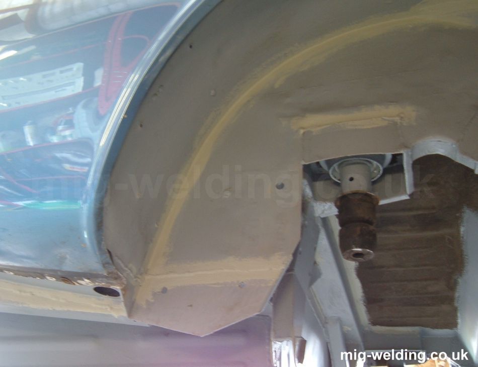

This is the underneath of a front wheel arch prior to painting. Much of the sealant visible in the photo is applied over seam welded repairs (the triangle at the top right and the wiggly line to the top left). There is bound to be the odd pinhole in the weld, and sealing the reverse will prevent water getting through to the paint on the other side of the panel.
The sealant from the top left to bottom right was applied in a big bead like the photo above when fitting the inner wing. The excess smoothed out quite nicely and I hopefully can be confident there is no place for water in that seam.
Any seam or panel joint on the underside of a car will require sealing.

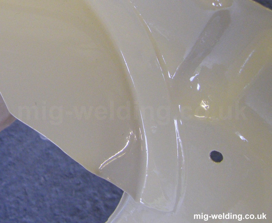

Overpainting
If the sealant has been smoothed using a solvent it should over-paint well. Here's a detail of an inner wing that has been coated with a single coat of primer and two coats of colour.
The sealant (applied as a bead then smoothed out) is only noticeable as an absence of a gap at the end of the spot welded flange.
