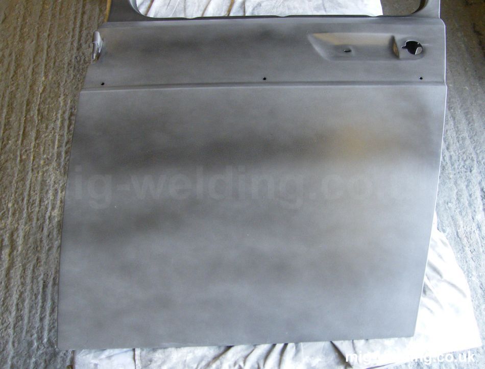

A guide coat is a thin mist of colour applied over high build primer and then wet flatted off. Initial sanding will remove the high points, and it is only when the whole of the guide coat has been removed that the high points of the panel will be level with the low points - then the surface will be completely smooth and ready for top coating.
Guide coat sanding is done immediately before the colour coat. My approach for a guide coat is to mix evenly colour with primer then add at least 75% thinners. The primer content aids sanding and thickens the guide coat so it doesn't disappear before the panel is flat. Using the top coat colour prevents problems with painting over any guide coat that isn't completely sanded off.
Dark guide coat applied to panel

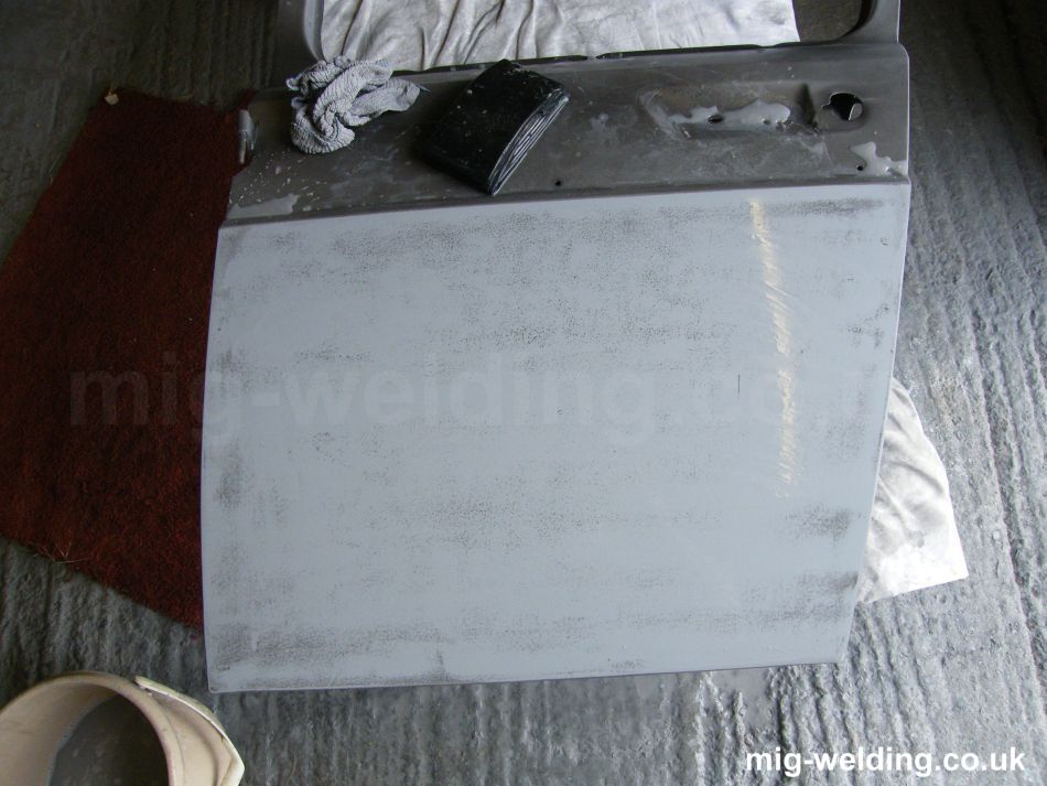

600 grit wet sandpaper is appropriate as a base for the colour coats.
I'm sanding with a sanding block just about visible on the door panel above the part I'm flatting. A sanding block is useful as it doesn't follow local depressions in the panel as much as hand sanding.
The direction of sanding should be changed frequently when block sanding. First along the panel, then up the panel, then 45 degrees, then 45 degrees the other way.
This is a flat panel. For a panel with a sharp single curve I might use the block a little first to reveal the low spots then finish off with hand sanding. For a sharply compound curved panel I'll forget the block and go with hand sanding.
Initial flatting of guide coat
The areas still coated with guide coat after further sanding are the ones I got close but not quite right with body filler.
