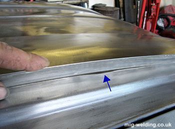

In the photo a 1m steel rule is positioned at an angle on a curved panel allowing it to bend to the shape of the panel and highlight the position of a dent. It has to be a steel rule as they bend nice and evenly. Aluminium ones can kink.
There is a gap between the steel rule and panel where the panel needs filling. I tend to pencil a line on the panel around the edge of the gap to show where I need to apply the filler.
Using ruler to find dents

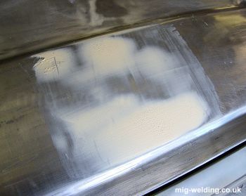

The filler goes on in the normal way using a plastic scraper to plaster filler in the area I've marked out. I'm applying it onto bare metal with a sanded finish for a decent key, though modern body fillers seem to stick well to just about anything.
Filling on top of paint is problematic - paint sprayed on top will sink into the filler a different amount from the surrounding paint as it cures, and you end up with lines in the paint around the filler. With cellulose paint these lines can keep appearing a week or two after painting as the paint cures.
Filler applied

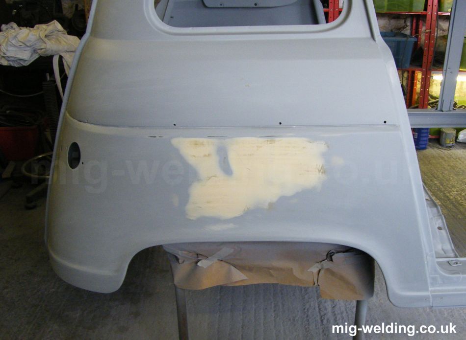

Here's the panel after filling. I've missed a dent on the top left of the photo, but other than that some light sanding and stopper would make the level fairly close to correct. I use 80 grit sandpaper - it clogs quickly, but can be used accurately and the scratches can be finished off reasonably well before paint.
Some more checking with the steel rule shows which areas are too high and which need more filler.

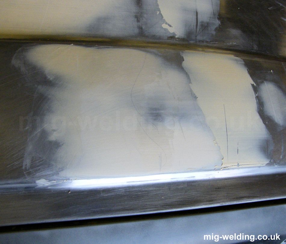

My dent covered slightly more of the panel than I first thought, so a couple more applications of filler were needed. You can just about make out the pencil lines where I've marked out the panel for more filling.
Pencil might not be the best thing to use for marking out - filler is unlikely to stick to pencil graphite. While the lines are small, and I've not noticed any problems in the past, it would probably be better to use a marker pen.

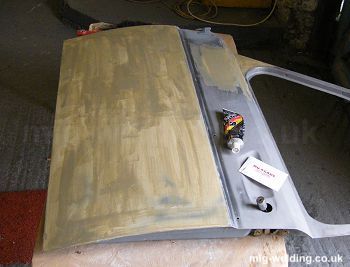

Up to this stage I've only used dry sanding. During application the filler has lots of pin holes and pockets which can trap water. Water trapped under the paint will tend to bubble up on a hot day, so it's a good thing to avoid.
My preference for sanding is 80 grit sandpaper by hand using the rule to check levels rather using a sanding block. With hand sanding you have more of a feel for the panel shape. Between each coat I'll use a brush to remove sanding dust from the pockets in the filler.
Final sanded filler

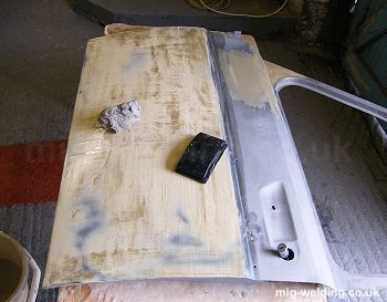

For the first time I'm wet sanding using 240 grit sandpaper.
Generally sanding blocks will scrape at the edges more than the middle. For this reason the block should be used at an angle to even out the effect of the edges and prevent scoring.
Filler absorbs water, so I'll leave it to dry for at least 24 hours before painting.
Stopper wet sanded

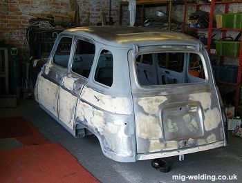

The panels on this side are now ready for paint. I've gone over the bare metal with 100 grit sandpaper (to remove the surface rust that appeared instantly on wet sanding).
The panels feel perfect to the touch, but they are still not good enough for a gloss paint finish. The next stage in filling is spray on filler primer (high build primer).
Shell prepared for paint
