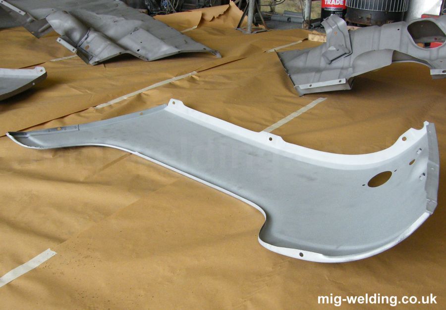

With DIY sandblasting it's even possible to blast thin flat panels without distortion. The photo shows an outer rear wing pressed from 0.8mm sheet. I blasted the inside as I needed the key for the high zinc content paint I planned to use.
Though it's touch and go - One of the panels I blasted was an old stock panel with those rust worms under the paint. That took a lot of time to clean up, and the panel did make a pop noise at one point. No lasting damage to the panel, but from there I was more careful.
For the other panels I turned the pressure down to about 70psi and would blast a 100mm square in one part of the panel, then move to a different part of the panel and blast another 100mm square and so on until the squares joined up. That was to avoid localised heat build up which could have distorted the panel.
Sandblasted outer wing panel
