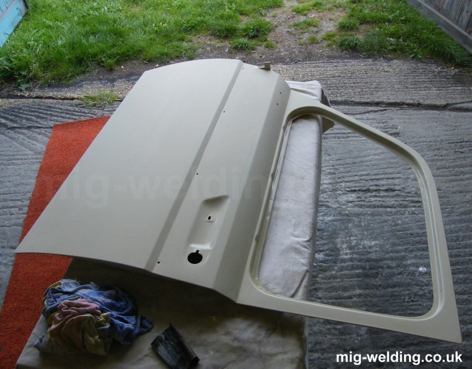

The time between the first and last colour coats should be minimised to reduce the time the colour has to pick up contamination. The number of colour coats required depends on the type and colour of paint. The panel in the photograph was painted in 2-pack paint and required only 2 coats. A light colour in cellulose paint might need 4 coats to build up the full opacity of the paint.
Paint faults such as drips or dust should be rectified prior to spraying subsequent coats. Excessive orange peel might also be lightly sanded between coats.
Panel following colour coat

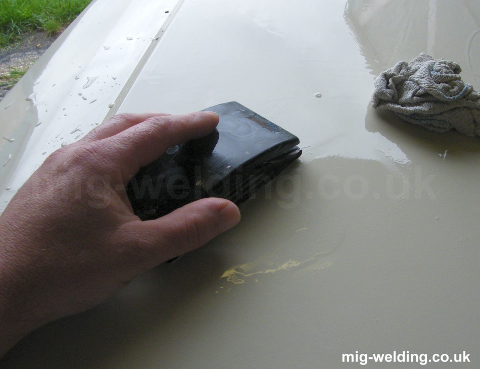

It is possible to achieve a decent finish out of the gun, but most DIY painters will sand colour coats to produce an even flat finish. The colour should be allowed to dry overnight before flatting. Before wet sanding rub the sandpaper on a bar of soap to help prevent the paper from clogging. A thorough rinse will be necessary after sanding to remove all traces of the soap.
For a completely flat mirror finish the panels would be wet flatted with 1200 grit, then compounded and polished to a mirror finish. A mirror finish will show every imperfection in panel shape so will not be suitable for every car.
A factory finish would include a slight orange peel texture (have a close look at new cars - the finish can often be quite poor). To achieve this the panel can be wet flatted with 800 grit sandpaper and sprayed with a final colour coat which can then be polished.
Wet flatting colour coat
Be careful not to sand through to the primer - that creates the hassle of further coats and more sanding. Assuming the primer was wet flatted with a guide coat the top coat will not sand through until it is completely flat, though it's still easy to sand through at the edges.
