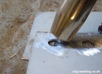

Welding through the hole
Position the welding torch with the wire in the center of the hole contacting the back sheet of metal. It is important to arc against this back sheet rather than on the edge of the hole, otherwise the weld might not penetrate into the back sheet. The torch should ideally be pointing directly into the hole rather than at the angle in the photograph.
Start welding in this position and don't move the welder until the hole is almost full of weld. Then move the welder outwards in ever increasing circles until the weld is completed.
