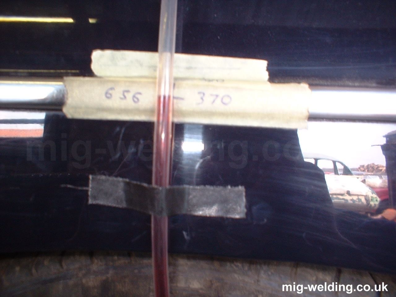

Setting up: The red wine level gauge
I use a plastic tube full of red wine to set levels. Water doesn't flow to to the correct level in a thin tube. Tape one end of the tube to one corner of the car and the other to another corner. Mark off the height of the wine on a bit of masking tape on each side.
Check the car side to side and corner to corner and mark the levels. Then check regularly throughout sill replacement to make sure nothing has moved.
If you level the car using bits of wood/metal under the axle stands you will also be able to use the red wine level gauge to position bits of chassis and suspension mounts. The accuracy is within 1mm, which is better than body manufacturers can guarantee.
Red wine level gauge

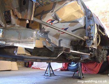

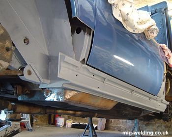

Sill rust
Cutting out the old sills
The old sills can be roughly cut off using a gas cutting torch, and the remains can be removed using an angle grinder.
I've angle ground the remains of the sills from the chassis members and floors leaving the original flanges on the floor in place.
As always, any metal you need to MIG weld to has to be spotless and shiny. I needed to make a few repairs to various chassis members before I got to this stage.
A good trick is to clean up every bit of metal at the earliest opportunity. Otherwise you could find the new sill gets in the way of your angle grinder.
Sills removed

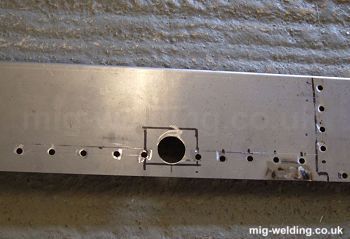

Plug welds instead of spot welds
The sill was originally spot welded in place. Actually, being an old Aston Martin, the sill was spot welded then comprehensively seam welded.
I positioned the sill on the car and used a marker pen to mark the position of the floor flanges. The sill came off and was drilled for plug welding.
The plug welding holes are 7.5mm in diameter and spaced at 1.5 inches. See the plug welding technique page for more details about this type of weld.
Plug welding holes

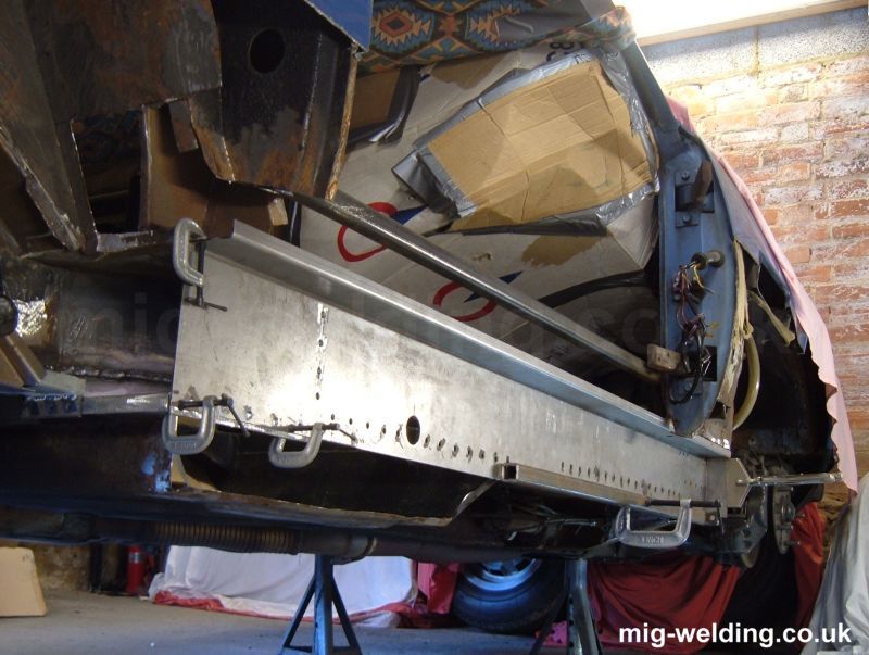

Clamping in place
It takes a long time to align the new sill. Here the new inner sill is clamped in place. I used metre long steel rulers, a square, and long steel bars to ensure the sill was straight.
Mini G clamps cost £1 each and are wonderful for clamping flanges together. I've also recently invested in a set of three welding clamps for just £10. These are mole grips with fancy bits welded on the end to improve their reach and spread the load.
Sill trial fit

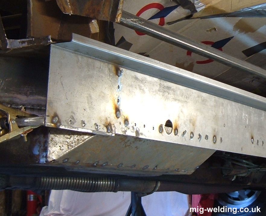

Tack Welding and Plug Welding
This is where you have to be really patient. If you get any heat into the sill before it's very much in place it will distort. Start off by tacking the ends in position. Then put a few small tacks on the main structural joints. Do a couple of plug welds, then take a break to let everything cool down.
Put in some very short seam welds (10mm or so) the first at one end of the car, the next at the other end. Then take a break to let everything cool down. Patience is the name of the game. It's much faster to weld very slowly than to correct the distortion after a long seam weld.
With the plug welding completed the rest of the sill would be fitted prior to seam welding.
Sill tack welded in place
