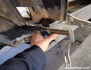

Positioning
I've clamped the sill into position as that dictates the shape of the repair section I'll need to make. The photograph shows me using a square to position the new sill at a right angle to the top of the chassis.

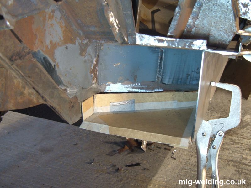

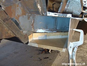

Making a template
Cardboard pizza boxes are an ideal source of material for making templates.
Card behaves in a very similar way to sheet steel - it is very difficult to bend into a compound curve. The advantage over steel is it is very easy to cut, so if you get it wrong you can quickly make another template.
Cardboard template

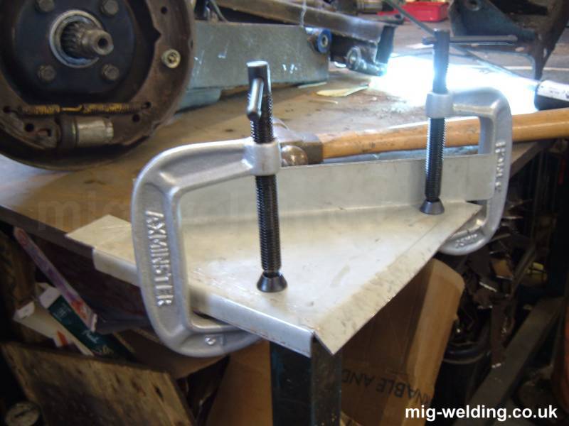

There are a variety of ways to make the bends. My favourite is my 4 foot metal bender. but I also make use of a vice. The photograph shows a further technique: I have a 1/2 inch thick steel work bench. If I clamp the steel to the bench I can make a neat bend by hammering the steel over the edge of the bench.
Metal bending on a steel bench

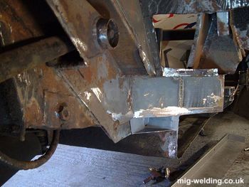

Seam Welding
Any chassis part should be fully seam welded. I've butt jointed the repair panel as an overlap joint would trap water and rust.
Distortion isn't really an issue in a thick folded panel like this one, so the seam weld could be made quickly.
Seam weld on repair section

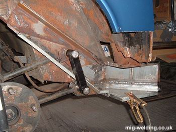

Later:
The lower part of the chassis and the suspension mounting have been positioned using a really simple chassis jig.
Jigs are essential for positioning suspension mountings. I once welded some suspension mountings on my Renault 4 without a jig, and while everything was pretty close the car sagged to one side. I ended up using a jig to re-drill the holes and make the car perfect.
Repair section complete
