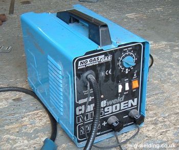

I've always wondered whether the "hobby" mig welders were any good. The challenge for the Clarke 90EN review was to see whether it would weld at all, and then to test out the manufacturer's claims and see if it could really weld up to 4mm thick steel.
Actually the answer was a fairly straight no (see the calculator for predictions), but the machine itself was reasonable nice to use. The page is included here as it includes some tips on joint preparation that will increase the thickness capability of small welders.
The Clarke 90EN MIG Welder
That's just 90 amps. But it's a natty little welder that can do both gas and gasless welding. The knobs at the bottom marked "+" and "-" are for attaching the earth wire and power feed to the gun. The wires can be changed over to go from gasless to gas shielding welding. (The photo shows the set up for gasless with a positive earth).
Machine Mart claims "Power settings from 24 - 90amps. Welds mild steel up to 4mm thickness." Which seems quite a lot for such a little welder so I thought I'd put it to the test. I set it up with 0.8mm steel wire and Argon/CO2 mix shielding gas.

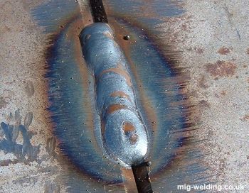

3mm sheet
So already wanting more power I decided to try some 3mm steel.
With the the power still set at maximum I tried butting two sheets of 3mm steel together. Maybe welding even more slowly would be enough to get some penetration.
Weld in 3mm sheet steel
Nope - no sign of any penetration on the reverse.
You've got to watch this with MIG. Welds made with low power can look nice but have absolutely no penetration.
With MIG the heat of the weld pool melts the parent metal. If the metal is thick and amps are low the heat is sucked away too quickly and doesn't have a chance to penetrate the parent metal.
Penetration in 3mm sheet steel
I tried a bend test in the vice. It took a bit of hammering to break the weld, but when it did break the weld broke in two which means it was less strong than the steel it was trying to join together. Penetration turned out to be very poor, with the weld barely penetrating a quarter of the way through the sheet.
So we can't weld 3mm sheet never mind 4mm.
Bend test in 3mm weld

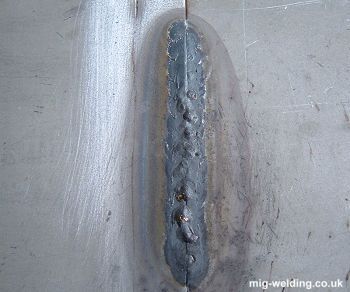

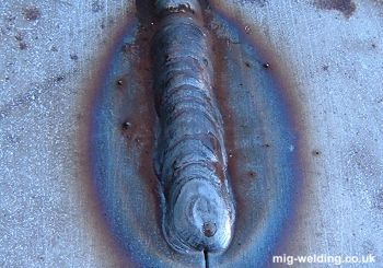

Let's try adding a V and a root gap to the 3mm sheet.
Thick sheets are hard to weld, so it's probably not unreasonable for the manufacturers to expect us to do a little preparation.
Here I've tapered the edges of the 3mm sheet to create a 90 degree V. Also I've spaced the two sheets apart by 1mm (root gap). That's about all I can do to help the poor welder. The weld looks neat, how's the penetration?
Weld in 3mm steel prepared with a V and a root gap
Once again the penetration was quite good once the welder got going. But for the first 15mm the welder couldn't get the metal hot enough and penetration was poor. Again, even with the V and the root gap I find myself reaching for another power setting.
Penetration could be improved with gasless wire which should be run on the opposite polarity to gas shielded wire. I've not tried that in this test.
Penetration for 3mm steel with V and root gap
I tried another bend test. This time the parent metal broke rather than the weld, which is a good sign that some of the weld was OK (apart from that first 15mm where there just wasn't enough heat - there the weld broke before the metal).
It seems unfair to even ask the welder to try anything more than 3mm, never mind claim that it can manage it.
Bend test for 3mm sheet with V and root gap
