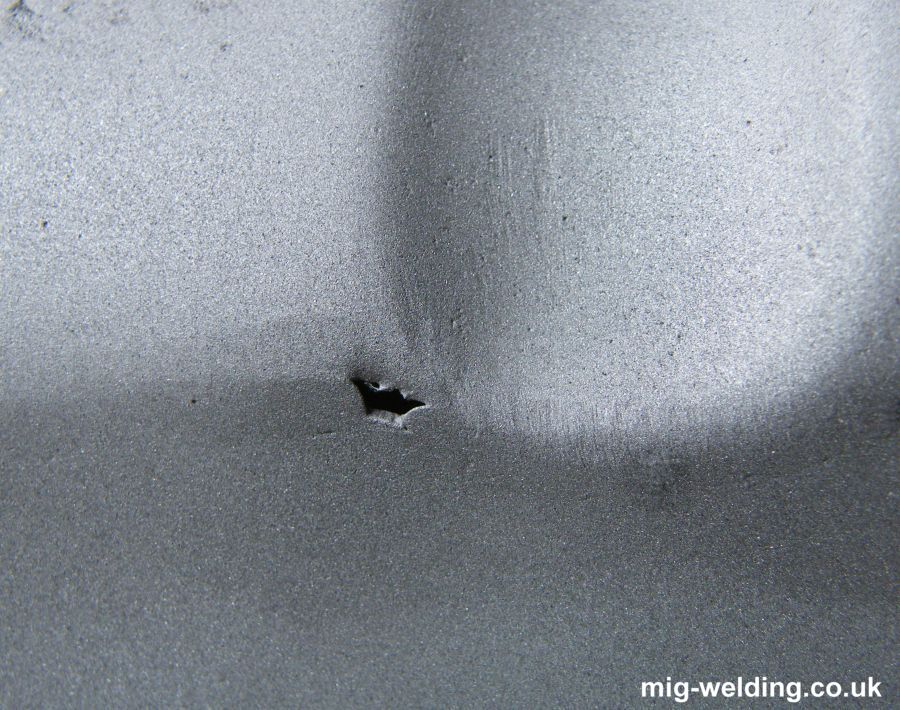

Be careful not to over-grind. This is the same panel after sandblasting and I have thinned the metal too much on two of the corners.
For most of my other repairs on this car I've stopped grinding when the flap disc just starts to touch the metal beside the weld. The rest can be left to plastic body filler or seam sealant. This would be especially the right approach in a structural area as it's very easy to overgrind and end up with thin weak metal.
