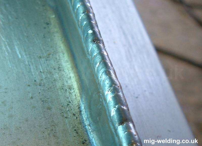

Welding an edge
I had to weld an edge today, and it had to be neat so I practiced on some scrap metal to develop a technique.
The problem with welding edges is that there is nowhere for the excess heat to go, so it's easy to melt the edge away making the end result very blobby. I found that turning the wire speed down very low was the answer.
Problem is the wire vaporised as it left the torch. My technique was to hold the torch very close to the steel, so close that the outer shield touched the metal. This resulted in a neat weld, but overheated the welding tip so I could only do short sections at a time.
