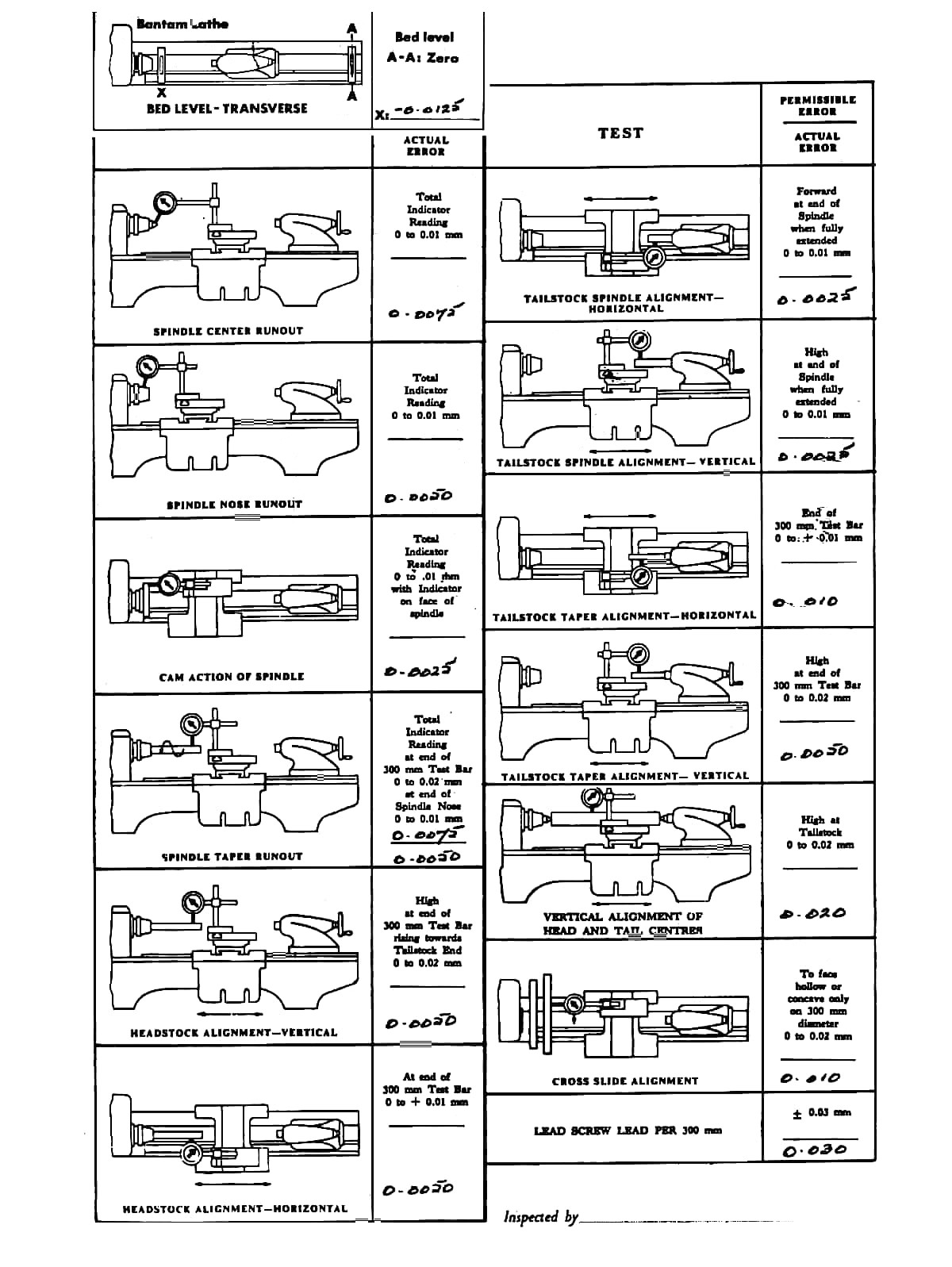

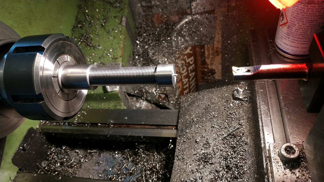

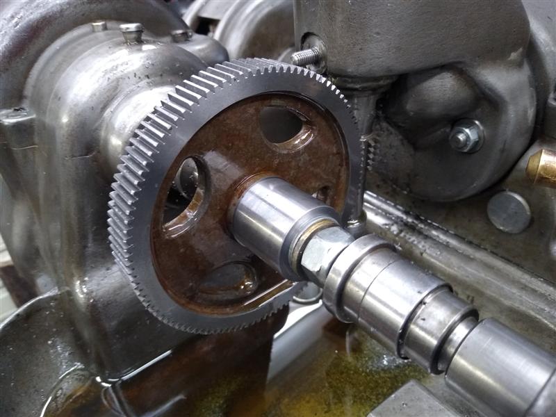

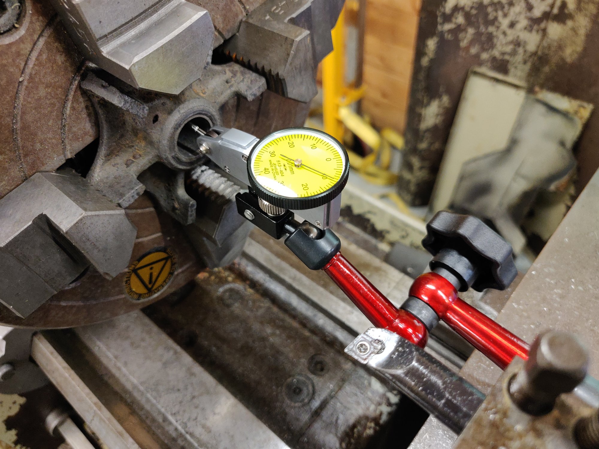

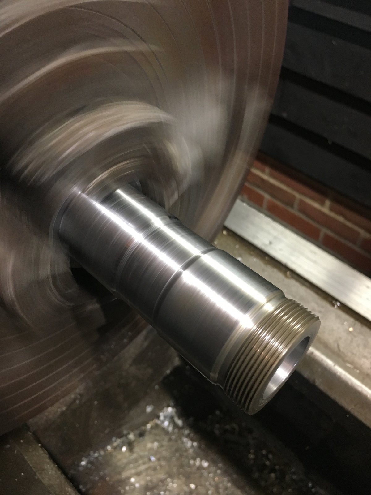

Just the bed levelling to adjust as it cuts a bit of a taper.
Is it bed levelling or the tail stock offset?
Very tidy looking thread
I need to get a decent machinist level and set mine down.It came out perfectly, en16 is a lovely material.
Like you I don't mess about with the compound, straight in.
Bed. To be honest I never perfected it so it's about time.
Got an edge tailstock alignment bar for the tailstock.
My Bosch digital level measures to 0.1 degree but I think it’s still only 0.5mm a meter.A builder's level bubble is unlikely to even move when a sensitive level will go full swing. Not the same thing at all.
Whoosh.
If you use the two collar method you don't need a level at all...
Well, why even mention using a builder's level? By the way a 2-collar method is fine if the head is aligned by the vee ways. Not much cop for something like a Colchester that has an adjustable headstock.
Quite, 6 minutes of arc. My engineer's level is 10 seconds I think, 36 times more sensitive. Might even be 5 seconds.
For a bit of funsies old chap, we need to get our kicks somehow in lockdown.
I think I'm funny...
Brad won't have an issue, his headstock is on vees. Interesting though, how would one align the headstock?
It fits my shed and accurate enough. Without the motor upgrade it was rubbish, but apart from that I think chinese 10" lathes all about the same. A good used Harrison would be better, this only makes sence with limited space.

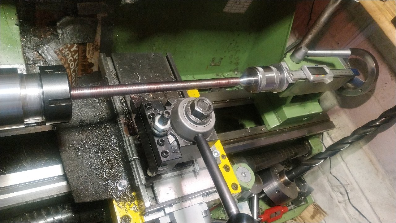

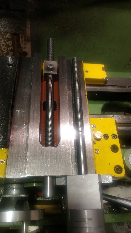

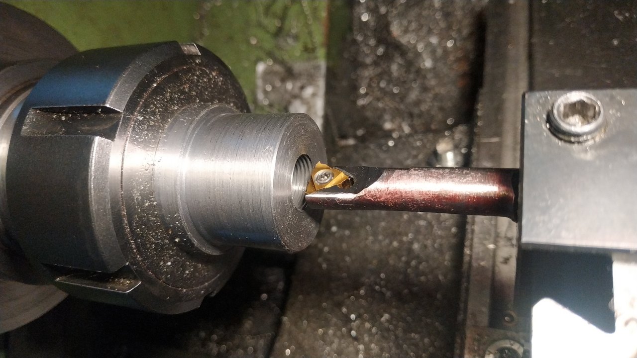

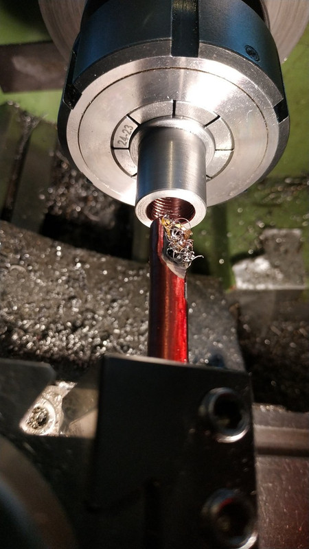

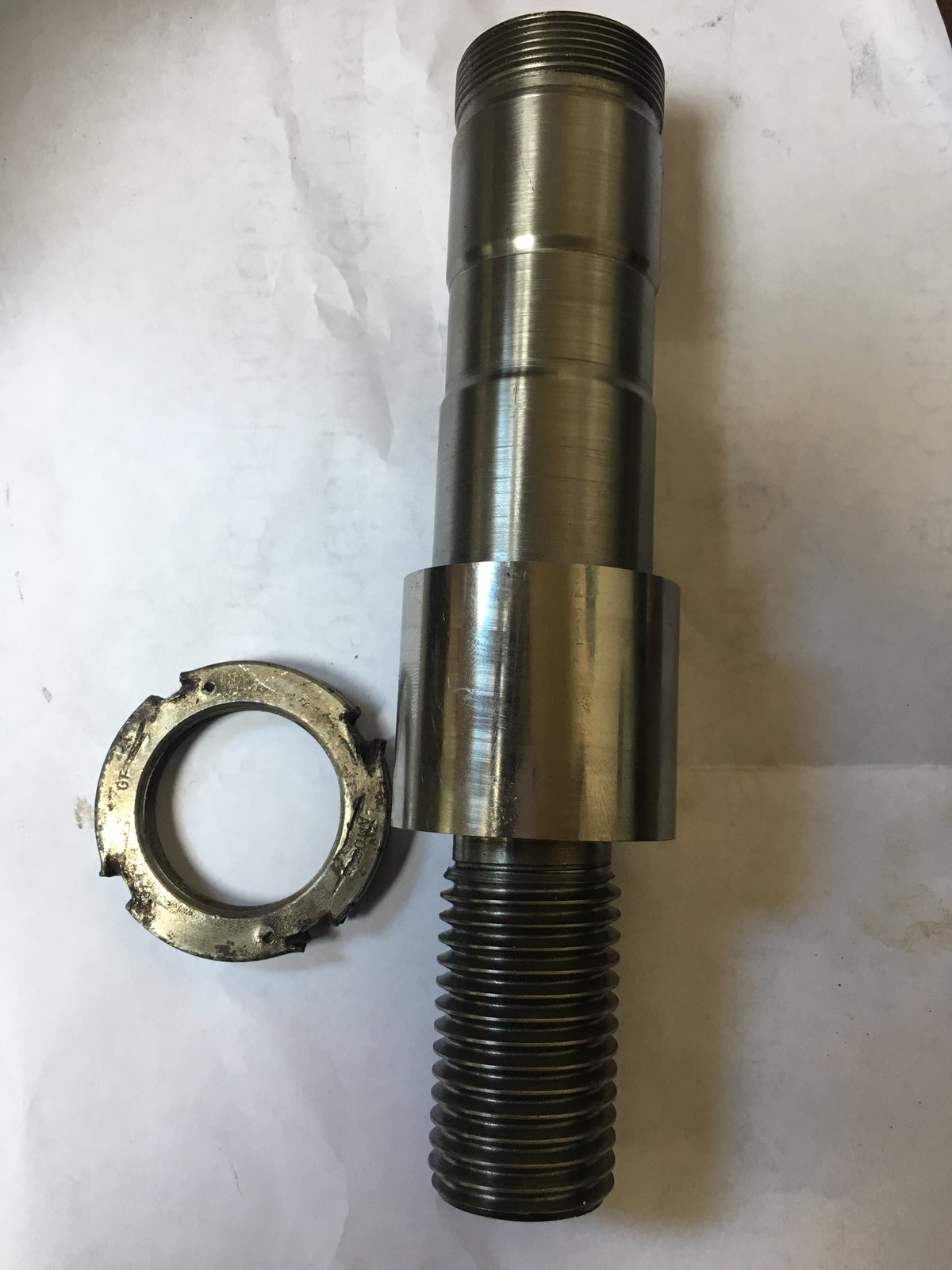

Anyway the 14TR2 thread not perfect. I did not bottom out the insert as I thought I was past full depth, so I think it needs to go back in for another cut. The split nut is tight (on and off) normal way round. If I put it on split end first it is free spinning
Marker pen rubs off the root.
