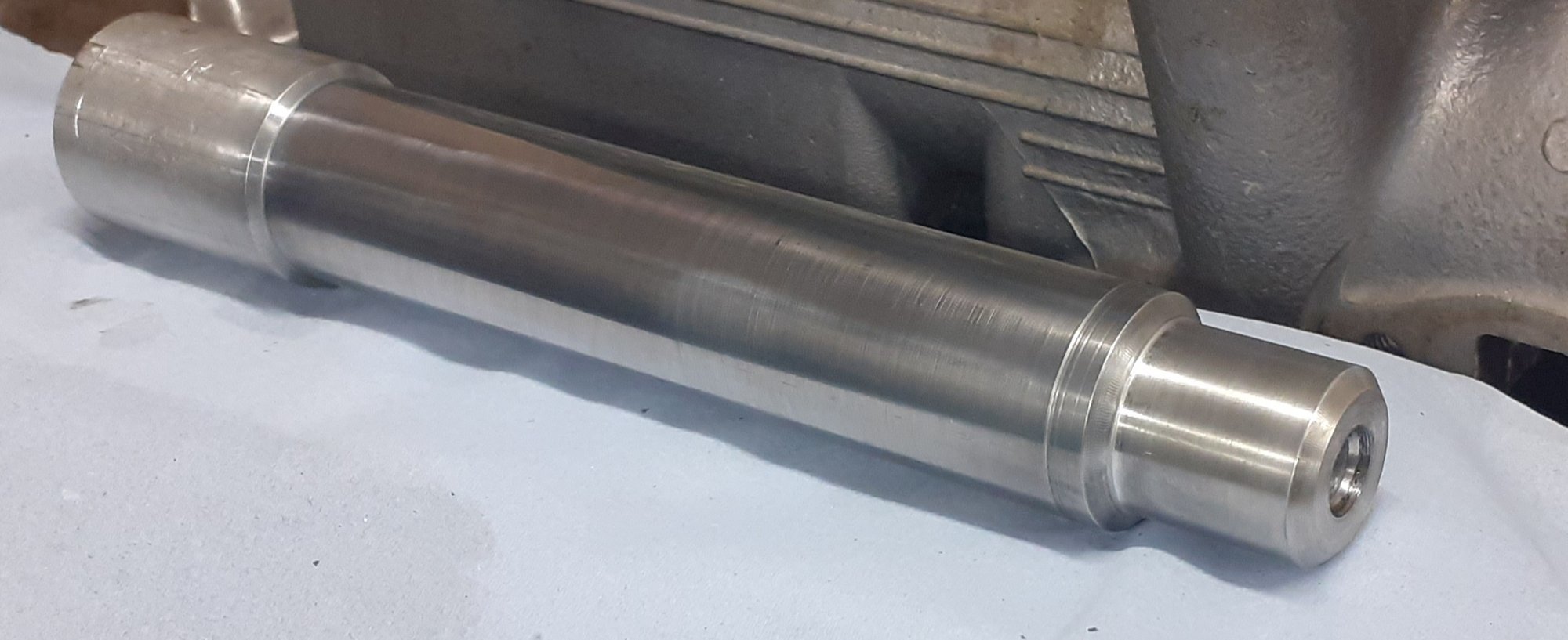

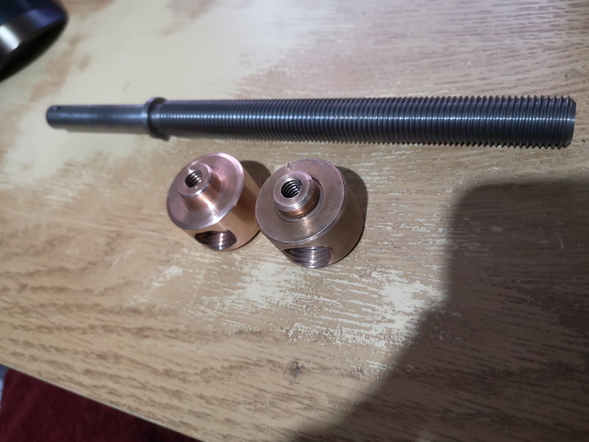

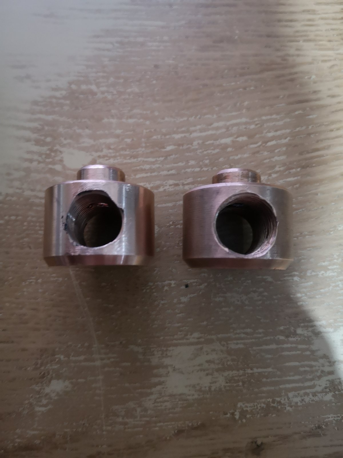

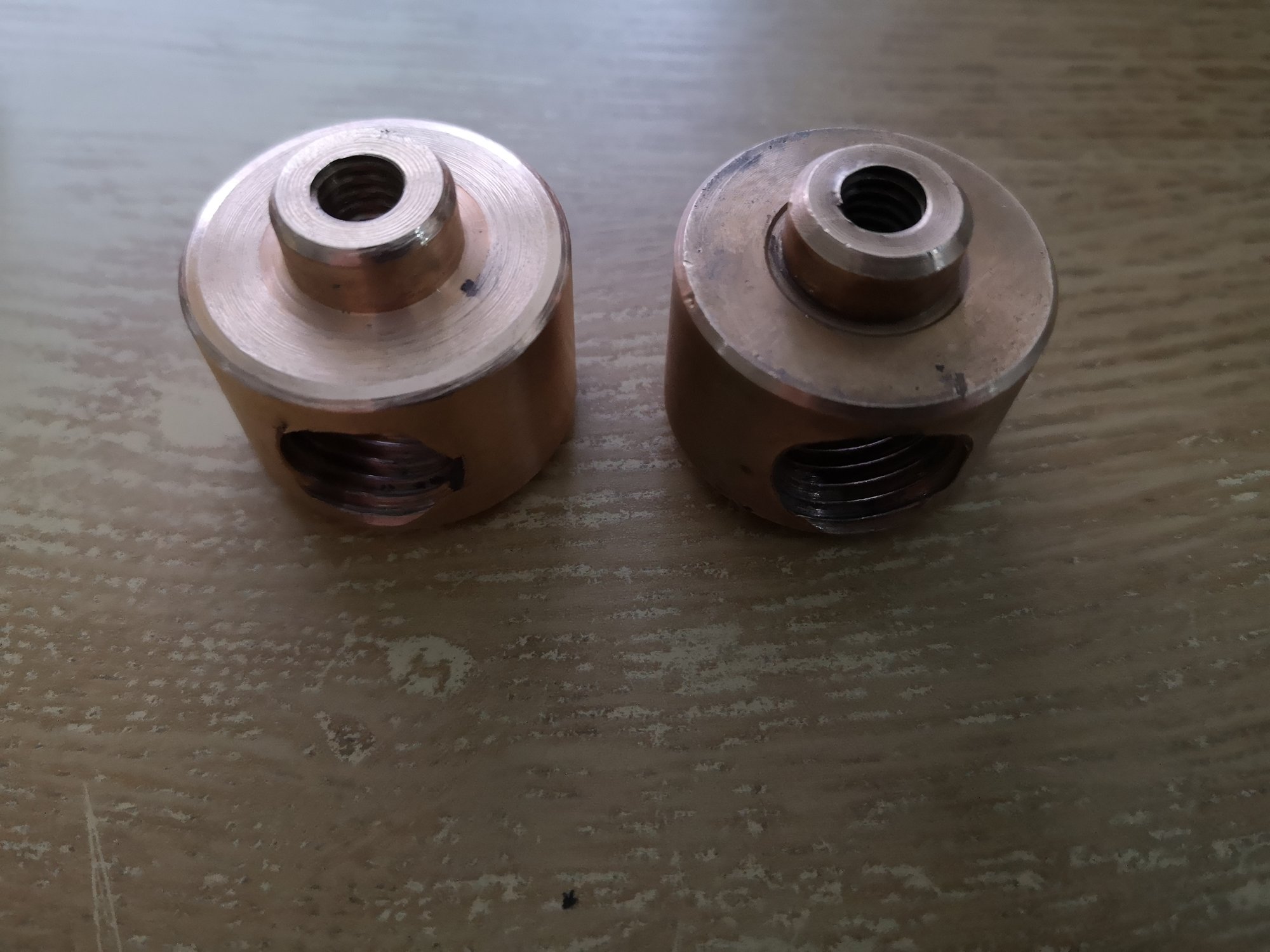

I’d be interested in adding one to the collection.Been busy making a Lead screw nut for the Mk1 Clarkson I am resurrecting.
I have been patiently wating for a 5/8 BSW Left hand tap to arrive (I bought 19 !! or ebay all L.A.L ex army surplus apparently, brand new) So if anyone needs one drop me a line
The lead screw it's self is in fine order but the bronze nut was fubared.
The lathe work was fairly straight forward, but drilling the bronze out to 35/64" and then tapping it was tough going.
That all said very happy with the results all test fitted and it's sweet

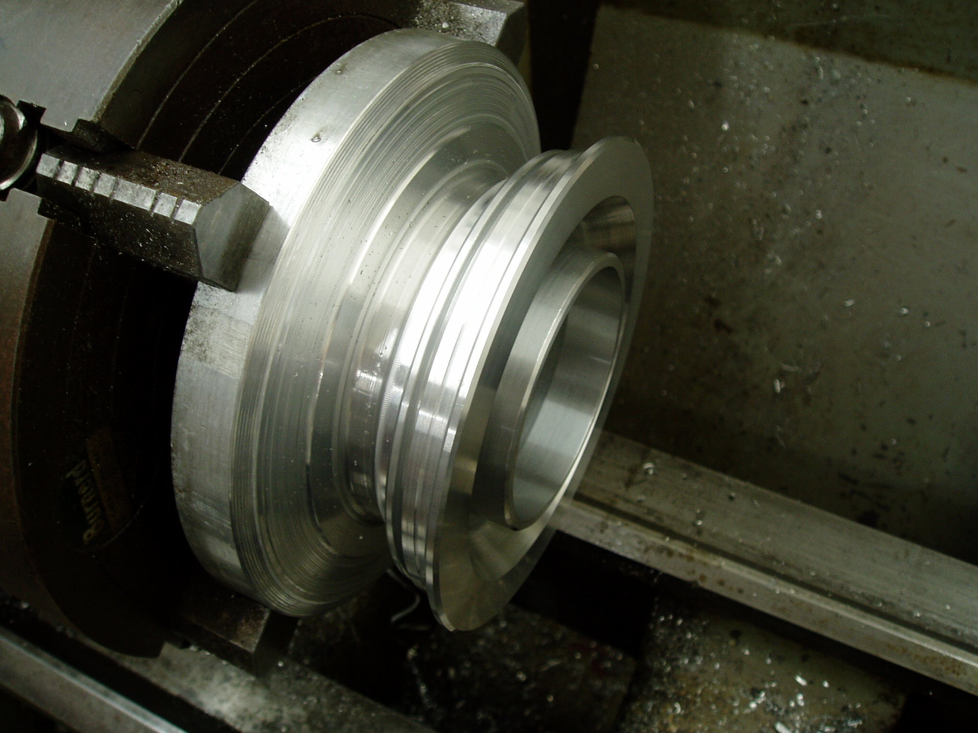

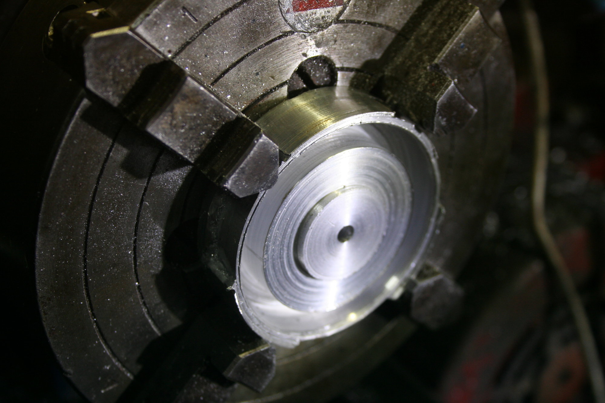

Set of bronze bushes for a mates old lathe, 3" O/D and 2 1/4" I/D with oversize flanges to bolt in position with countersunk screws.
Drilled the tops to accept a 6mm grease nipple and ran a fine spiral grease groove on the inside.

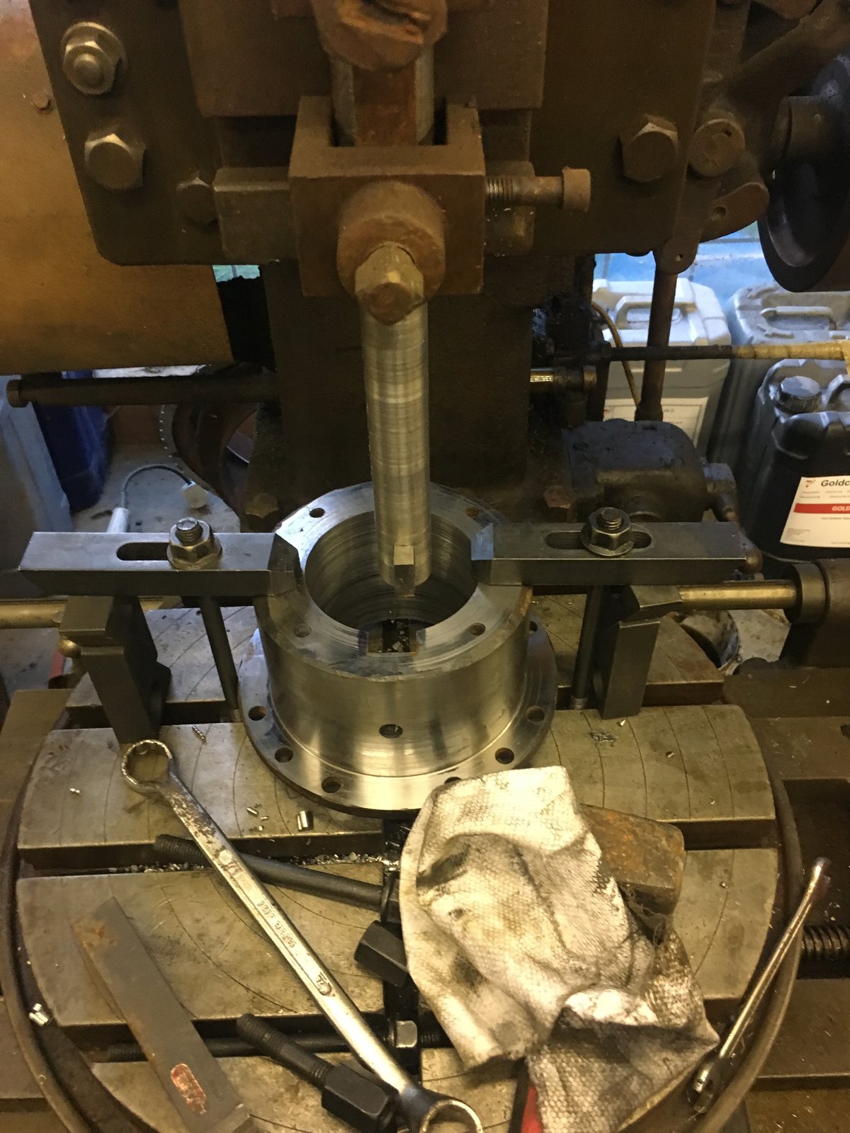

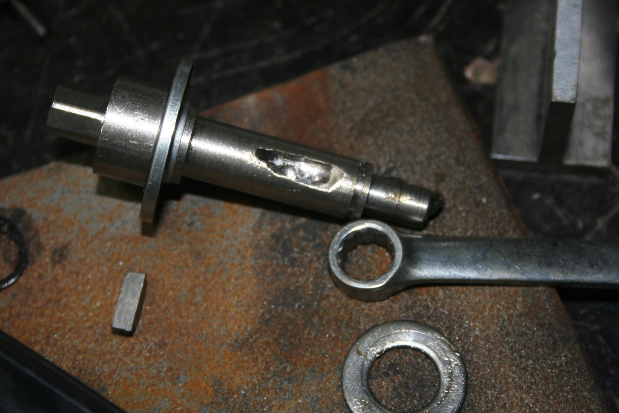

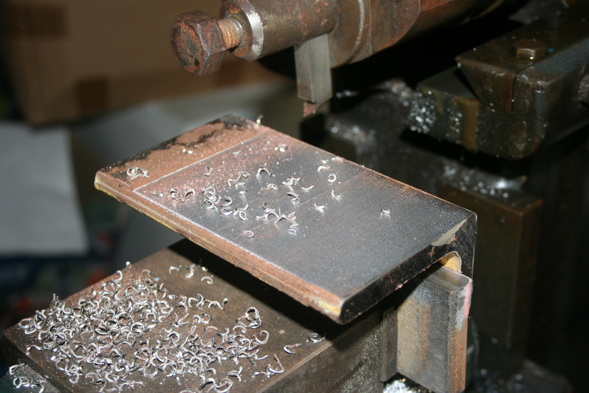

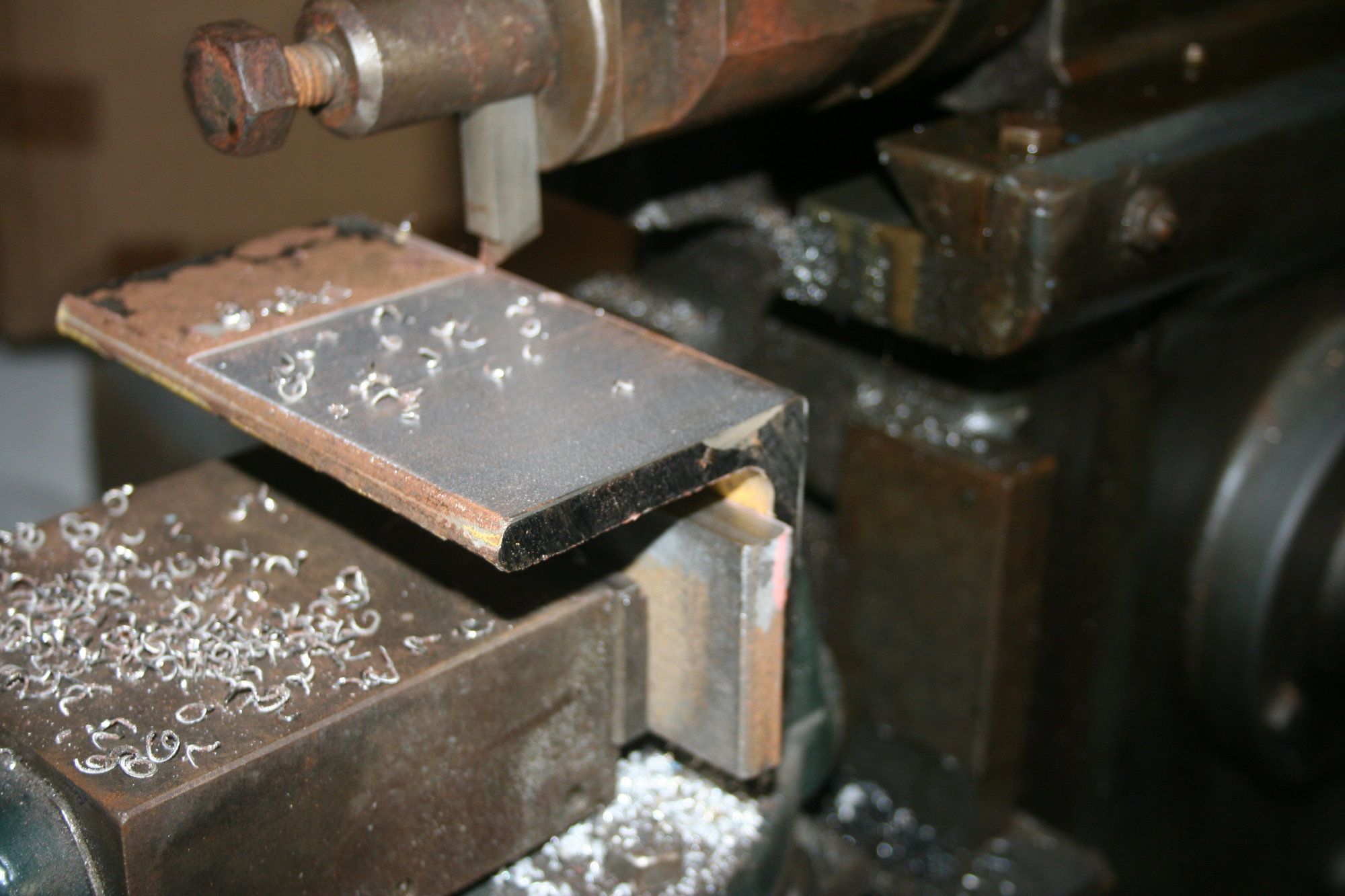

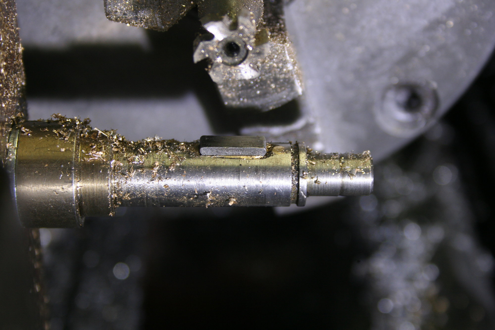

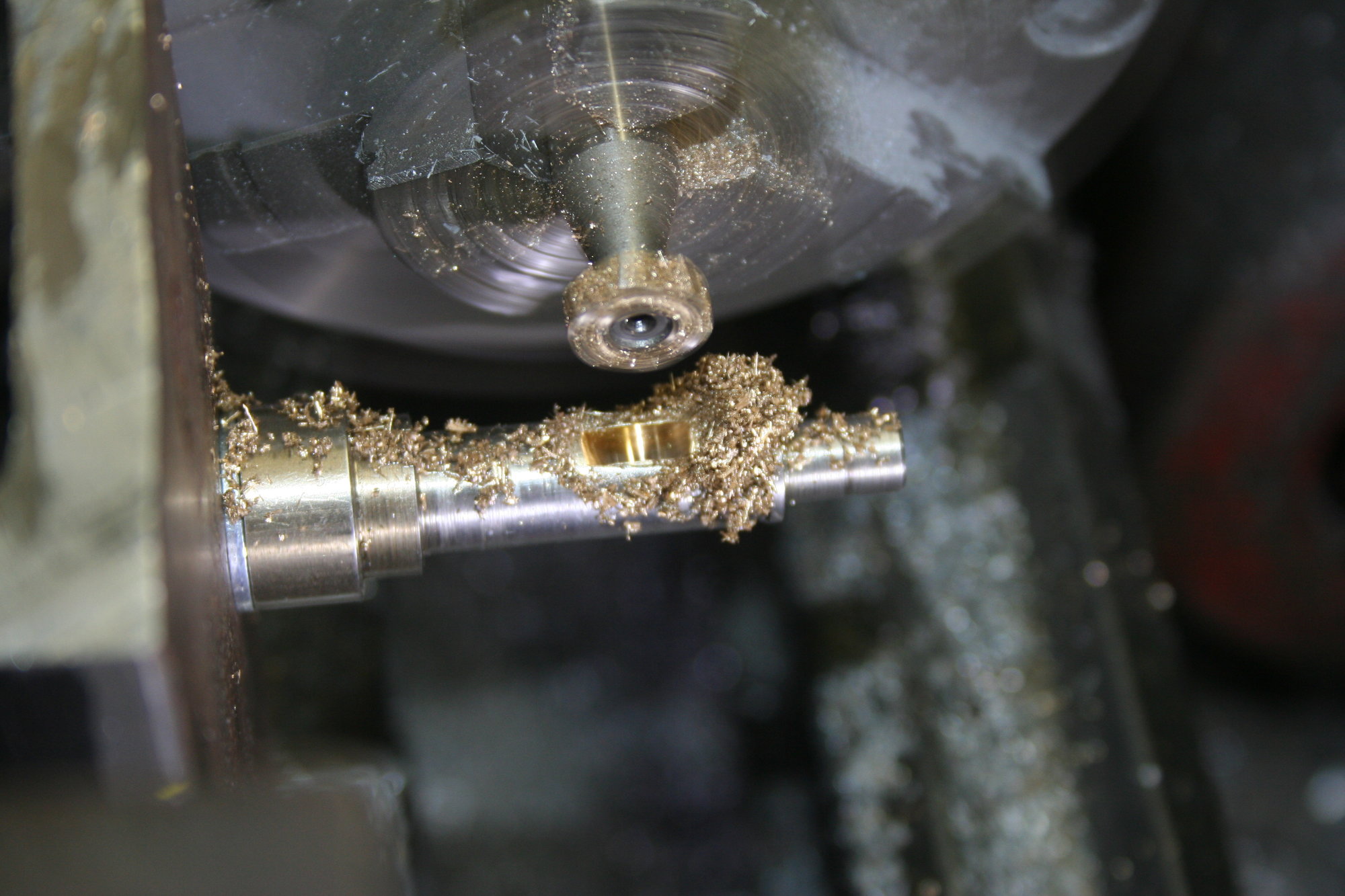

Has it absolutely got to be a woodruff key? Could you use a 4mm endmill in the lathe chuck, shaft in vertical slide and put in a parallel key? Or drill two holes either end and use the shaper turned by hand to plane a keyway?

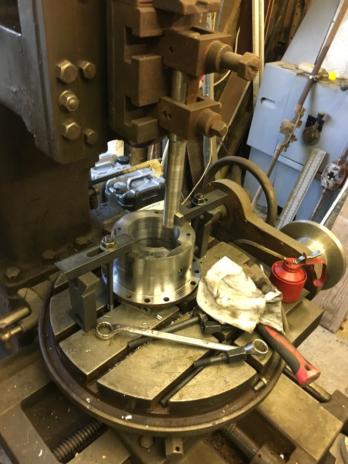

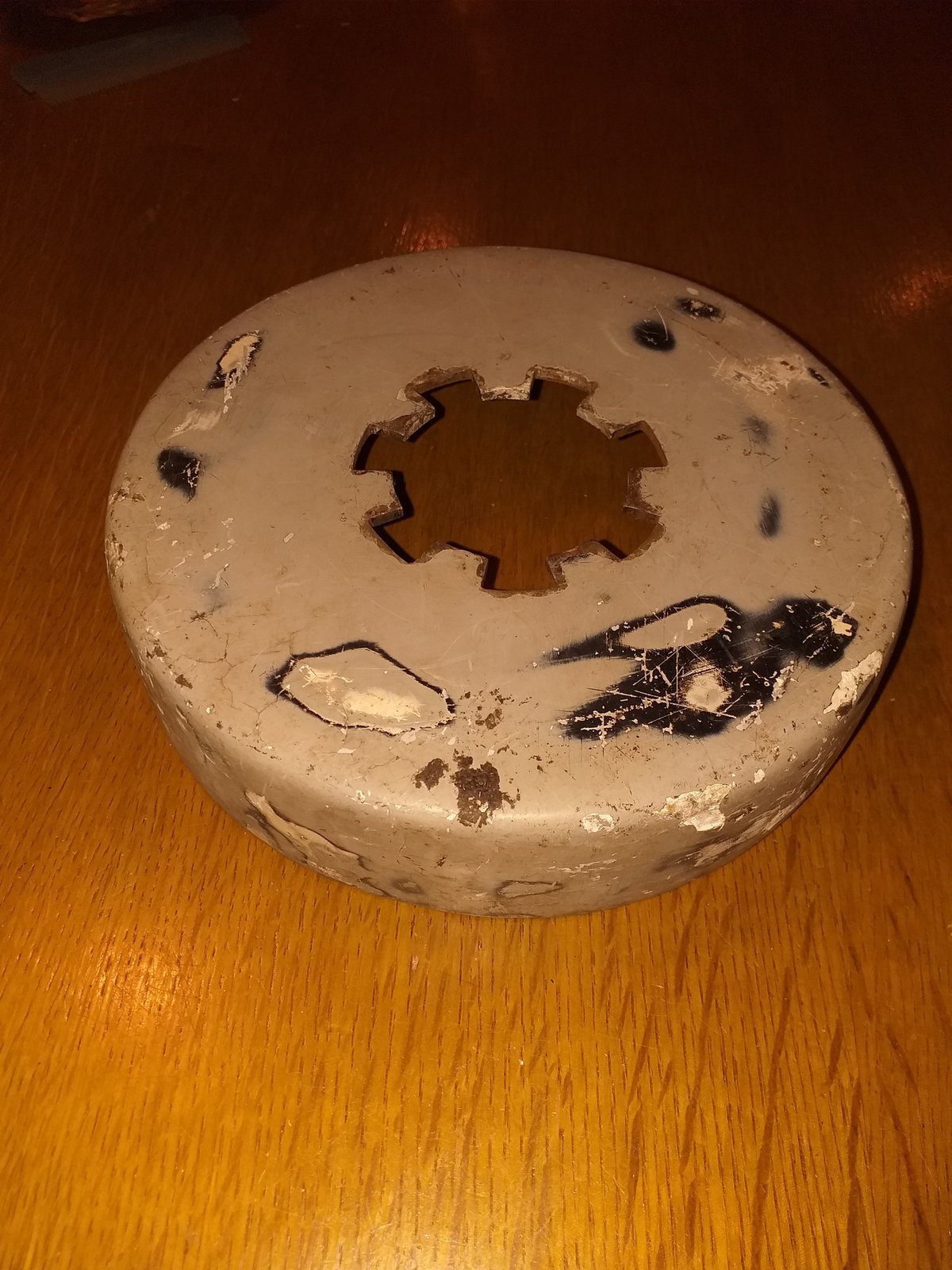

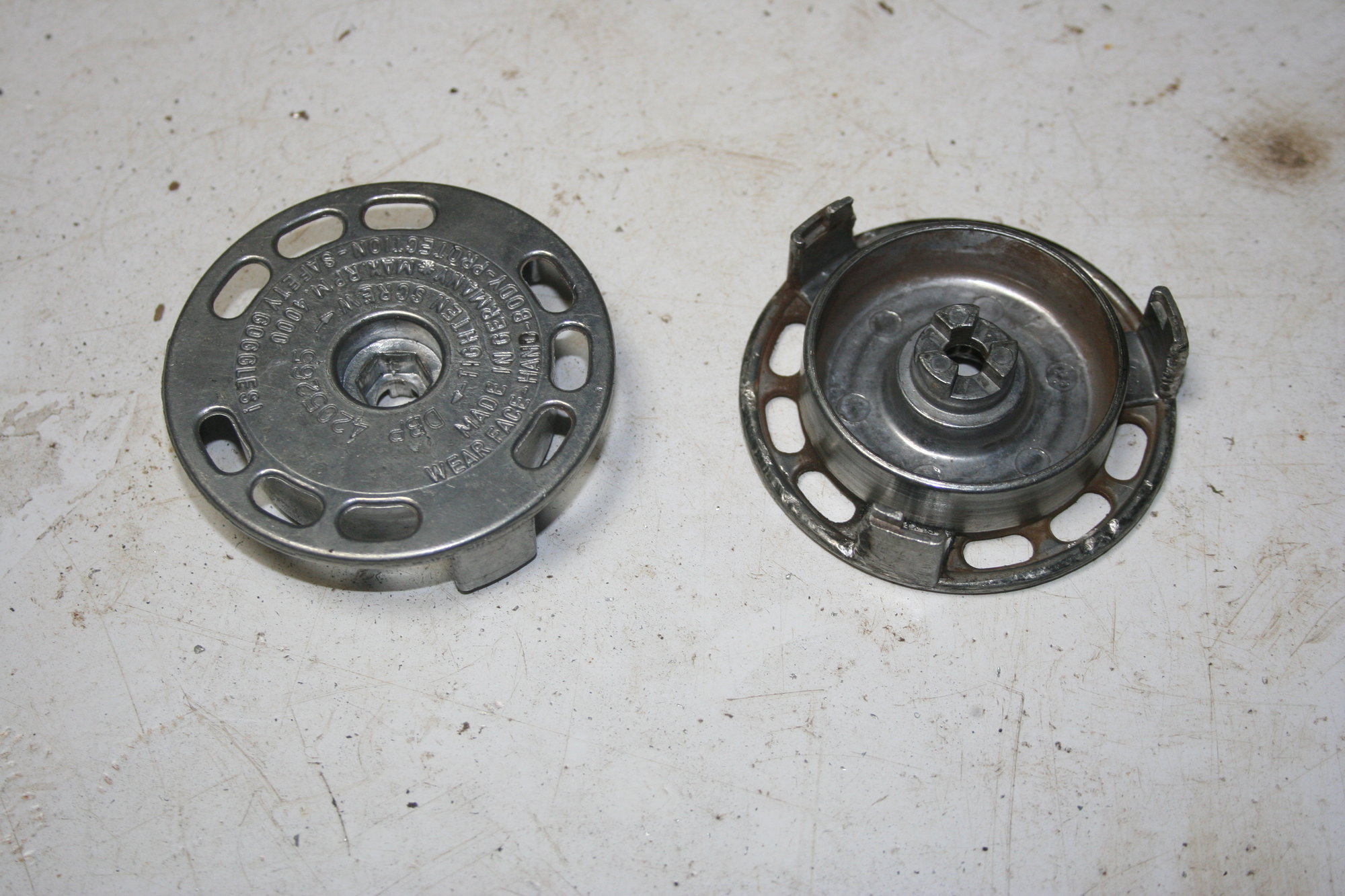

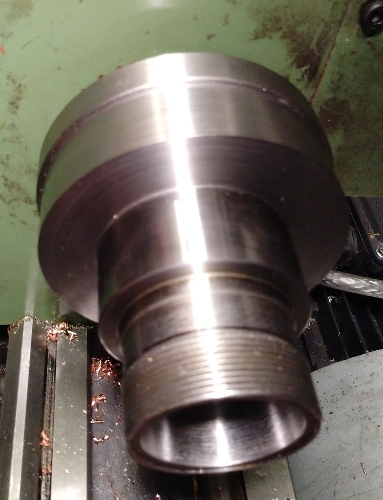

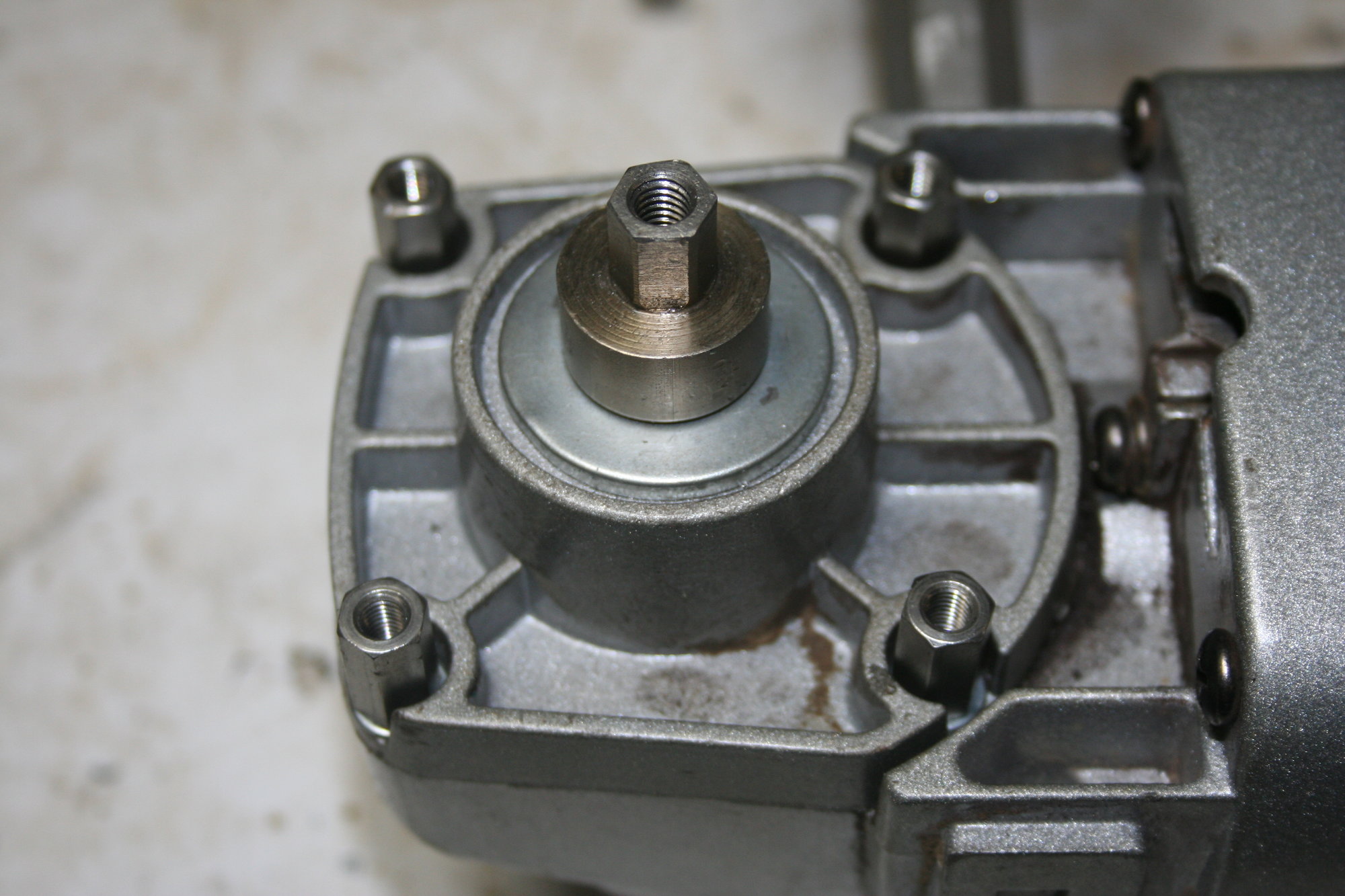

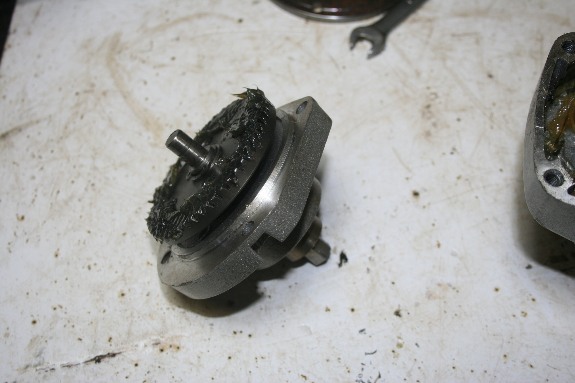

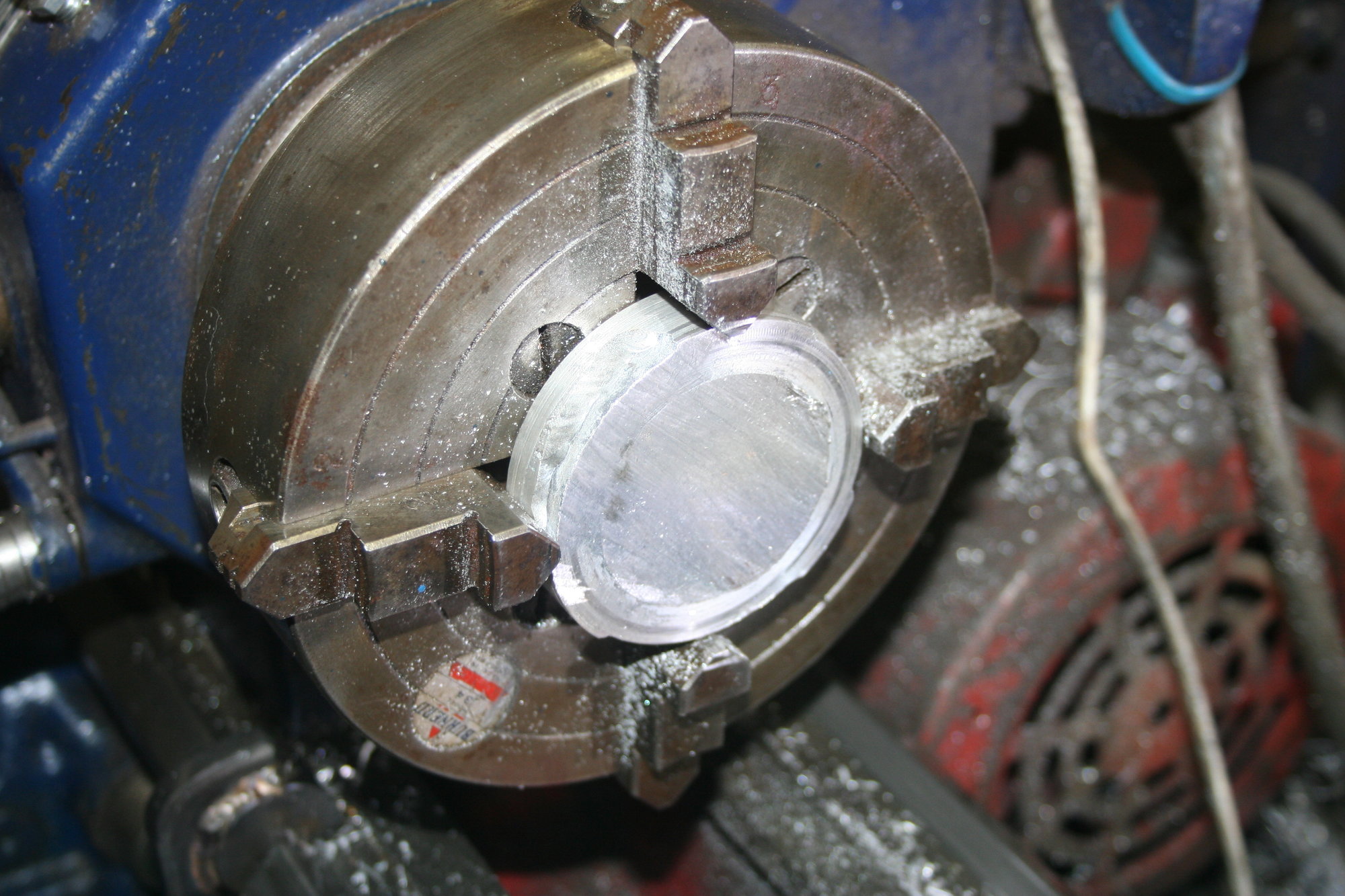

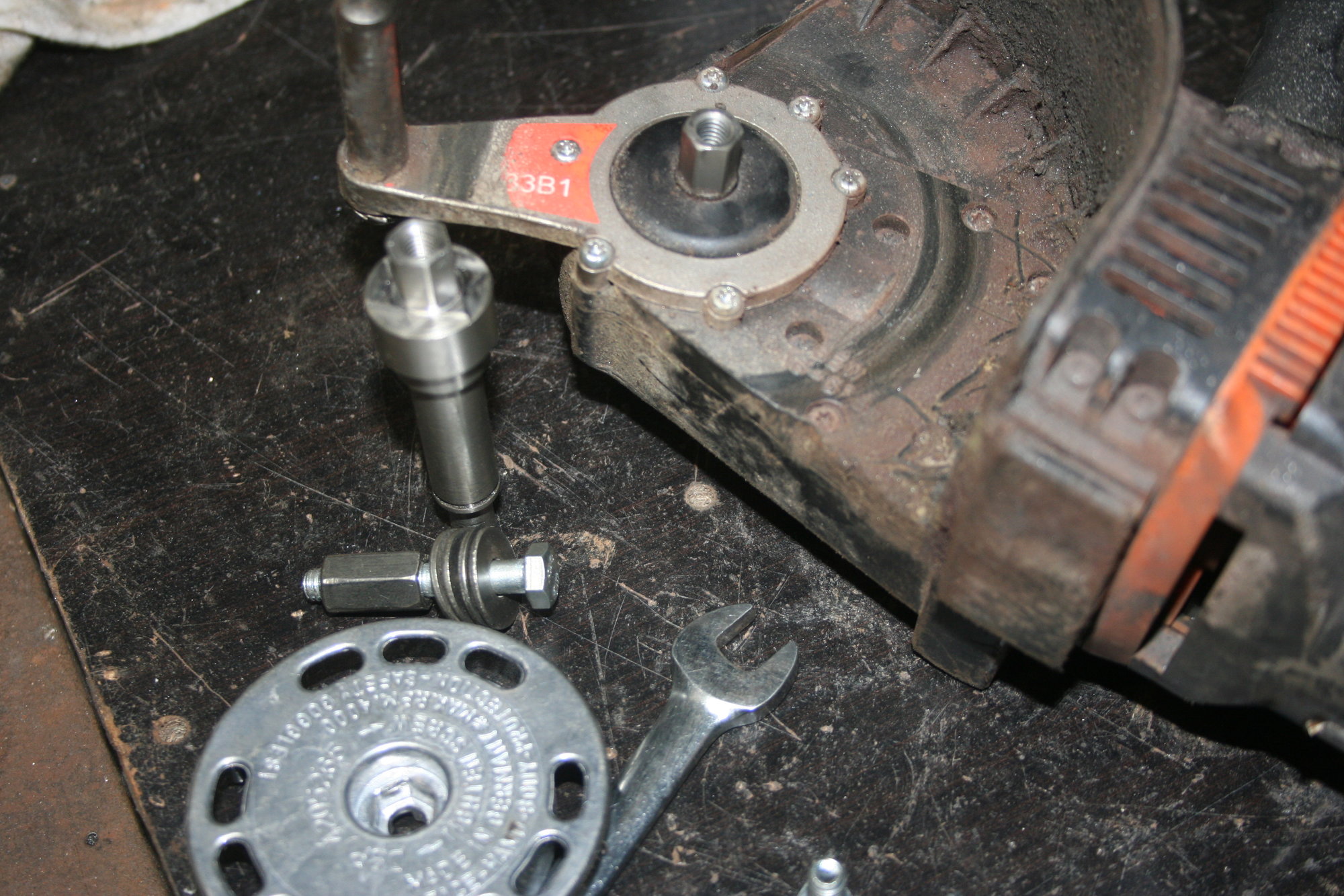

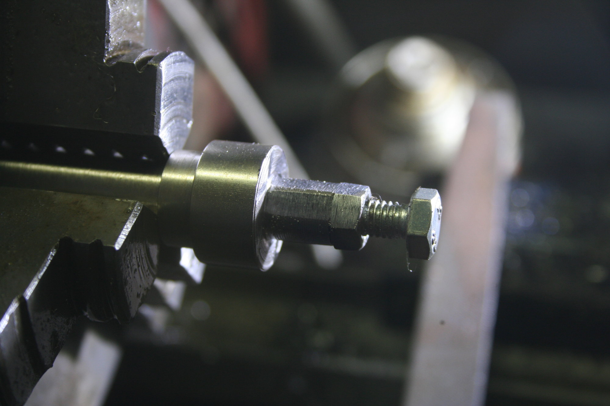

Trepanning tool or a face grooving tool which is basically like a parting toolI’m trying to make an adapter so I can fit bristle blaster brushes in the polisher I'm playing with.
It a really tricky shape (I think) and I don't have a mill or the skills.
This is the part. The two half’s are identical and fit together nicely.
I don't have any alloy big enough, so built out some smaller round bar with tig.

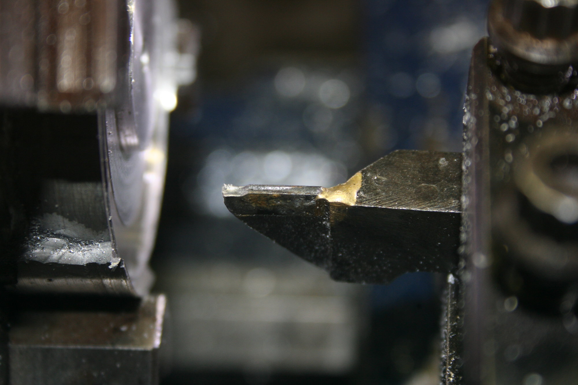

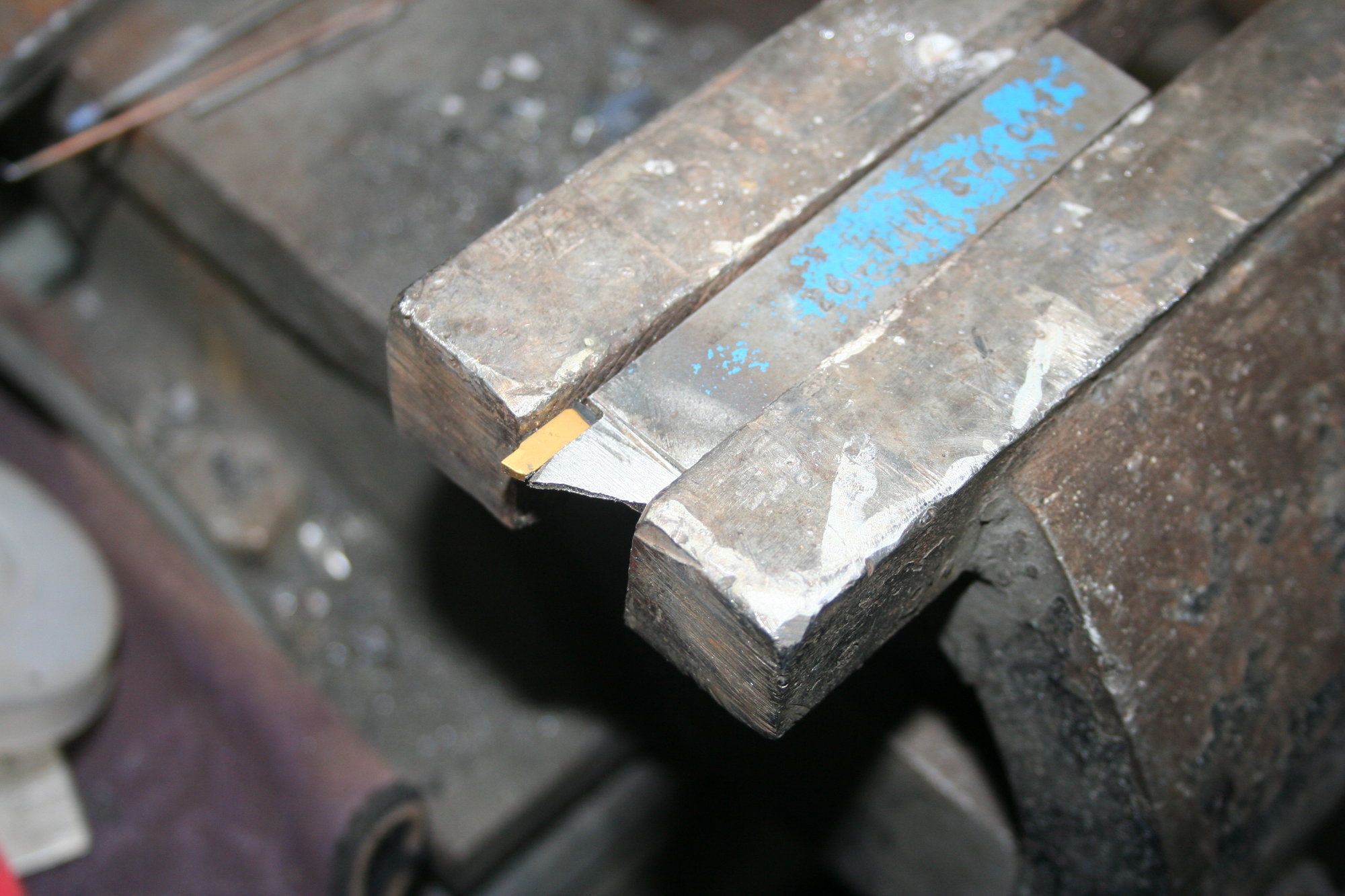

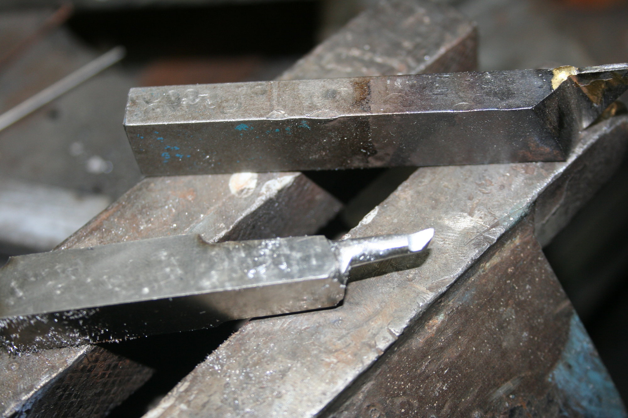

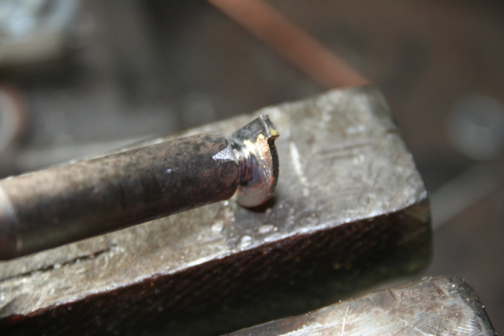

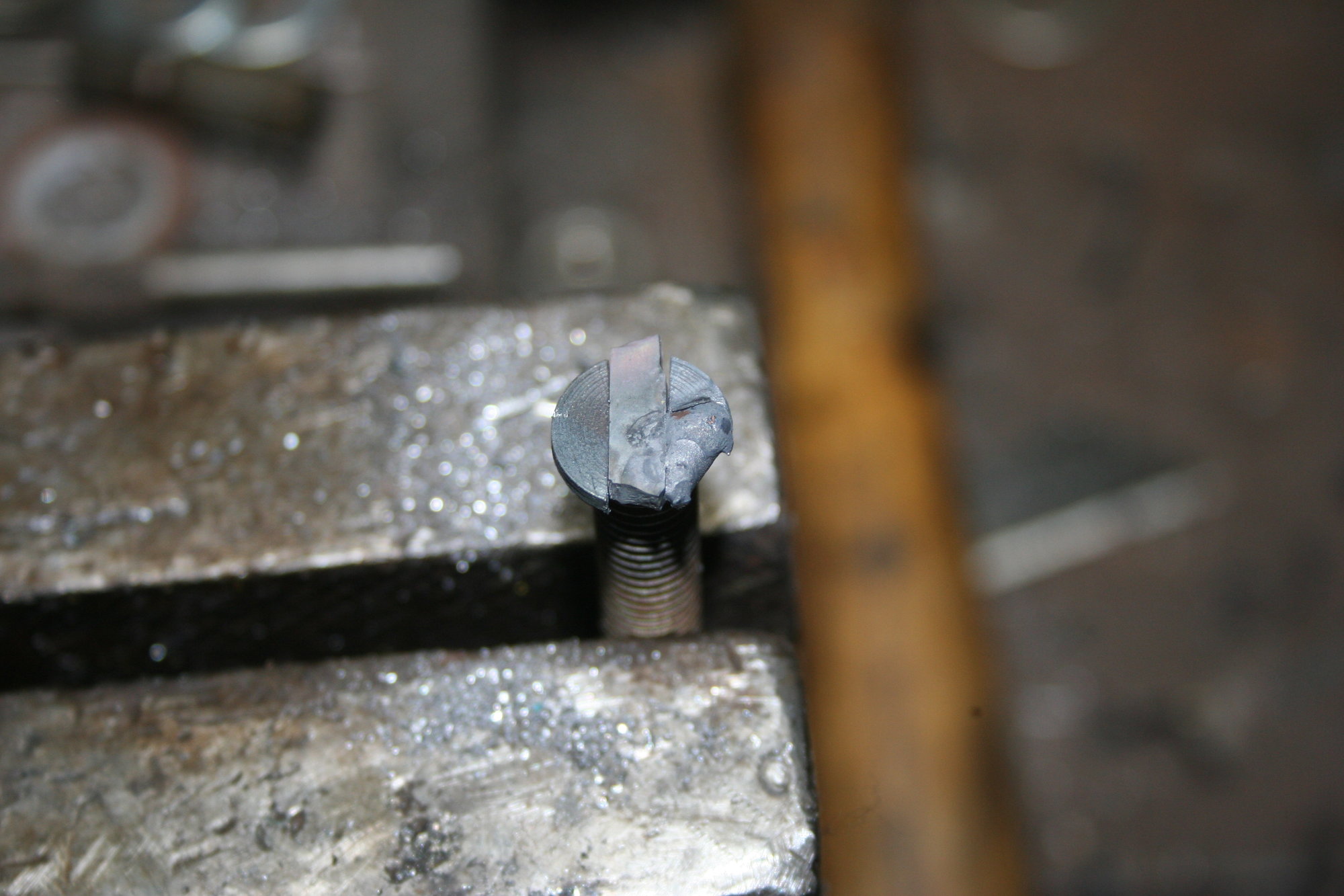

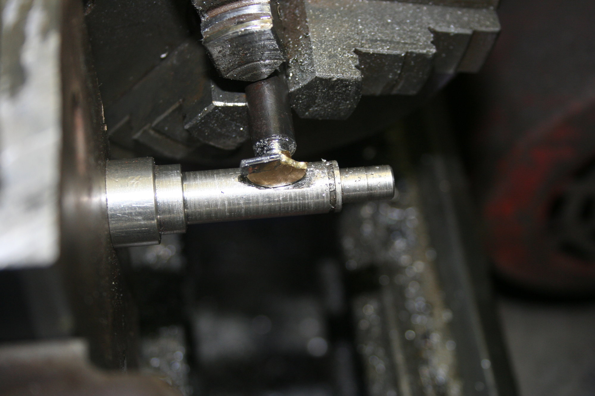

I thought I could get in with an insert cut-off tool but there wasn’t enough back clearance so I brazed a carbide cut-off insert to an old brazed carbide tool that had lost it's tip.
I needed to shorten the insert and boy are they hard to cut, even with a grinder.

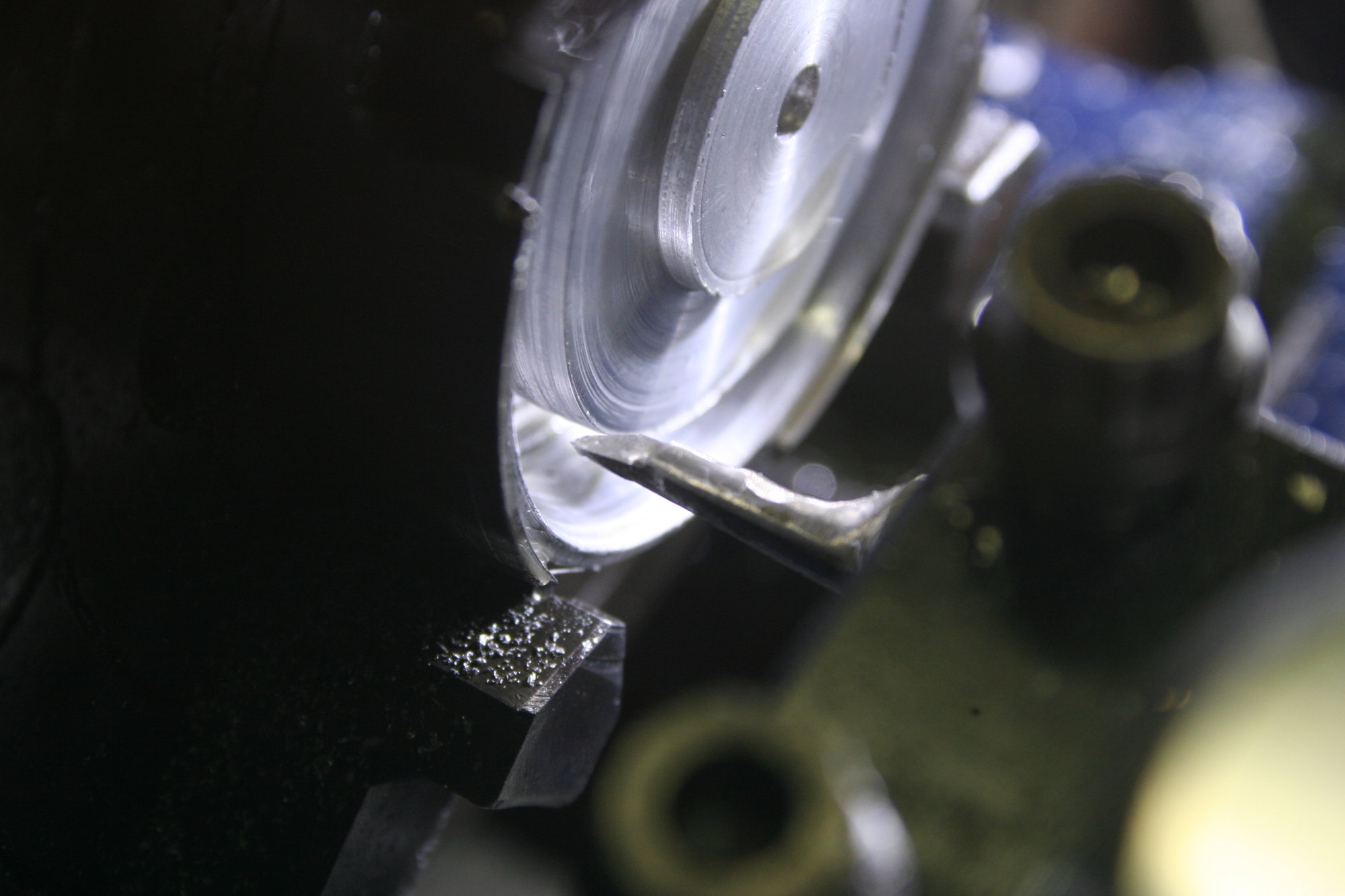

I then ground down a HSS blank to make a tiny boring bar to try and get the left side of the slot.
It sort of worked but was very slow and I still have the problem of cutting out the segments.

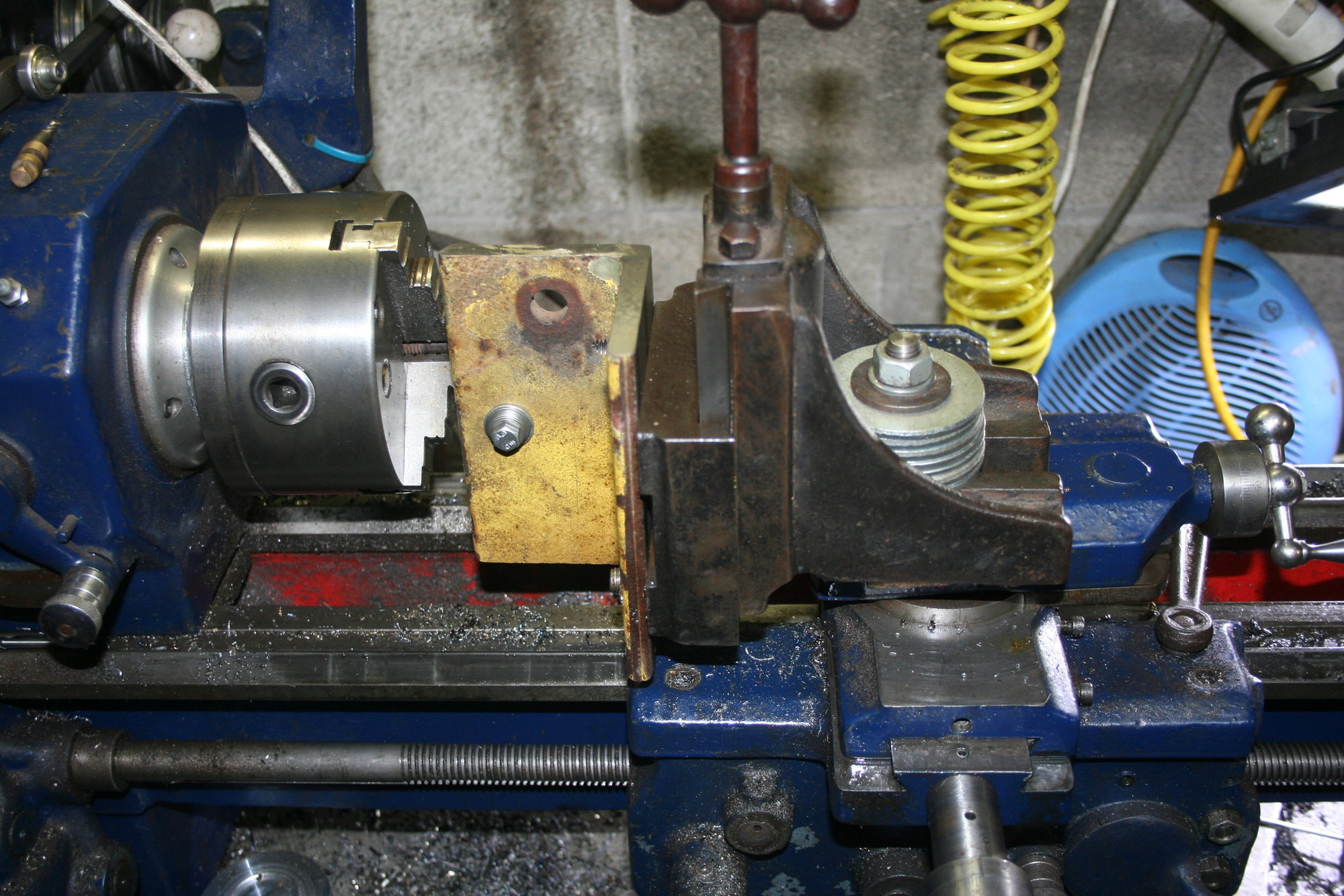

Is there a way to do this on a lathe?
What tools are normally used?
It sort of worked but was very slow and I still have the problem of cutting out the segments. Is there a way to do this on a lathe?
Rotary table on cross slide and mill the slots

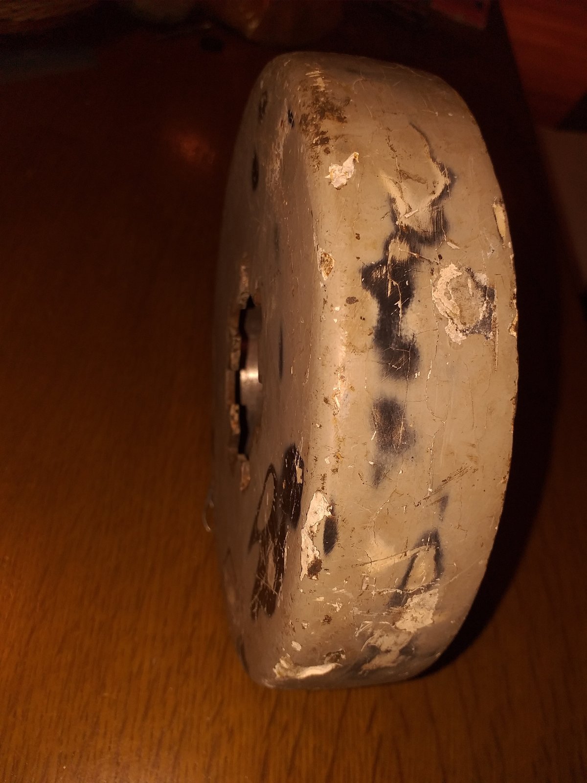

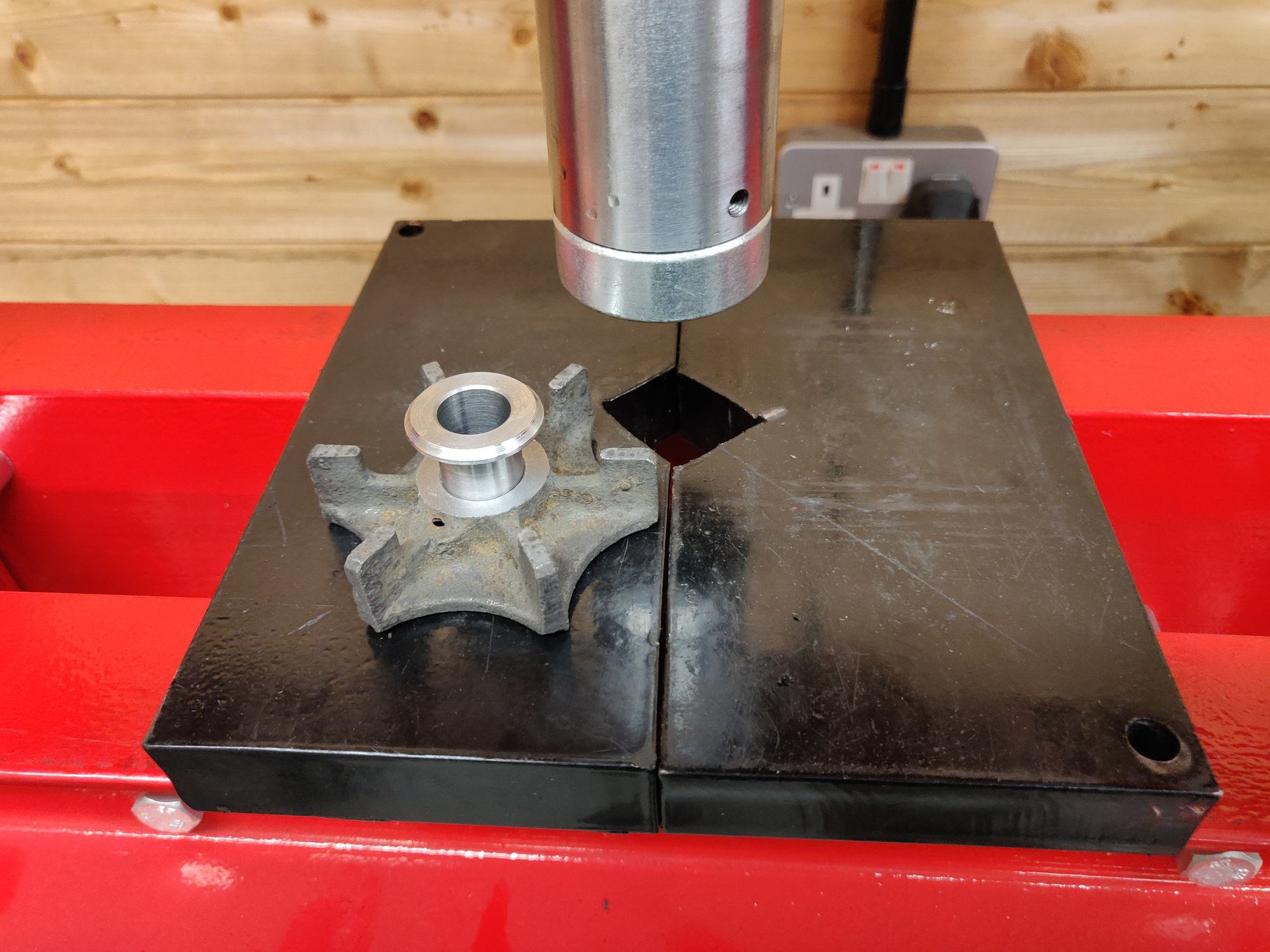

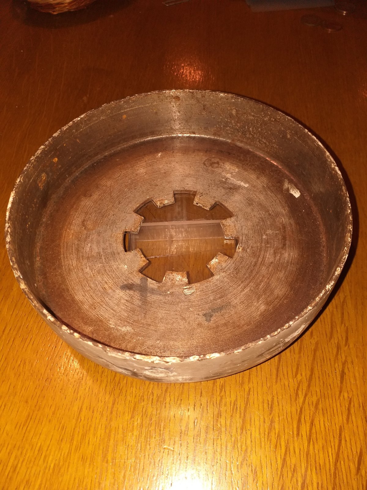

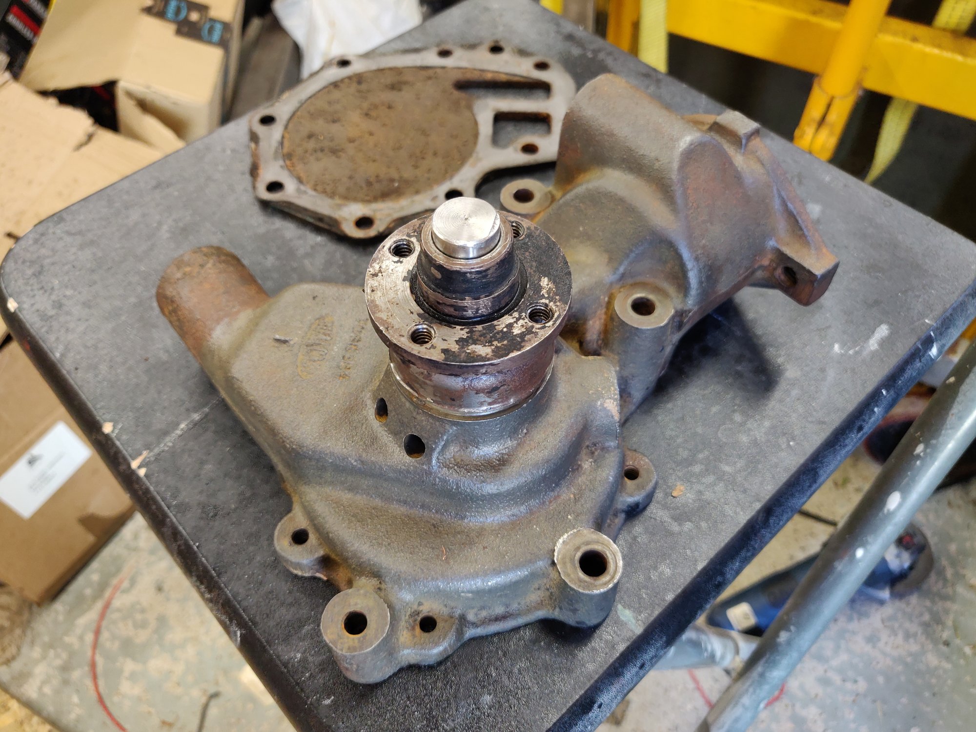

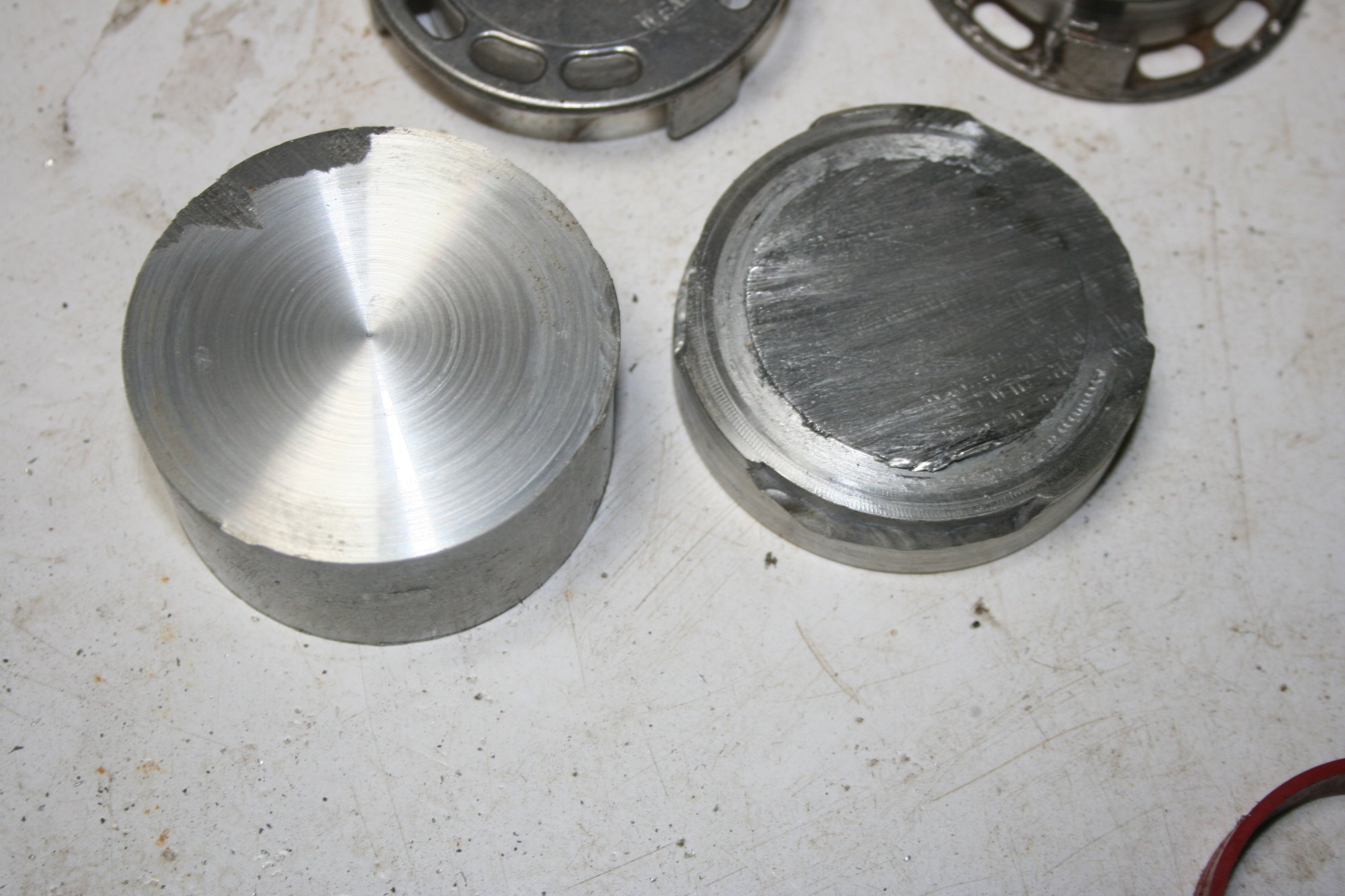

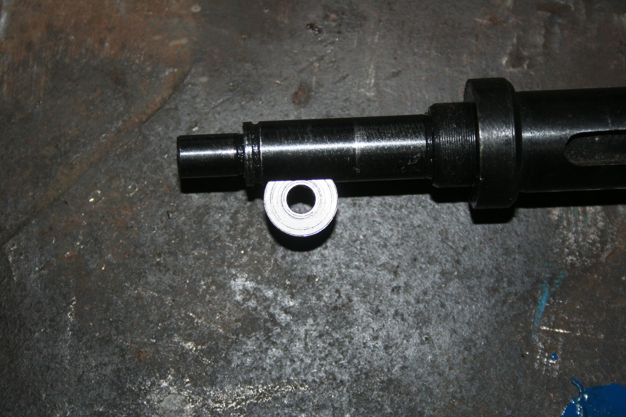

Shrink fit was a failure but thats what big hammers are forI tried to braze but nowhere near hot enough with map. It'll do as is.. quick photo before I ruin it
Done!
TIG will distort it. The heat is too localised.View attachment 278738
Shrink fit did not last, threaded ring has started to pull out, I cant see any cracks.
Knocked it back into place.
I remember mapp did not have enough heat to braze this last time, might try with tig!
