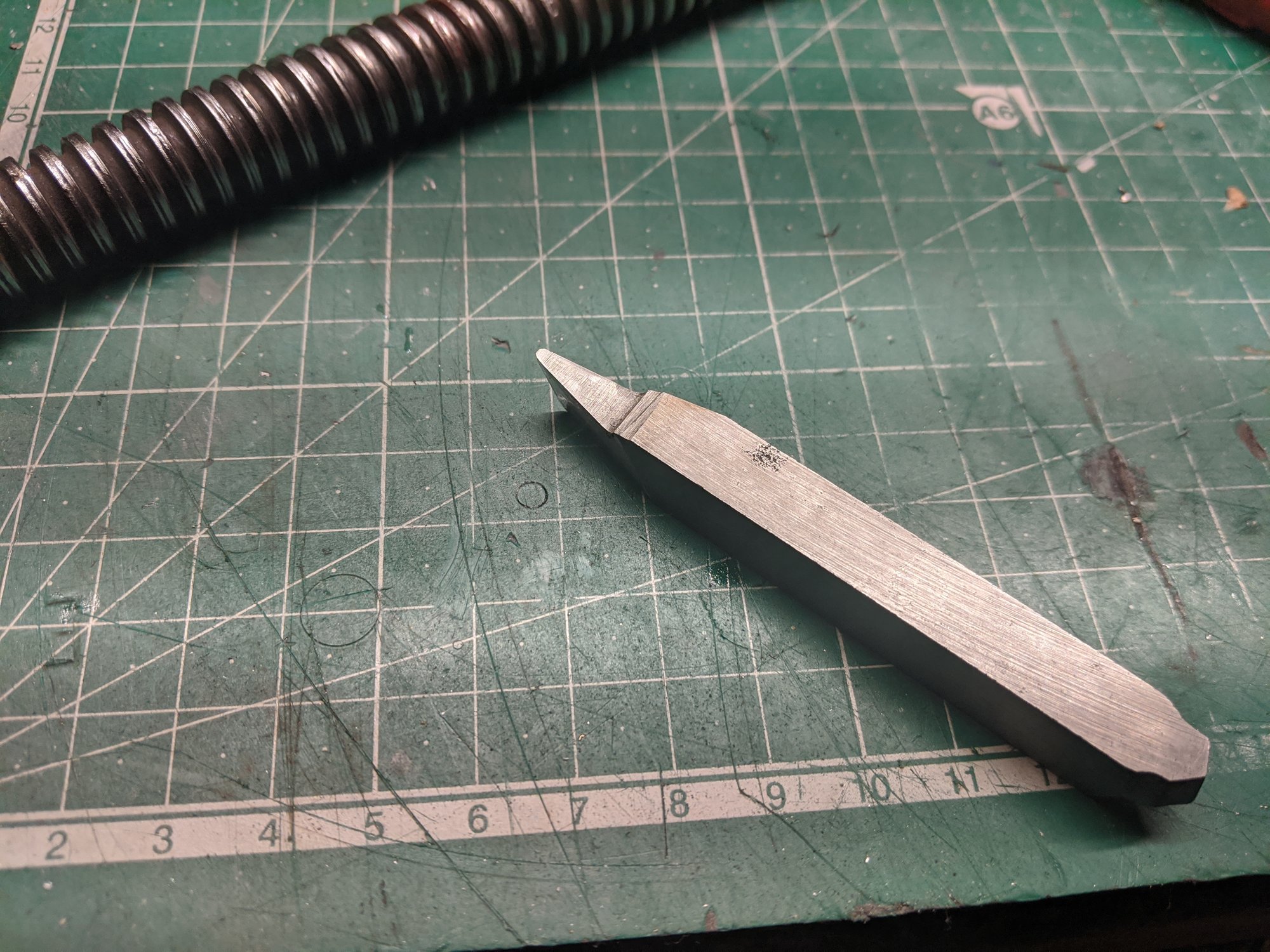

Anyway the 14TR2 thread not perfect. I did not bottom out the insert as I thought I was past full depth, so I think it needs to go back in for another cut. The split nut is tight (on and off) normal way round. If I put it on split end first it is free spinning
Marker pen rubs off the root.

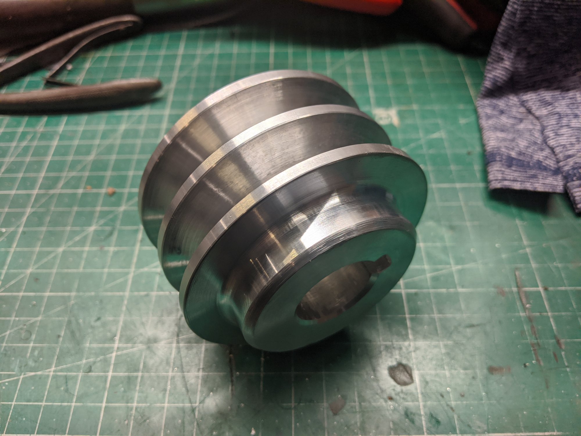

What’s a edge tailstock alignment bar?It came out perfectly, en16 is a lovely material.

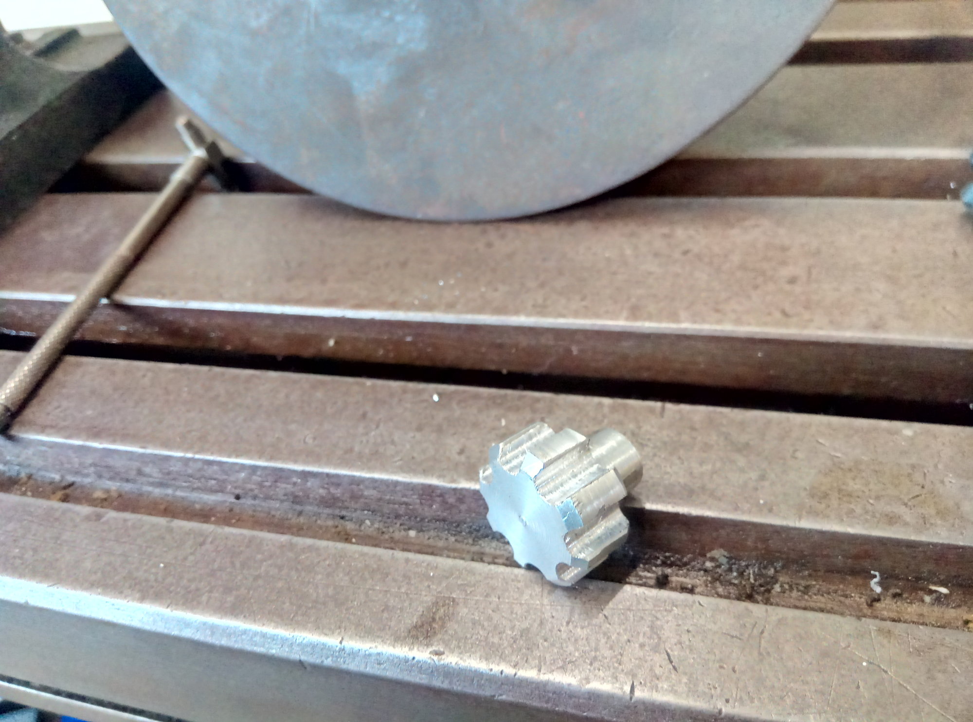

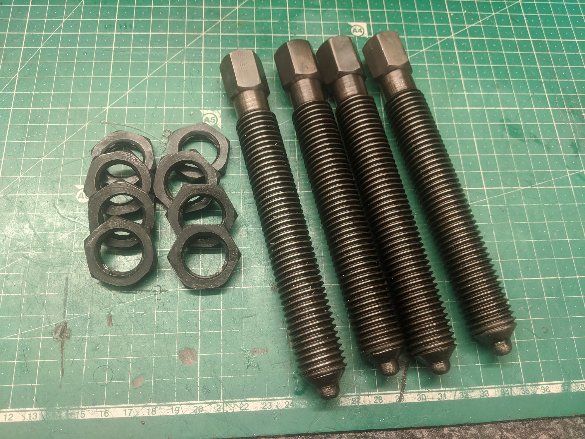

What stock did you use? I haven’t got my mill working so can make a hex.
