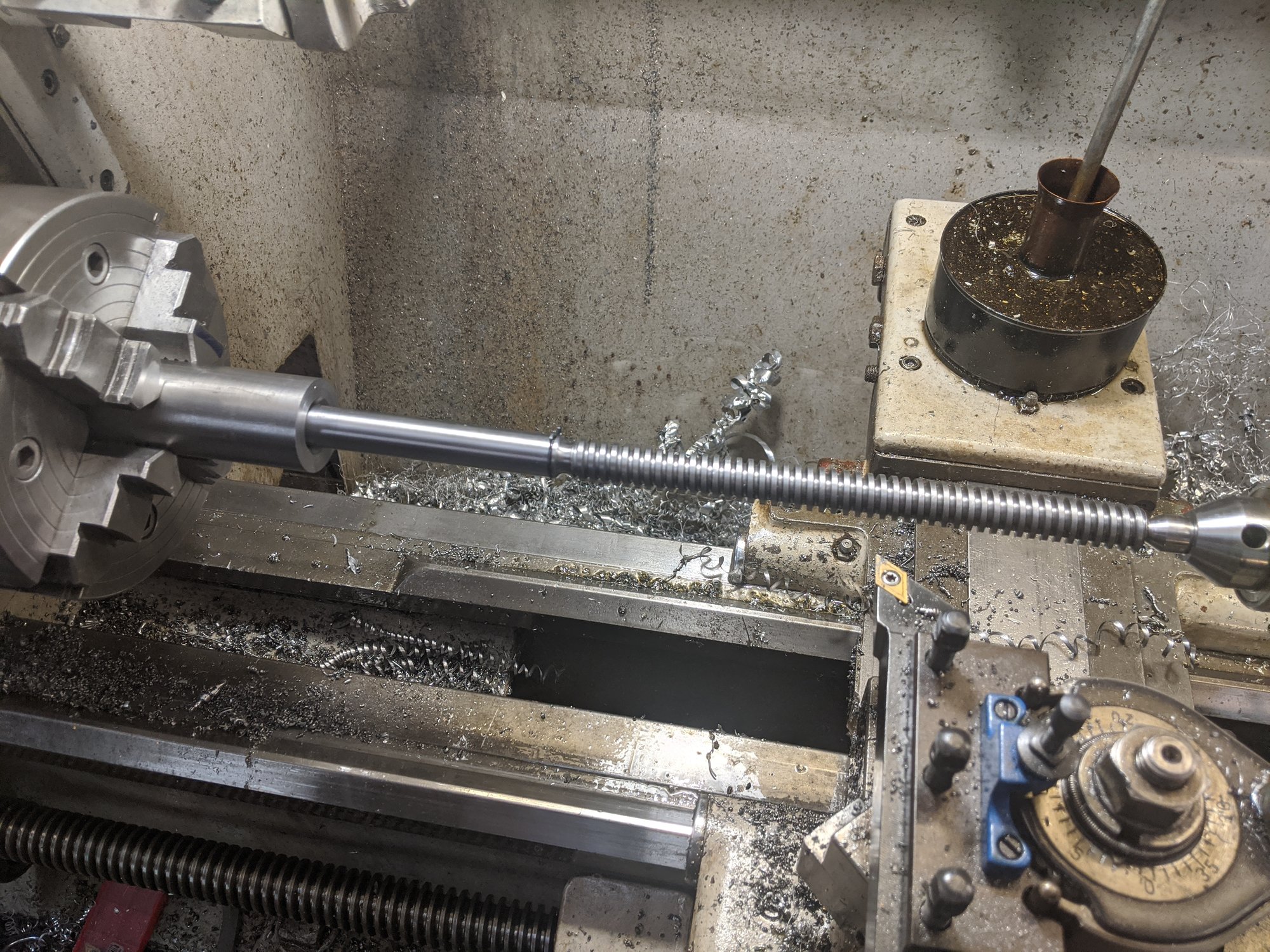

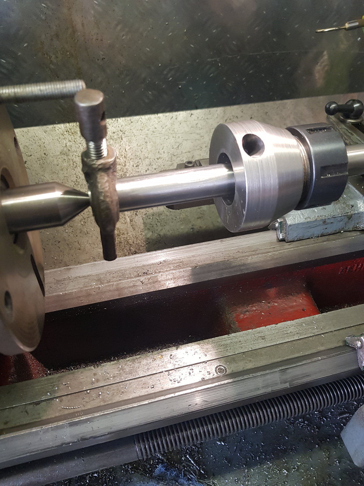

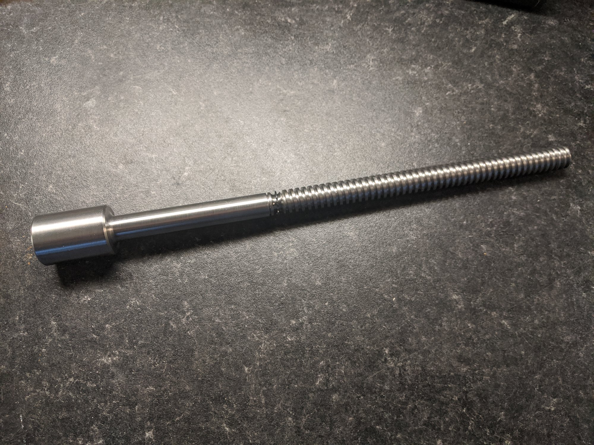

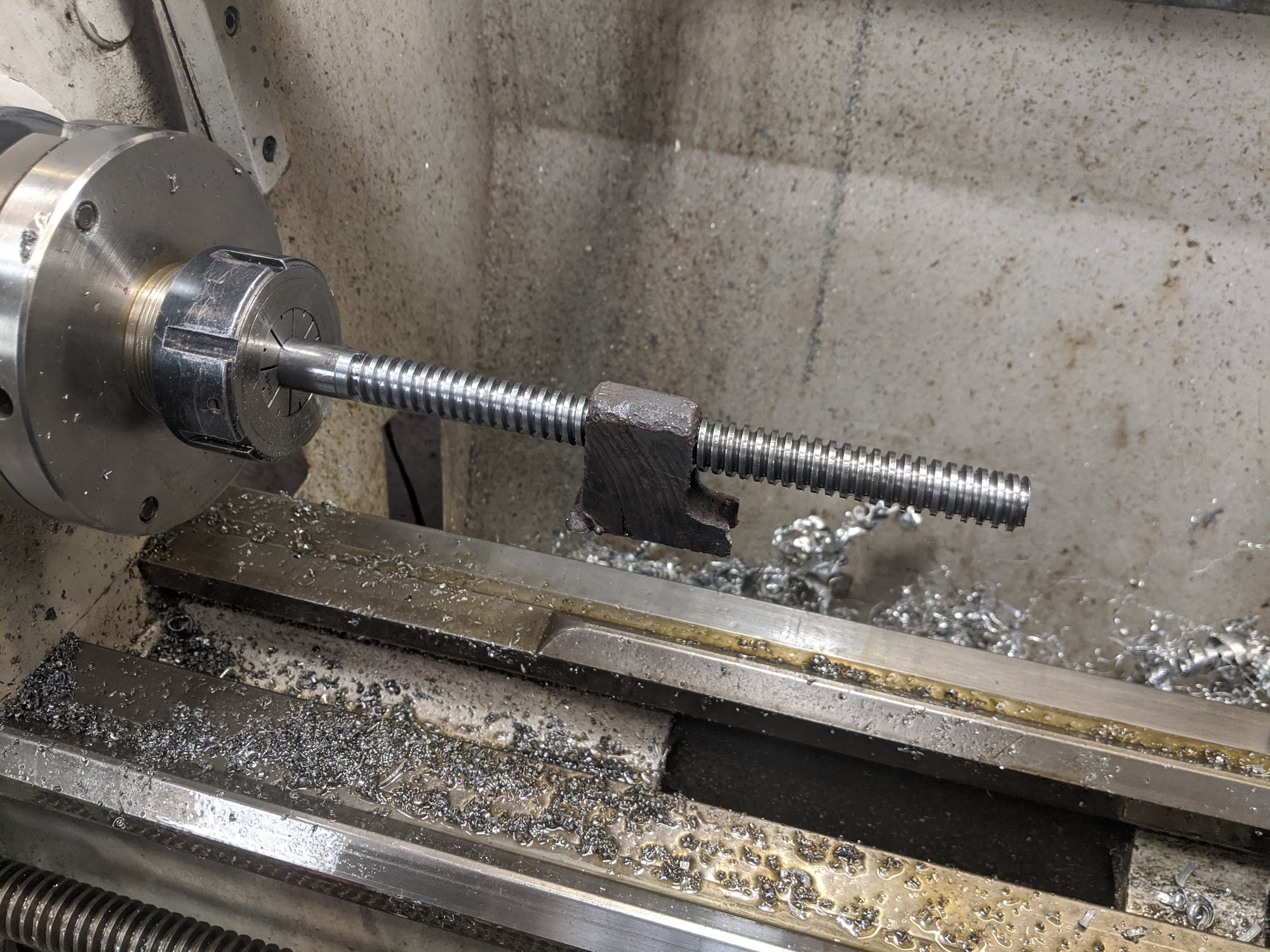

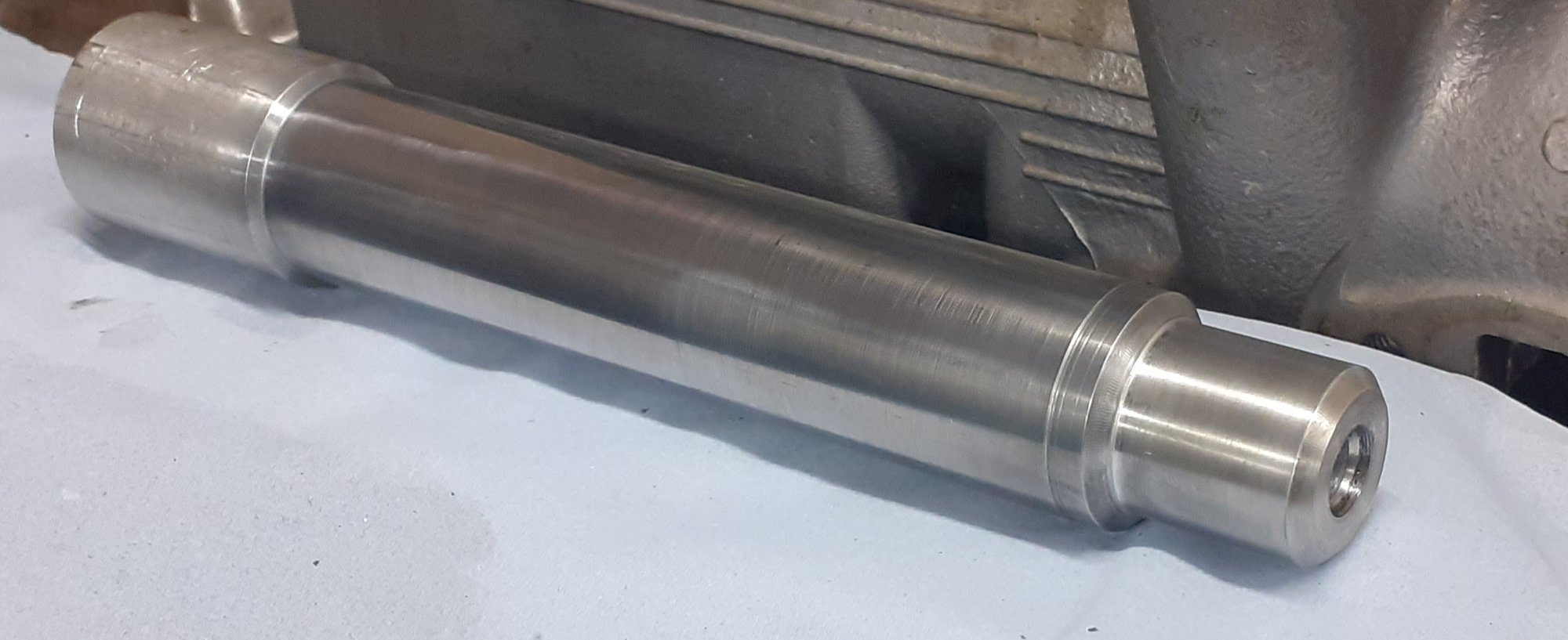

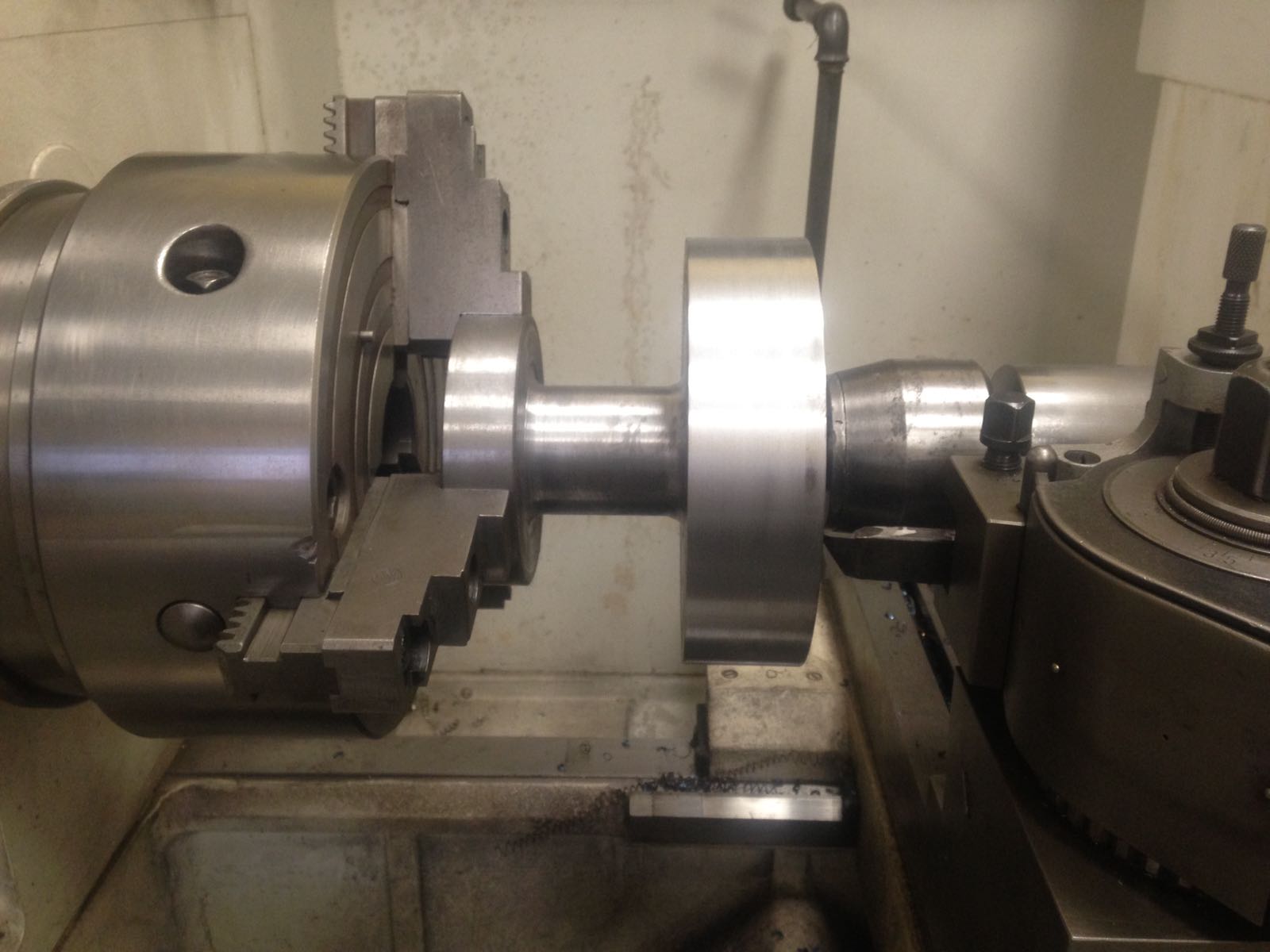

Vice screw for @qwakers, EN16T. M16x4 trapezoidal. First proper metric thread cut on this machine.
Discovered today that the travelling steady I have is for a 9" L5....something else to make, it cut just fine anyway. Fits the nut lovely

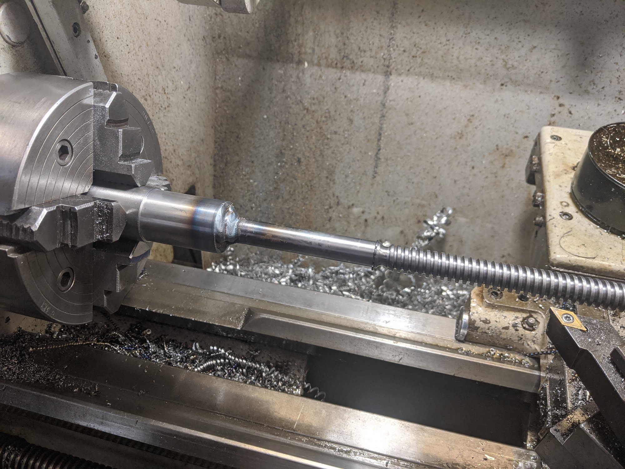

Pressed the screw into an end for the handle and cut a nice groove for welding.
Welded up (not on the lathe)
All done, very happy with it.
thatll do very nicely thanks dudeVice screw for @qwakers, EN16T. M16x4 trapezoidal. First proper metric thread cut on this machine.
I’ll get you some measurements off my steady if you like.Vice screw for @qwakers, EN16T. M16x4 trapezoidal. First proper metric thread cut on this machine.

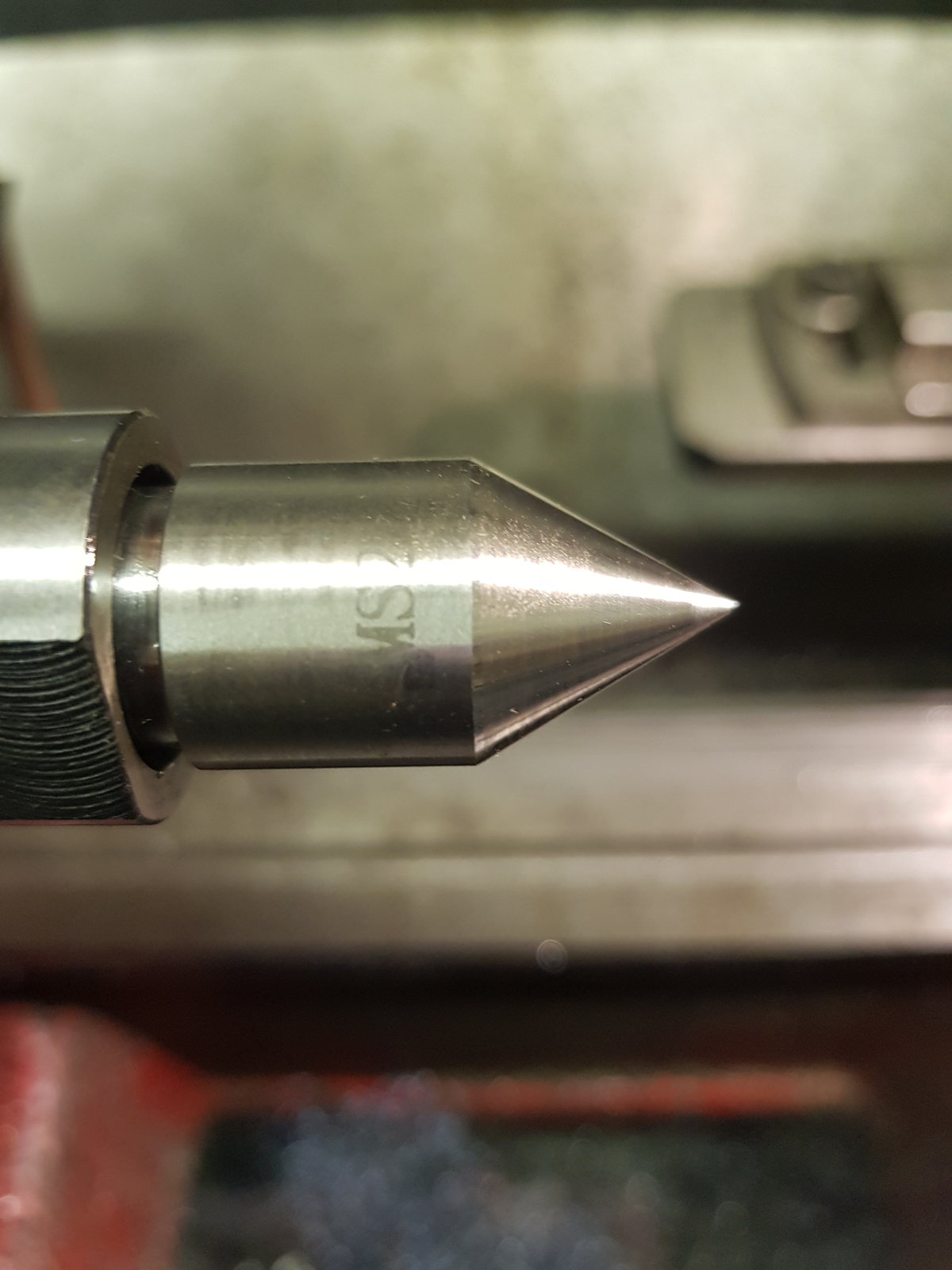

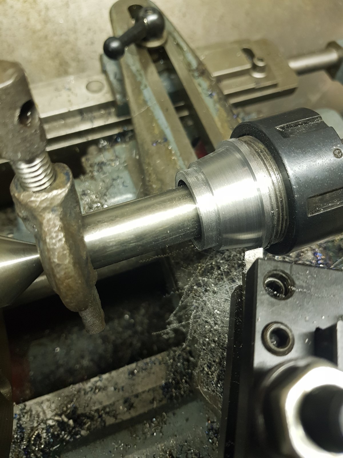

...Why dead centres never have a tang (at least not the ones I own or have ever come across) beats me. ...
Well you never know, can't say I recall a lathe that doesn't, well except my CNC lathe but that is only because Churchill decided to fit a hydraulic cylinder to it with no ejection methodI wouldn't have bothered with the groove if it did

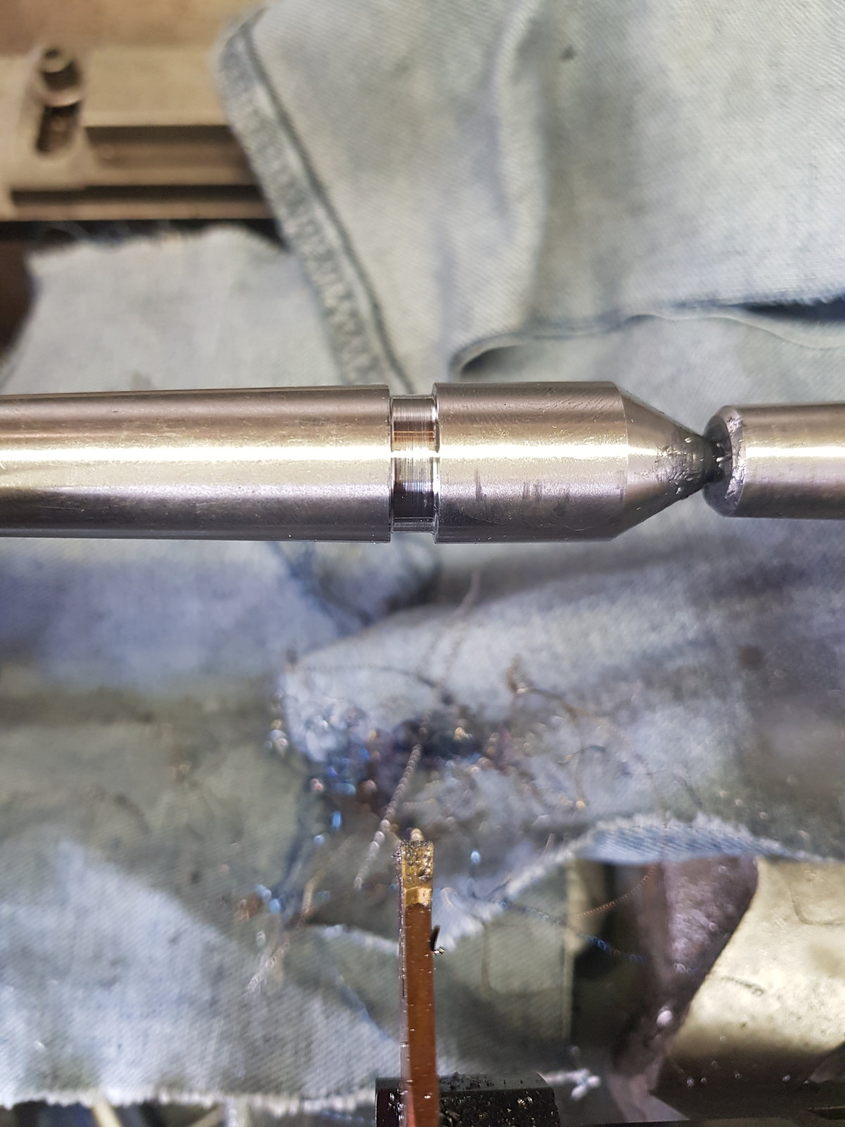

Here it is with a threading style tool
Side clearance only.
From top
Add some top rake
View from the top, dotted lines showing original angle.
I wouldn't, I use insert tooling but on the odd occasion I need a special thread form then I wouldn't bother with top rake.Makes perfect sense. So would you grind it making an allowance for the combination of top rake and side clearances?
Again for amateurs like me...
I suppose that it's possible that the feed screw has been shortened sometime in the last 57 years, and I certainly don't have any recollections from my school days when I was using Boxfords.
It's always been like it, so I assumed that that's how it should be.
Just roll a ball bearing or two down the hole before putting the centre in.
Very tidy looking threadVice screw for @qwakers, EN16T. M16x4 trapezoidal. First proper metric thread cut on this machine.
