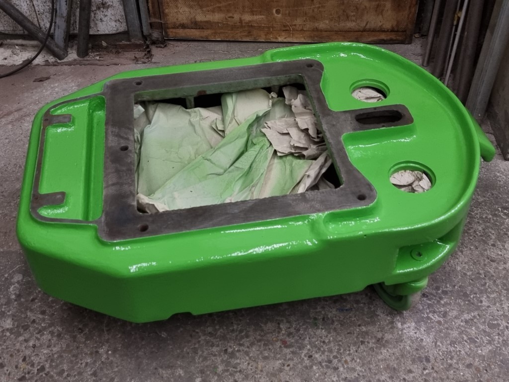

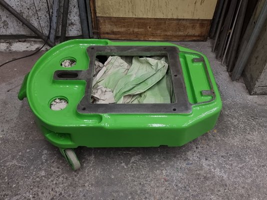

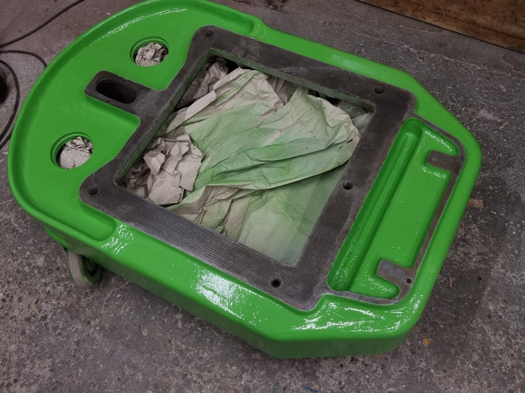

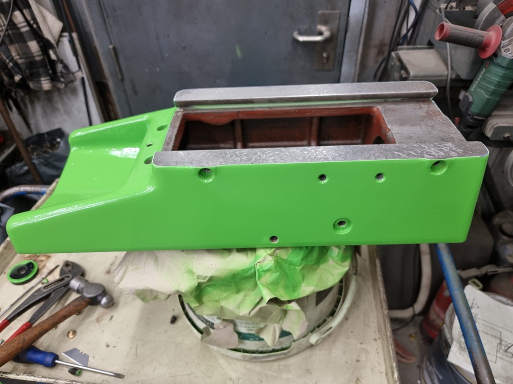

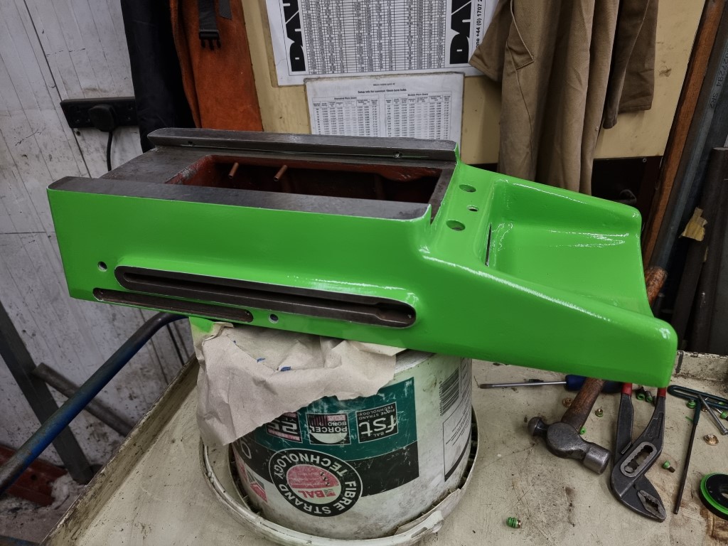

Kermit? It isn't easy...What colour is it actually called.?
Back in the day most sand castings used in engines gearboxes or machinery were treated to a heavy coat of glyptal to seal the surface, without this sand would leach from the surface turning any lubricant into grinding paste. This was also red in colour.red lead appears bright orange. Its color cannot be confused with anything else. The photo mill shows ordinary iron oxide + linseed oil.

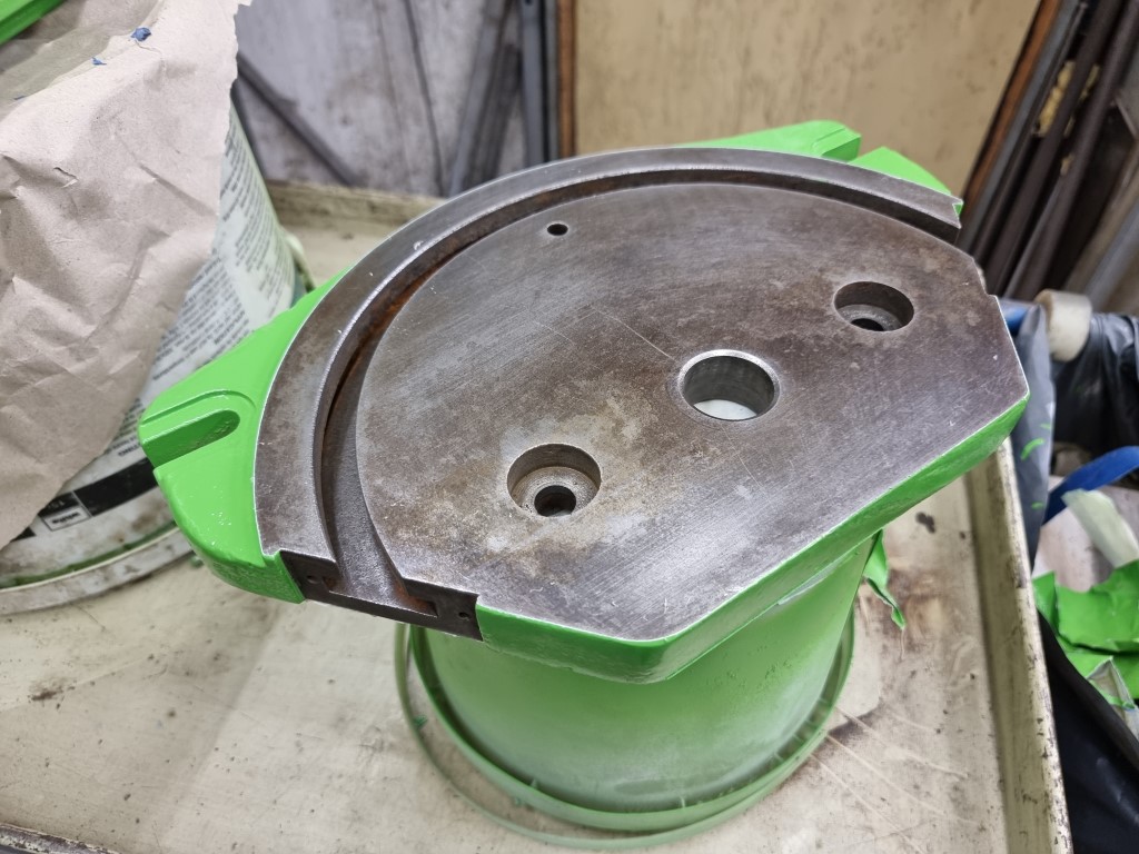

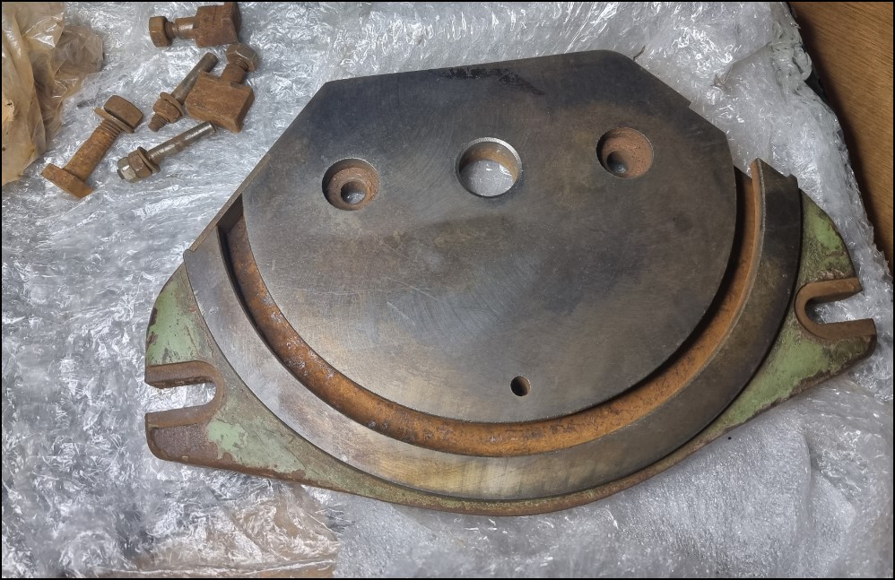

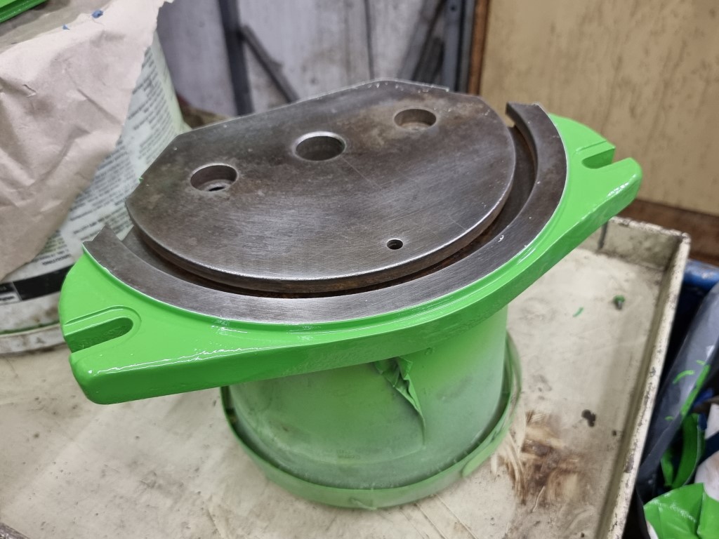

What a guy he is Pete, very good of him. Try get him on hereToday I am a happy bunny I got home to find my missng part, which I found a replacement for in Slovakia, had been delivered
This means I can now have a choice of fitting either the fixed table or the tilting table as required. A very generous guy in Slovakia drove 140km to collect this for me, stripped off the parts I did not need to get the weight down and wrapped it up for collection, and he wouldn't take any money for doing it either. It just goes to show that like-minded souls exist all over the world.
Karma does come back sometimes..Today I am a happy bunny I got home to find my missng part, which I found a replacement for in Slovakia, had been delivered
Is that the part you were making the former for to have cast?Today I am a happy bunny I got home to find my missng part, which I found a replacement for in Slovakia, had been delivered

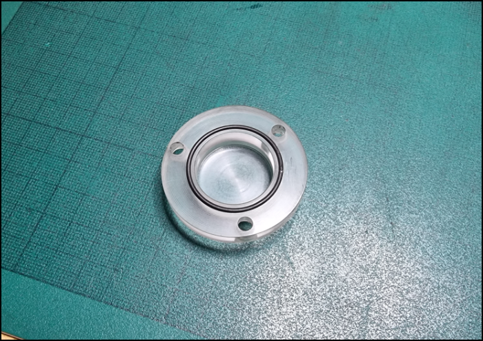

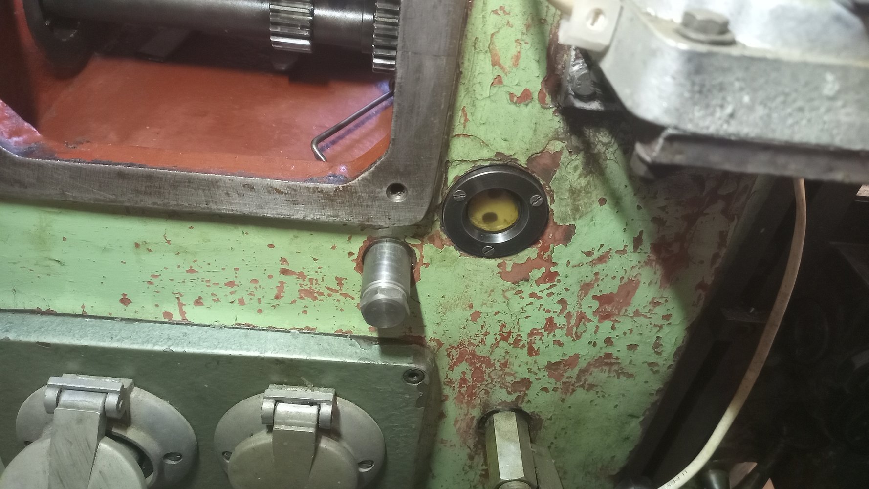

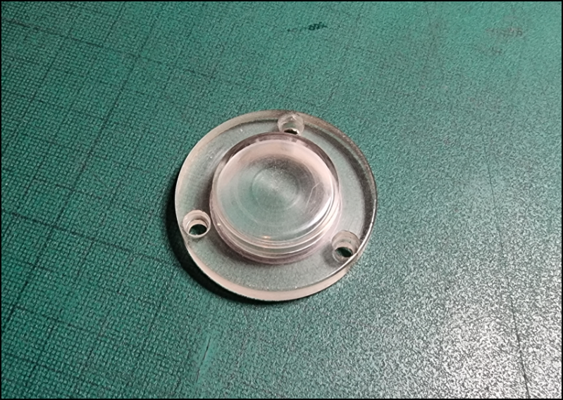

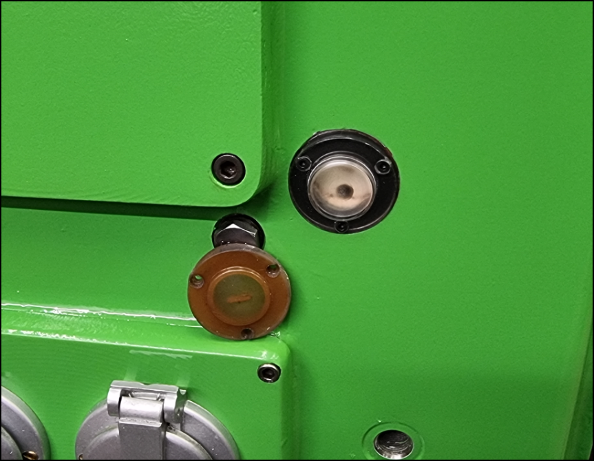

Nice! Mine has a flat acryl screen, and a steel plate what pushes it to the frame. That O-ring seal is a grat idea, I might disassemble it, as if I can install one too.I had to re-make the oil sight glass. Well, plastic as it happend but the old one was rotten and deformed so I turned one from acrylic. I put an o-ring on the mating face but when I fitted it up it looked ugly because you could see the rough-looking mating face behid, so I ened up fitting it with some RTV as well as the O-ring.
Pic of it fitted along with the old one for comparison.

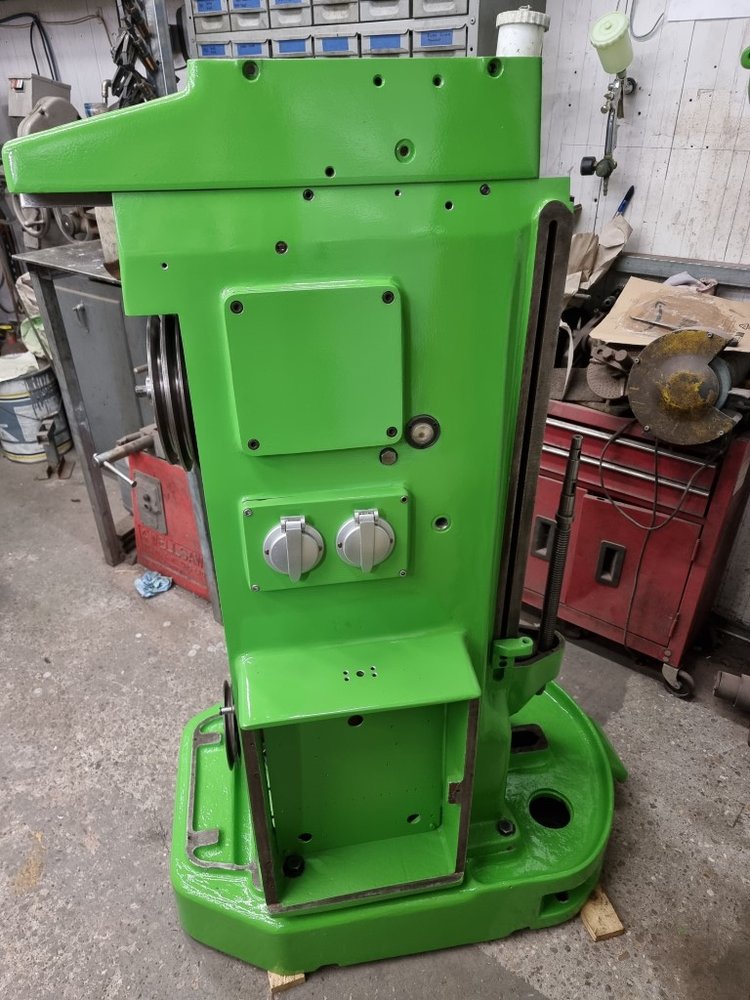

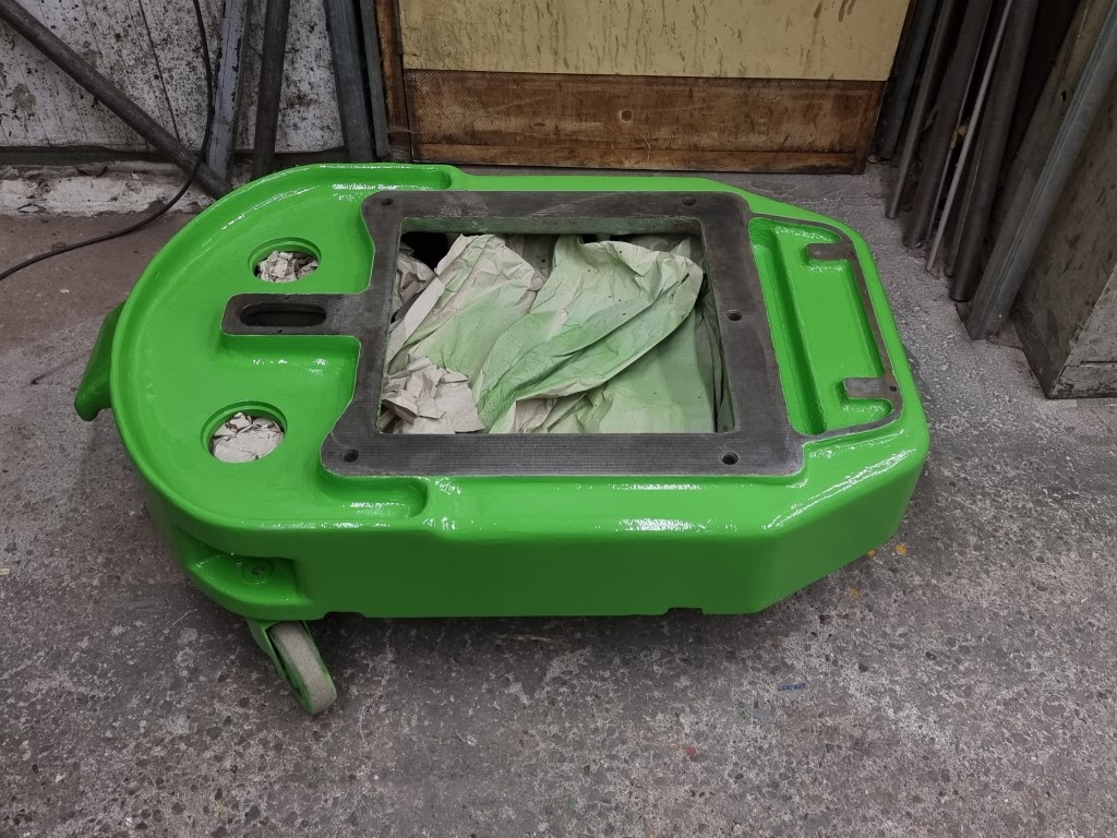

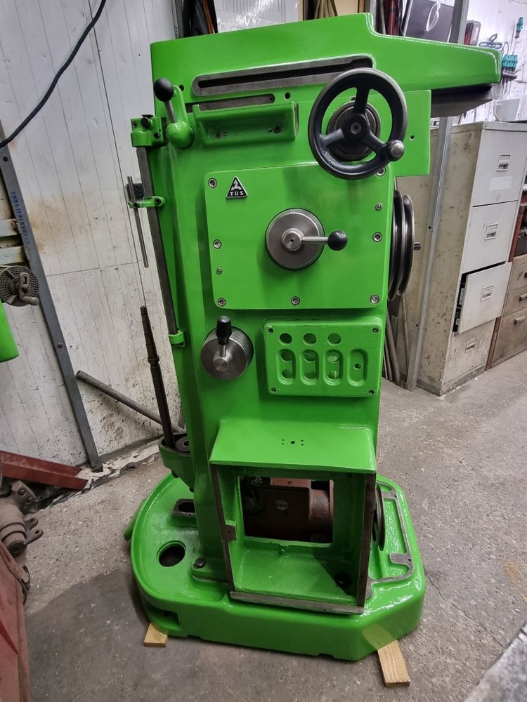

Will a cap head bolt slip in Pete? and you could go even further by taking a bit off the head in the lathe tooMotoring right along now. I lifted the base off the floor with my swing crane and removed the castors then let it down onto timber battens. Then I wheeled over the main column which by now weighs a good quarter of a ton, slung the front on the crane, pulled the castors off the front and rolled it over the base casting, then let it down and removed the rear wheels. A bit nerve-wracking but it went without incident. So I bolted it down and then cleaned the masking tape and glue off the top slide and slid tha into place too.

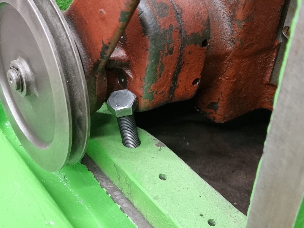

Well, I say I bolted it down. Previously I had fitted the feeds gearbox, the vertical feed rod and housing, the y-axis feed gears and screw, the selector mechanism all into the column. Well, seems I failed to spot this:
So I have to either dismantle all of the above again just to loosen the feeds gearbox enough to get this bolt in, or take a chance at popping the cover off that fully-sealed auto reversing box and wrestle with the fly-apart sprag clutch needle rollers trying to get them all back together and oil-tight when it was frustrating enough doing it on the bench.
Ah well, can't win them all![]()
No, but I've been thinking I could cut the head off this one, thread it into the hole and use a nut.Will a cap head bolt slip in Pete? and you could go even further by taking a bit off the head in the lathe too
There you go mate..sortedNo, but I've been thinking I could cut the head off this one, thread it into the hole and use a nut.
That’s EXACTLY what I was going to suggest!No, but I've been thinking I could cut the head off this one, thread it into the hole and use a nut.
