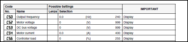

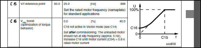

Well actually I spent some more time in it yesterday evening. It seems that it will run indefinitely at anything above 30hz, but at 20hz the drive gets warm and shuts down after a fewmnutes and at 10hz it does't run for long at all. I might persevere with it as it is for the time being but keep a spare motor handy.

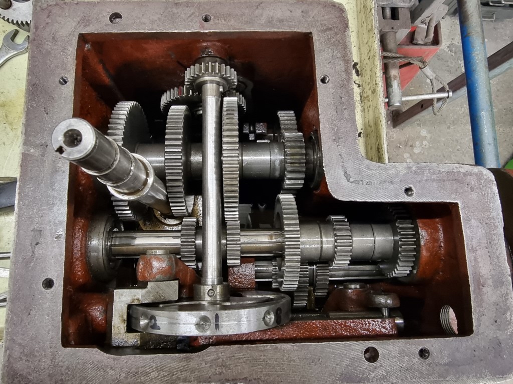

During my experimenting I have also fount that the speed settings on the feeds gearbox are not correct so it loooks like I have assembled it wrong. I don't quite know how I have managed that but it's got to come back out, which handily solves the problem of the botl that won't fit.
