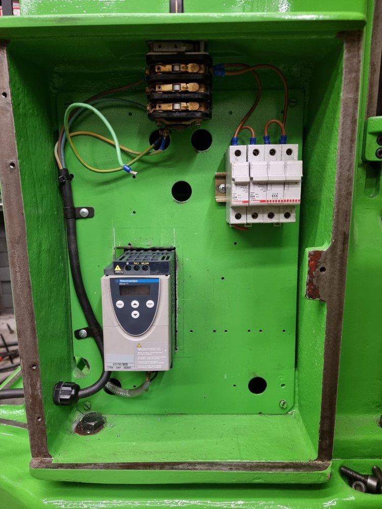

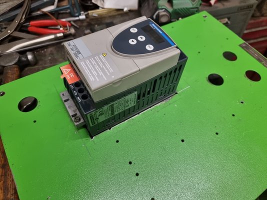

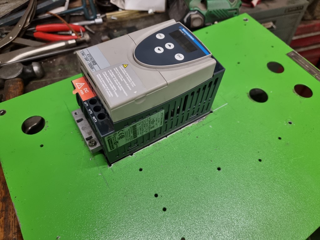

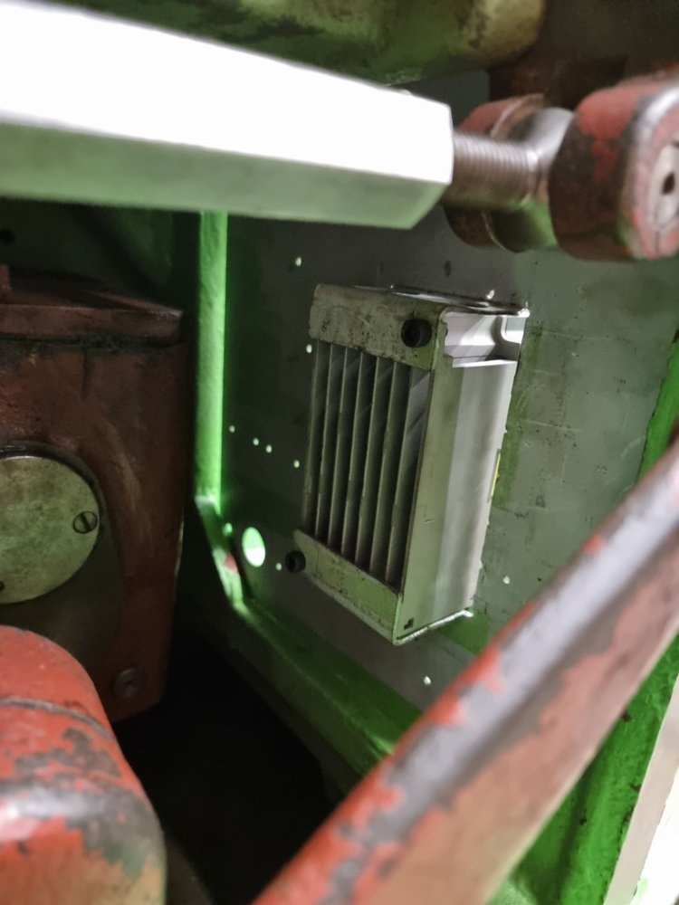

I got resistors Dave, and it does have the facility to connect them. I understand the principle that causes the overvolt but I'm surprised at how easily it trips at that particular frequency band especially with so little amps drawn. I also have the option of invoking s-curve accelleration which should also calm the voltage spike a bit.
