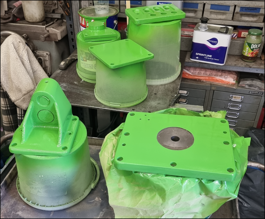

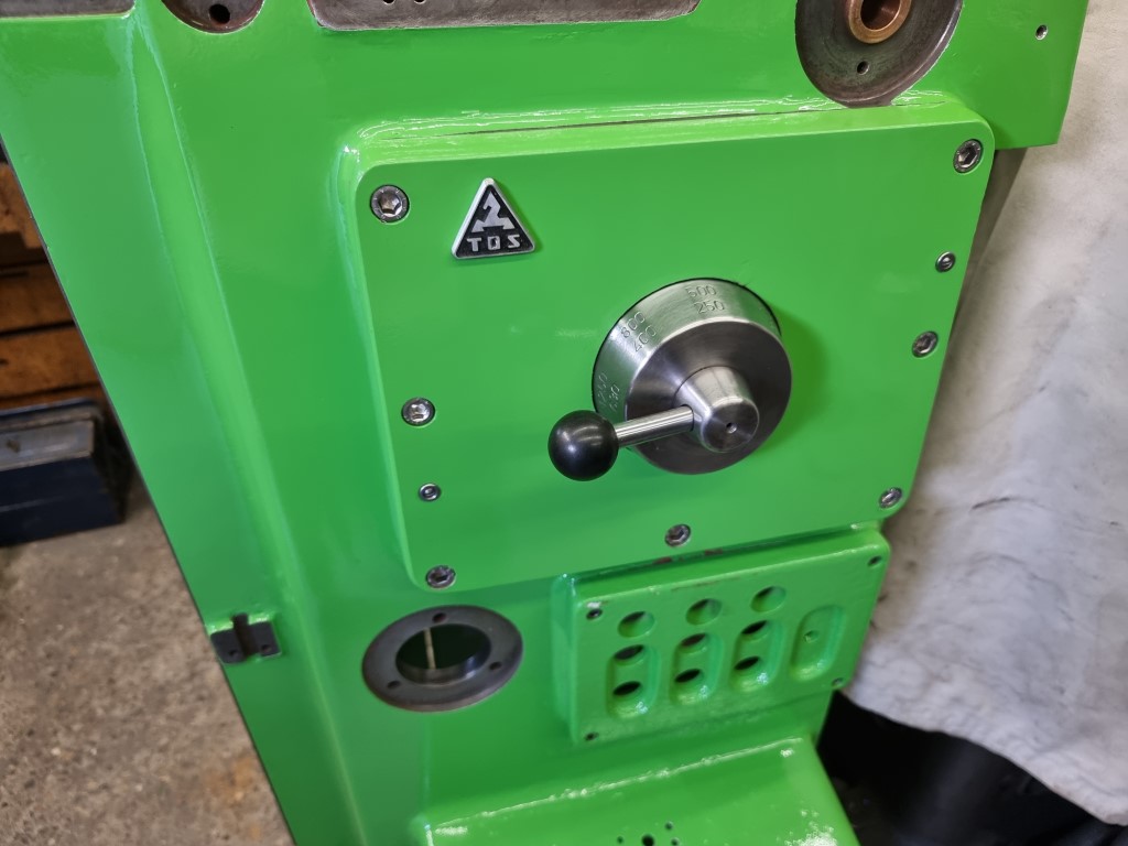

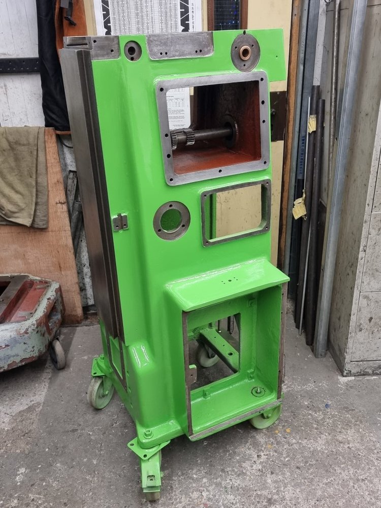

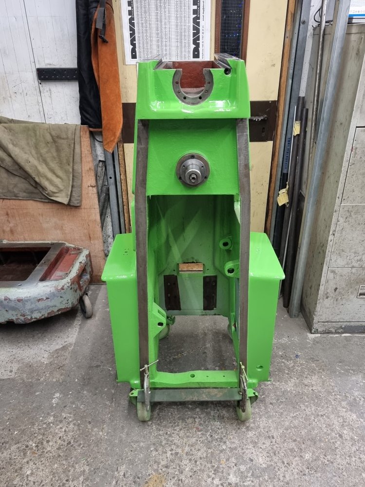

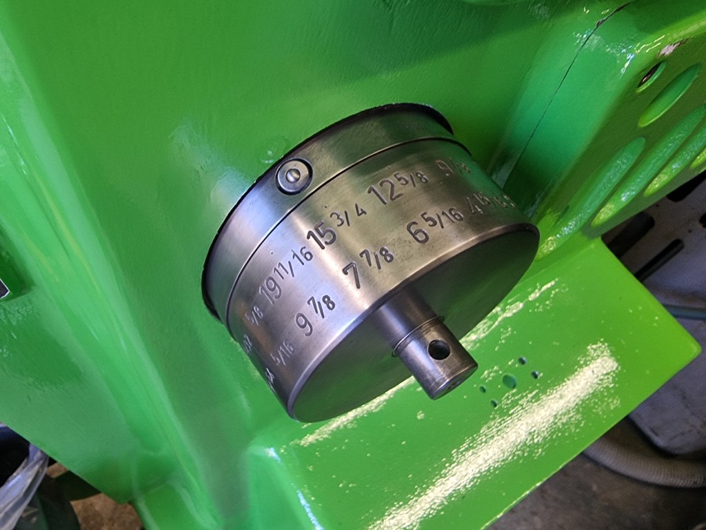

Beautiful progress! That gearbox.. is heavy AF..I painted some more bits Friday evening. Gearbox cover, button plate, z-nut housing and a couple of other covers and bits. This allowed them to harden over Satuday as I was working.
I paint them outside in the alley sat on plastic buckets so I could turn them around to paint all sides and then carry them inside afterwards.

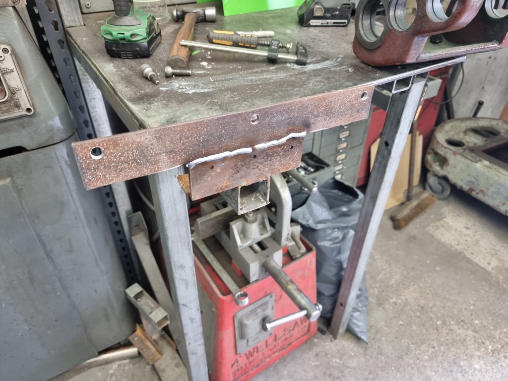

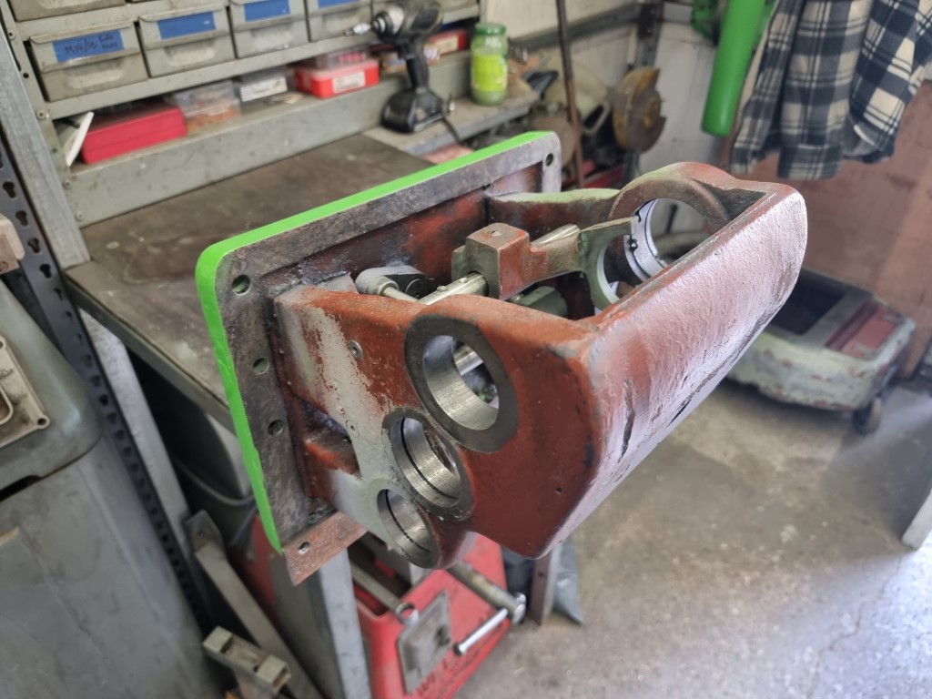

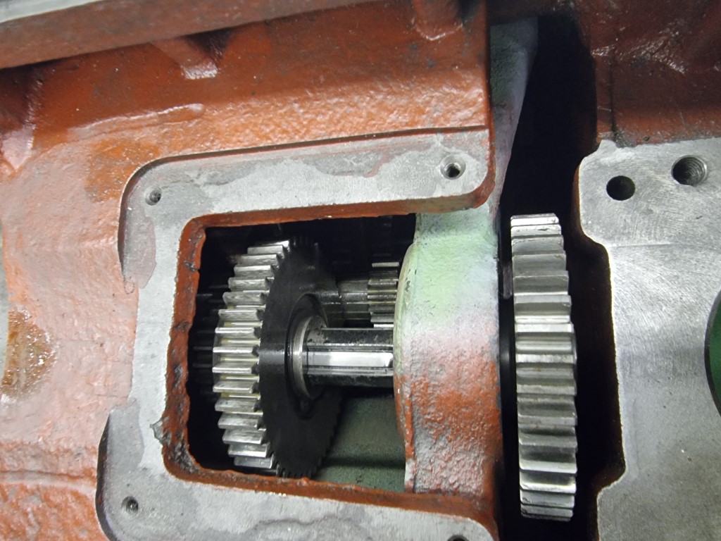

Today I wanted to rebuild the spindle speed gearbox which has 3 shafts with gears and 3 selector forks working from a single speed dial. This item is damn heavy even without the gear cluster fitted (probably 30kg), plus it was already painted so I needed to hold it in such a way that I could fit the gear clusters and selectors without damaging the paint. I fitted two box-section tubes under my bench for just this kind of thing so I made this bracket from scrap.
And the gearbox plate/housing bolts to this bracket holding it nice and secure for me to rebuild it with new bearings etc.

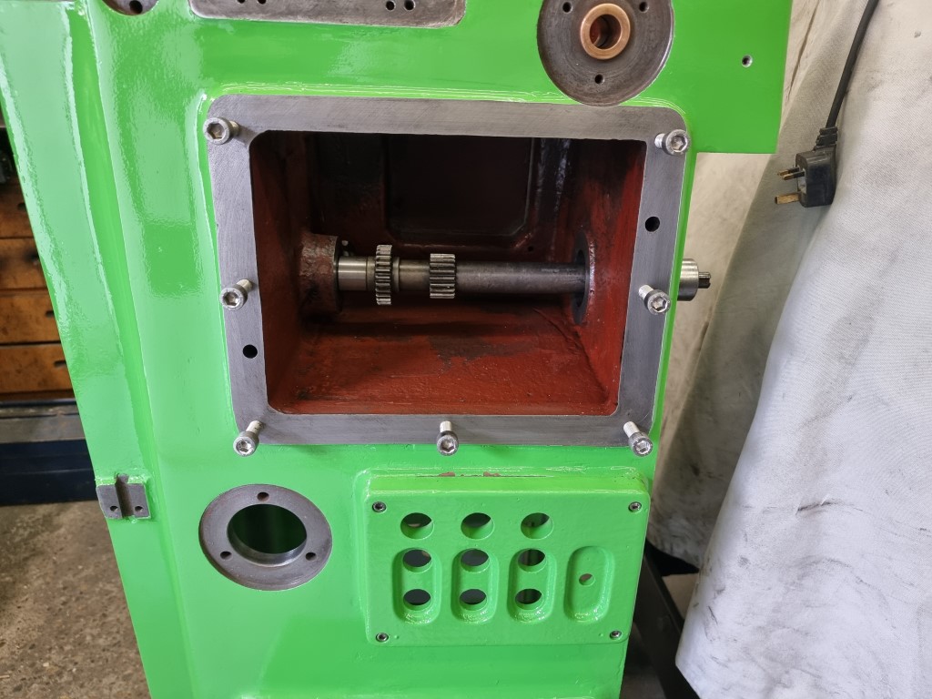

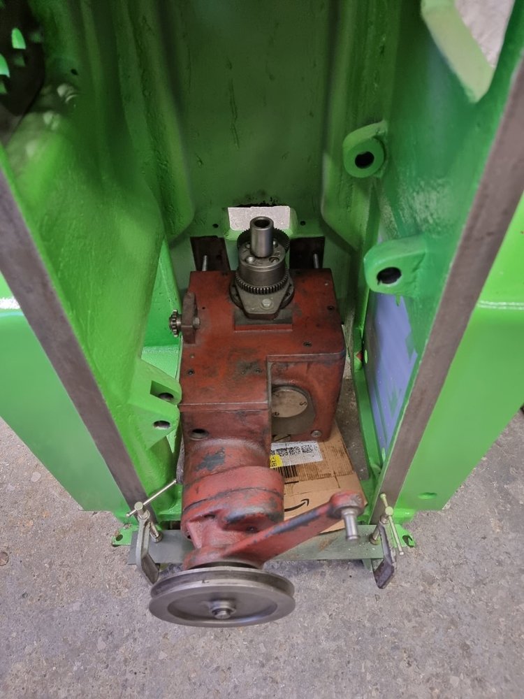

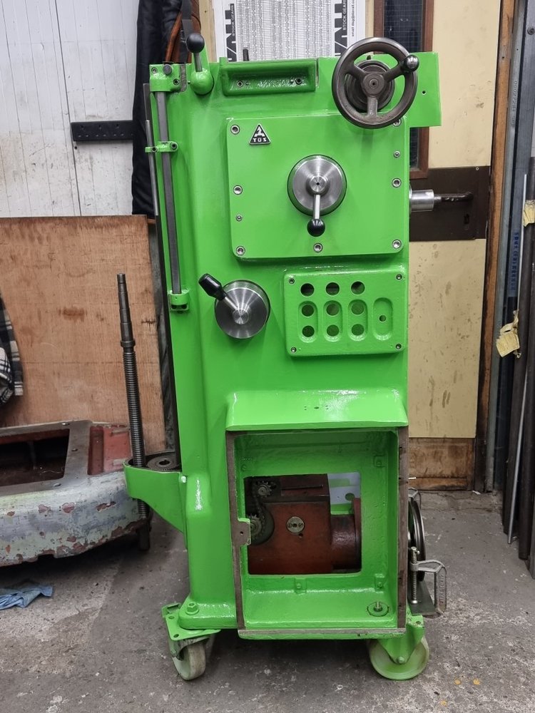

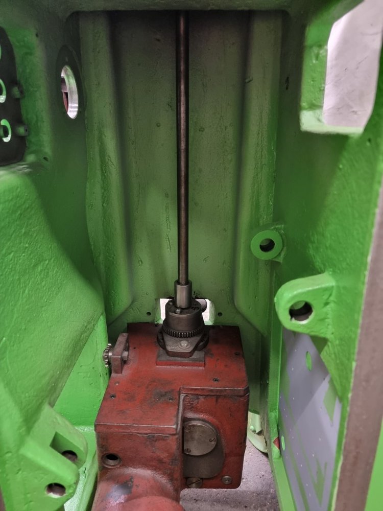

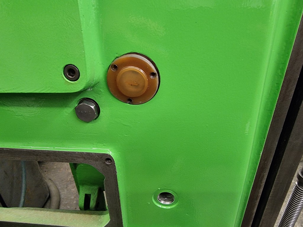

I got the whole gearbox assembled with it's new bearings, but alas the pic I took was blurred so not worth posting. It plugs into this hole here and engages with the input shaft you see.

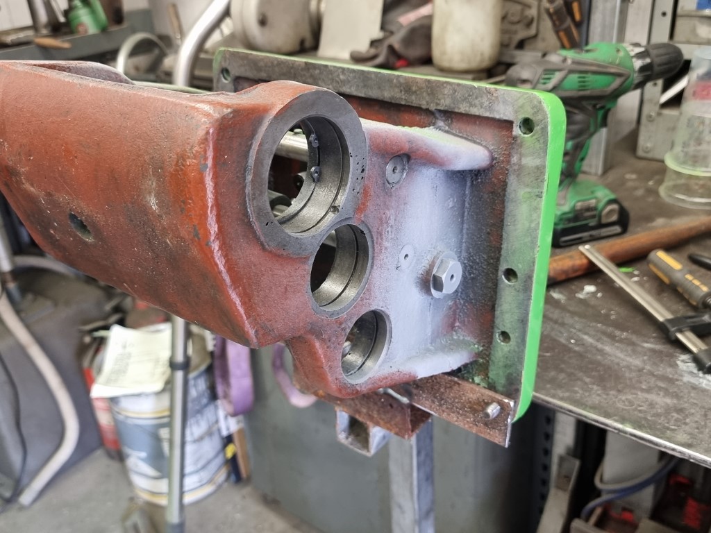

Unfortunately I didn't think to remove the button plate before trying to fit the gearbox and found out that even though the bracket provided a great way to hold the now 40-odd kilos of iron and steel it also took the paint off the edge of the button plate so I'll have to re-do that later. You can also see where some of the paint has chipped away with the masking tape, I've been having a constant battle trying to get stuff to stick to this 1960's red filler, I dread to think what is in it so I've been using my dust vac on the DA sander the whole time.
Eventually I got the button plate off, the gearbox fitted then the button plate put back on. The gearbox is secured by these 7No M10 bolts and two taper pins.
Here you can just about see the clusters before I put the cover plate on and the output gear is the one on the right which meshes with the idler on the next assembly.
You know what @Pete. that green colour has really grown on me! Seeing a few odd bits and pieces in your workshop I wasn't so keen, but now you have more of it done and it's all coming together I really like it - I think it looks great!I painted some more bits Friday evening. Gearbox cover, button plate, z-nut housing and a couple of other covers and bits. This allowed them to harden over Satuday as I was working.
