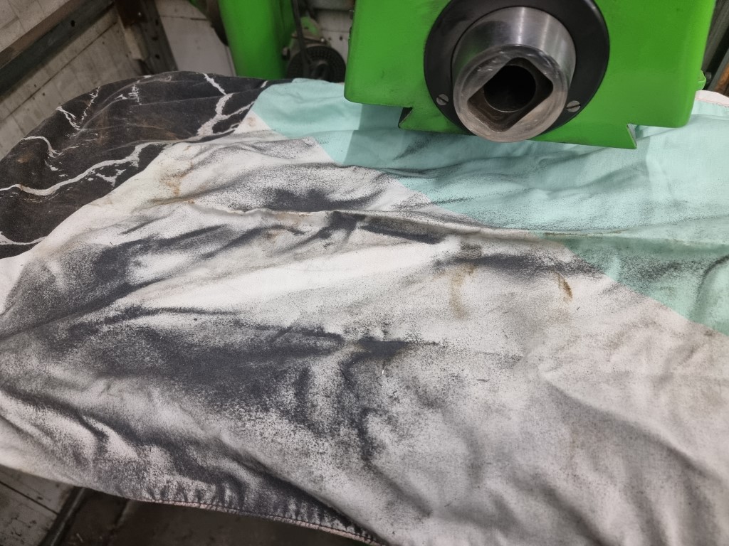

I find that soaking the cloth in water (with a plastic sheet taped to the machine underneath it) helps too.A great solution to the problem, Pete. The only thing that I might have added would have been some magnets to collect some of the grinding debris., and a vacuum cleaner.
