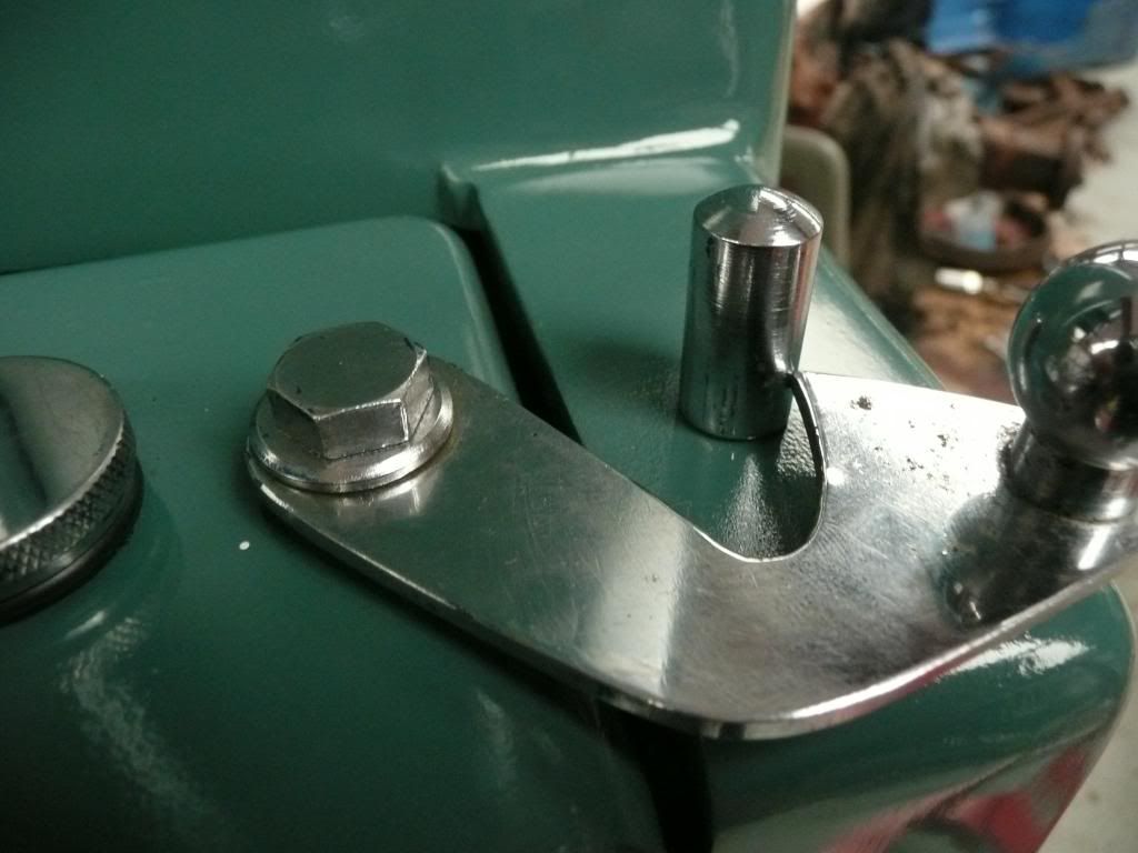

Already scratched it!
Top man. That's the mark of a real machine.
A few months from now you'll likely not give a damn. That first scratch is always the worst one.

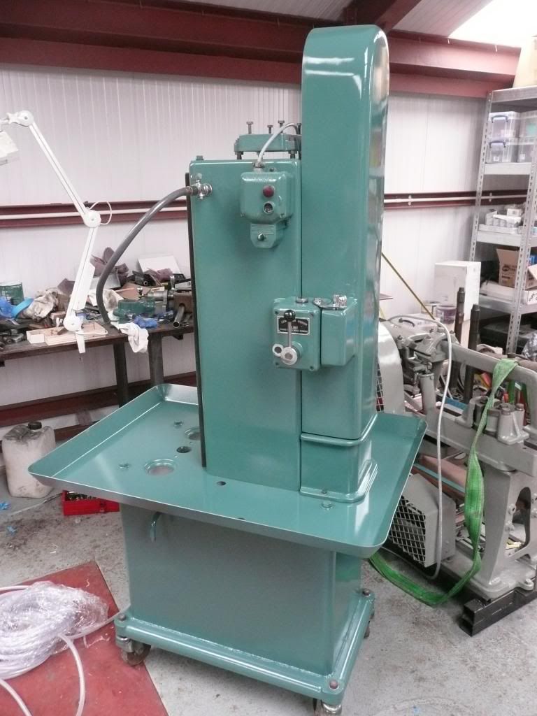

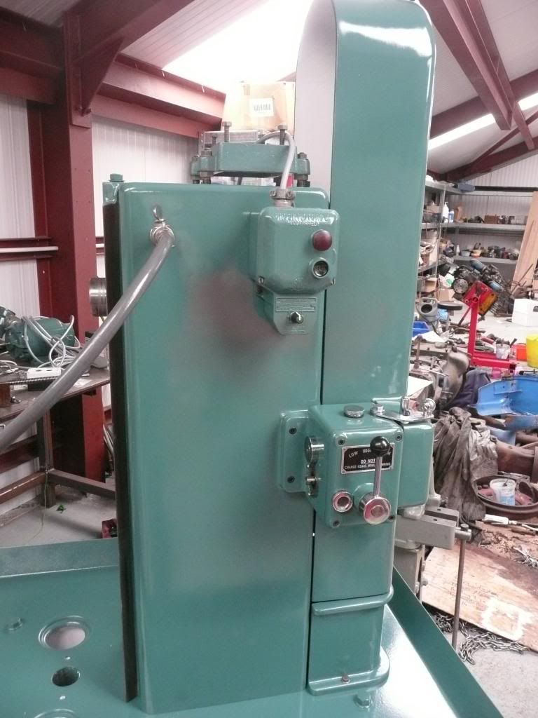

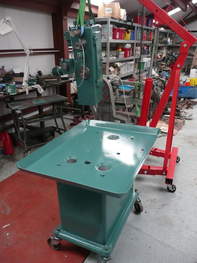

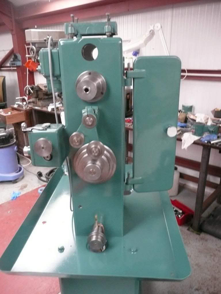

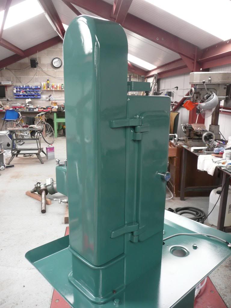

Paint the inside.that's a bit OTT OCD![]()

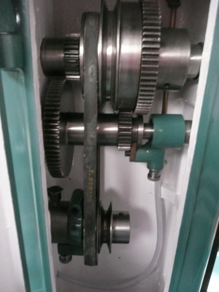

, trouble is the machine was so dishevelled when I bought it that I had to get rid of the crappy hammerite, but then I don't know when to stop. I thought I may as well do it while I'm at or I will always be looking at it later thinking I should have done it when I had it in bits.

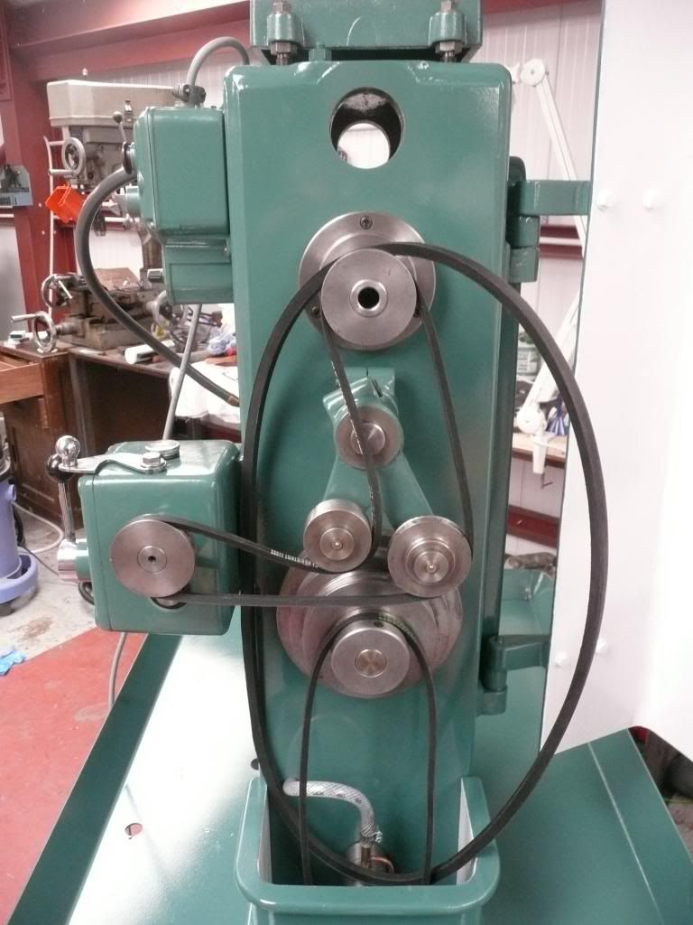

I think these are the belts needed, I've posted this on the Tom Senior yahoo site in more detail. I'll let you know when I come to fit them.
main shaft belt - B35
motor belt - A38
gearbox belt - Z39
suds pump belt - Z33 (although the manual does mention a plastic belt for this)

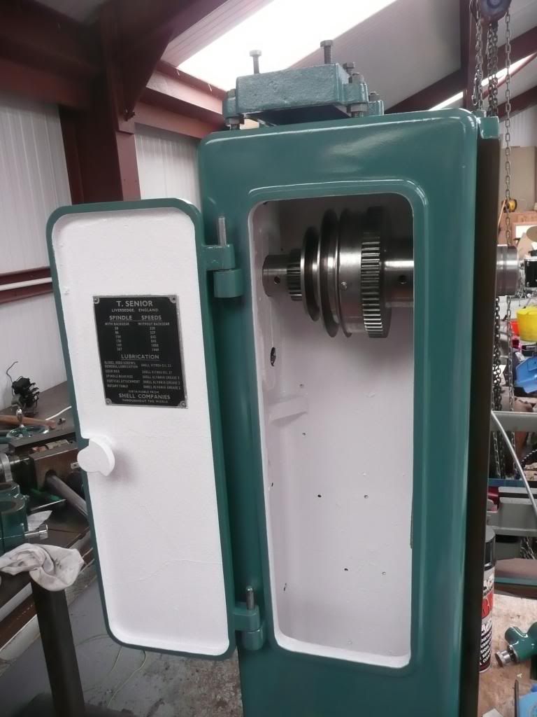

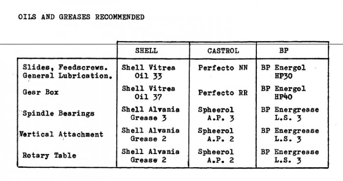

Next job is to put oil in the spindle cone pulley, you can see the grub screw to fill it in the centre of the following photo. I also need to repack the grease in the main shaft bearings before replacing the covers. I guess good lithium general purpose bearing grease will do for the bearings however not sure about the oil for the spindle, the manual doesn't mention what grade this should be, only for the gearbox and "general lubrication". Any ideas while I ask the Tom senior group?
Cheers
Andy
I used a leather belt to run the suds pump and its a disaster,sometimes it works and sometimes (when you really need it) it doesn't. Something much softer like a rubber belt would make sense. I've also seen them converted to electric pumps which mightn't be a bad idea. Tom senior's have the worst suds tank in the history of machine tools, you can't take it out to wash it and all the swarf and crap falls into them.
I didn't know about the grub screw in the bull wheel when i got my tom senior first, first time i ran it it sounded like a barge, i used 90w gear oil and its fine now, i don't know what grade it is supposed to be however.

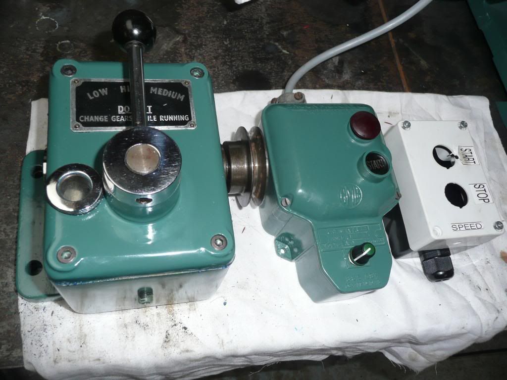

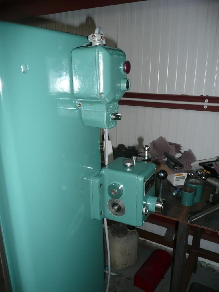

would it be worth looking round for an old Bakelite control knob (off a radio?) for the potentiometer, would be more in keeping with the style.I like the neat solution for the electrical/electronic controlswould it be worth looking round for an old Bakelite control knob (off a radio?) for the potentiometer, would be more in keeping with the style.
pity our local tip is closing down for about 4 months for redevelopment, I'll keep my eyes peeled for an old radiogram.
it didnt look that good when it was new it didnt look that good when it was new
Too true guys - only nice clean virgin steel with no rusty or oily bits
Motor in the base, isn't that on the later VS Ronan?
