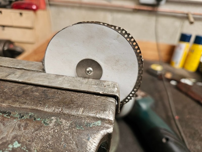

More tarting up of the mills while clearing off small jobs that are cluttering the bench. Similar to previous job, more SS perforated sheet left over from when I built the mash tun in the brewery.
Cut a circle, I had roughed these out years ago, I'm trimming them with shears then finishing with the angle grinder using a paper 85mm template.

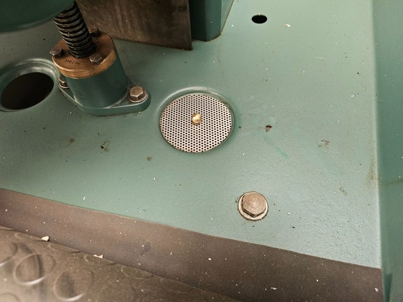

Add the brass knob and finished. This stops stuff falling into the suds tank under the mill.
