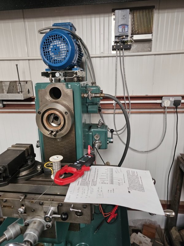

if the VFD doesn't have a gland plate in the bottom, mount a small adaptable box directly underneath.Hope you're going to tidy the wiring up?, the terminals are carrying the weight of the cables at presentif the VFD doesn't have a gland plate in the bottom, mount a small adaptable box directly underneath.
Use the correct glands so the braiding is earthed.

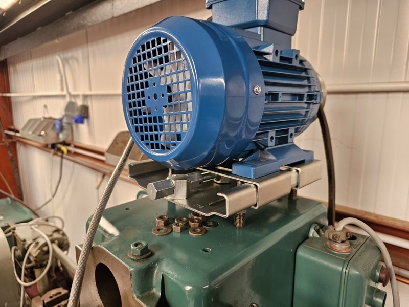

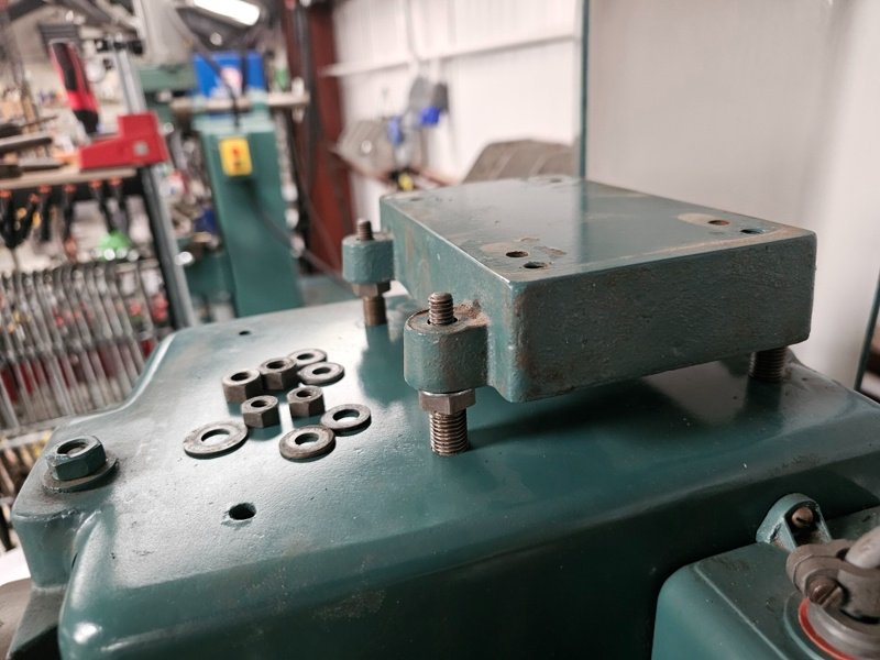

Like a lot of lathes, hinge the plate one side, mounted on two of the existing mill bolt holes. Make a swivelling bracket to hold a length of studding mounted on the other two holes.

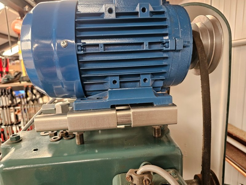

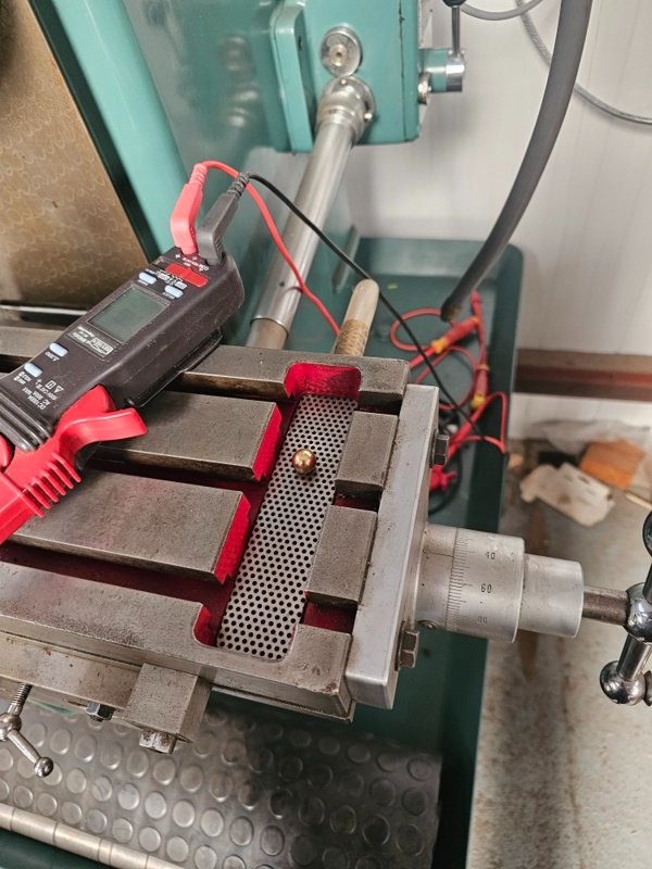

I can’t find a decent guide to calculating brake resistor size and wattage, do you know of one?The motor plate worked, still not much room for longer bolts but managed to select the correct swear words in the correct order and then it went together fine. I managed to reuse the existing belt, I thought I would run out of adjustment being a bigger frame motor but it worked fine. The fore/aft adjustment on the motor plate meant that lining ul the top and bottom pulleys was a doddle.

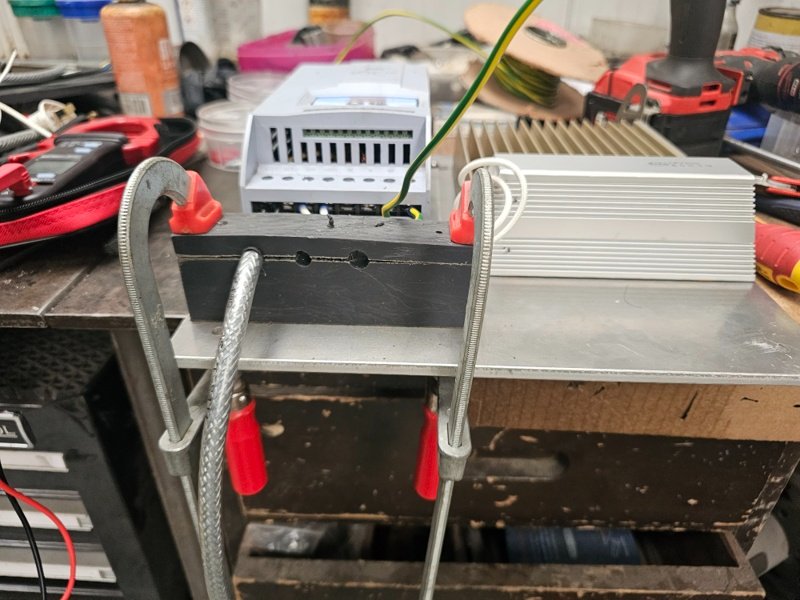

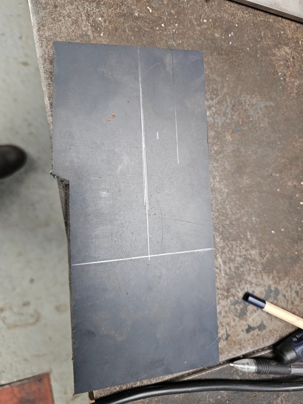

Next job was strain relief for the cables going to the VFD. I uses a bit of 25mm thick HDPE sheet.
It's a sod to cut, the bandsaw is a bit fast so it tends to start melting a little, but taking it steady it went through it OK.
The idea is to drill holes the same size as the diameter of the mains, motor and control cables, then cut across the holes, the kerf of the bandsaw means that it will tighten down on the cables. The pic above demonstrates.
VFD mounted, complete with brake resistor and strain relief block. I need to tidy the cabling up a bit. It took me a while to realise that the factory reset of the VFD parameters put some parameters in the 3rd and 4th analogue inputs that clashed with the start/stop parameters I had in the first and second. It all works now from the old switch controls including speed control. The cold plate VFD is silent, which is really nice, I hate fans. I need to configure the braking resistor parameters, I haven't done that before on a WEG but doesn't look difficult.
I'm going to give the mill a bit of spit and polish and a full test next week, I've got family commitments this week that will keep me out of the workshop.
