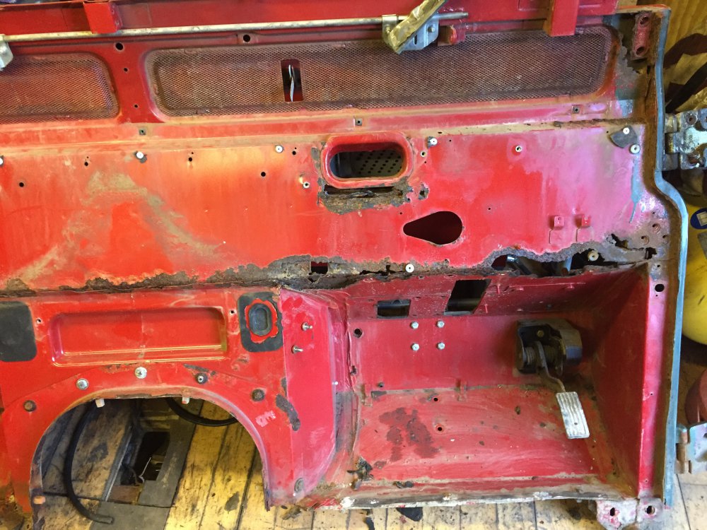

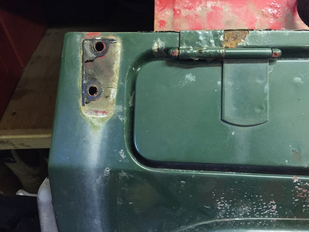

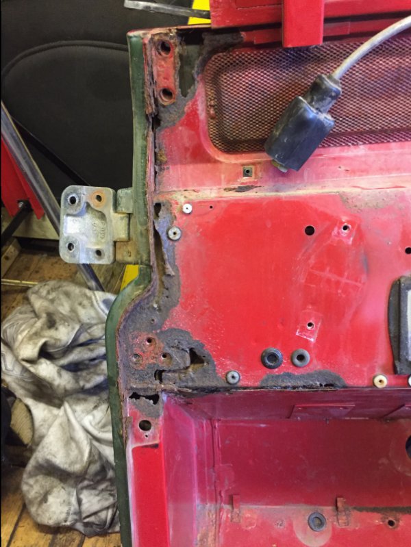

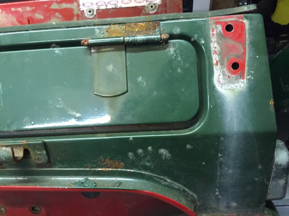

Which side inside or outside ?Would you have an pictures of the top of the bulkhead where the windscreen frame meets? I have to repair mine and some pictures would help. Mine has rusted through on the corner by the mirror/below the windscreen frame

Here you goOutside, looking at front side (as if you are standing at the front of the car looking towards the landy)
Kim
. But like you say they can be waxoyled.

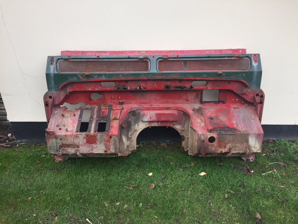

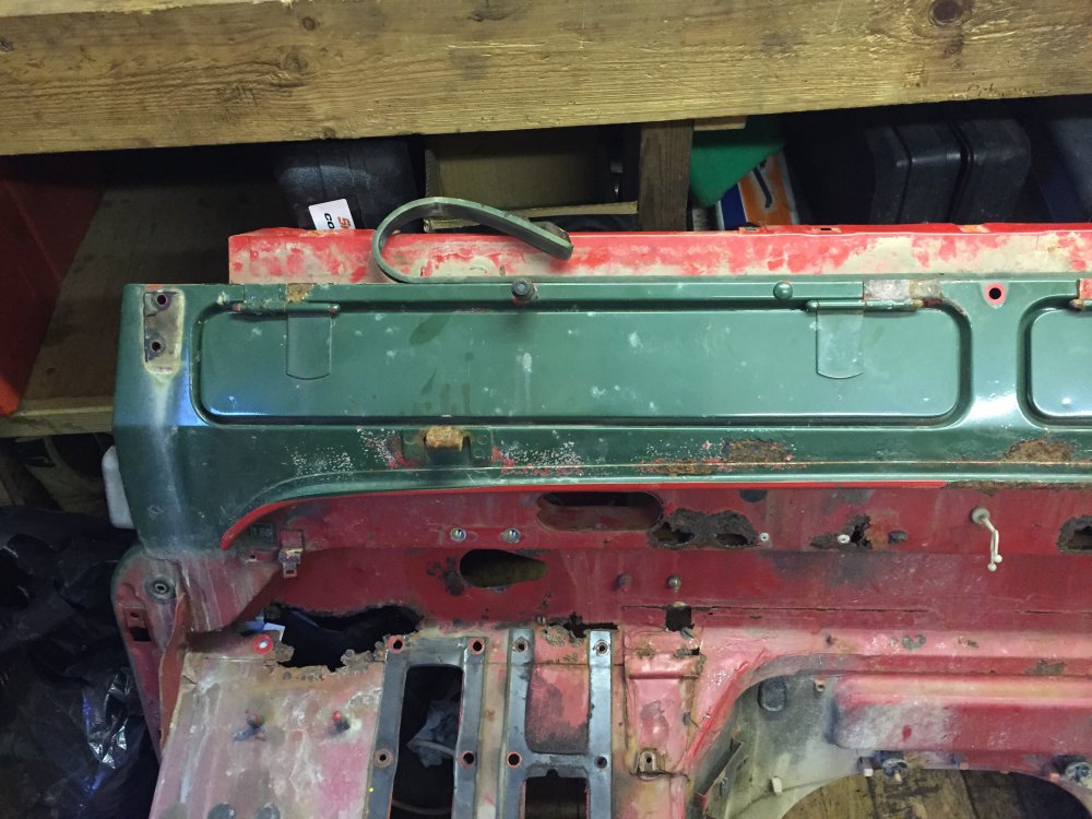

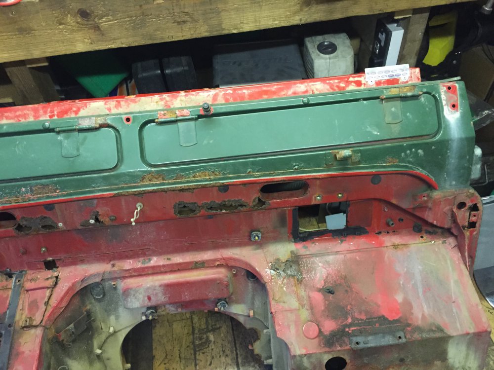

I was going to zinc plate, then two coats of spray primer then maybe three coats of nato green and on the underside I was going to underseal it with a durable black paint which I've not worked out yetWell if you leave a bzp bolt and a galvanised bolt outside the , zinc plated one will start to rust first . I presume your bulkhead will be zinc sprayed ? In which case any voids won't be covered. But like you say they can be waxoyled.
If it's blasted then zinc sprayed then painted I think it will be a good job , it's either that or you make a frame to hold everything in shape then hot dip galv the lot ??
Decisions decisions
Cheers MIke
Already gone now, I'll make some up easy enoughCan't add much about zinc plating vs galving but companies such as ash tree seem to be churning out galv'd bulkheads so it must be doable without it warping? But in terms of the waxoil after doing a bit of reading it doesn't sound like a great idea on metal that's already rusting because you're then just covering over it and you can still get problems, happy to be proven wrong about that it's just what I read.
