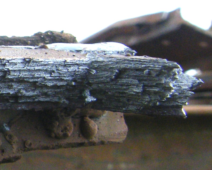

Wrought Iron consists of layers of slag interlaced with almost pure Iron.
Therefore if you are welding the surface you will be welding pure iron which is easily done. There is strong possibility that you will get lamellar tearing (pulling the layers apart) but its difficult to avoid so it has to be accepted.
If you are welding “through the thickness” you are trying to weld slag which is virtually impossible without getting porosity or cracks.
If the weld doesn't need to be “perfect” a 6013 will do an acceptable job.
If you need a porosity free weld you must use a 7016 type rod and weld, grind back to clean metal, weld again, grind again. Eventually you will get a weld of acceptable appearance, metallurgically it wont be sound but it will probably be stronger than the wrought iron.
Laminar tear in ancient beam
Failure in an old beam showing laminar tearing
