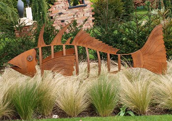

Stickleback Sculpture by Alan Ross
Corten is often used in outdoor sculpture. Stickleback by artist Alan Ross
