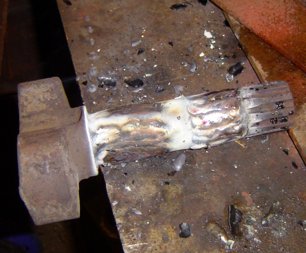

Casting is purely the means of creating the shape, same as forging and rolling. Therefore Cast Steel could be any grade from mild steel to Stainless.
Quite often it is something like En 24T mentioned earlier and, if it is, it should be welded in the same way.
If the actual grade is unknown E312 filler is good choice in that it is crack resistant and high(ish) strength (around 800 N/mm2).
Usually castings are non uniform shape (which is why they were cast) and this can create problems when heating (preheating) in that the thin areas will warm up quicker than the thick areas and expansion forces could cause cracks. Be careful if using a torch, heat it slowly give the thicker sections time to warm up.
Cast steel shaft built up with weld prior to machining
Building up worn cast steel shaft. (E.T Brown and Son)
