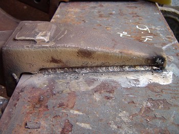

Low hydrogen root
Root using low hydrogen rod. (E.T Brown and Son)

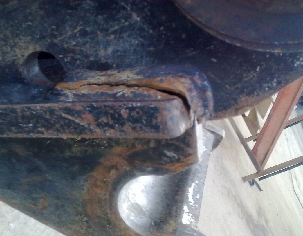

Fatigue crack in digger hitch
Fatigue crack in digger quick hitch originating at the edge of a weld
