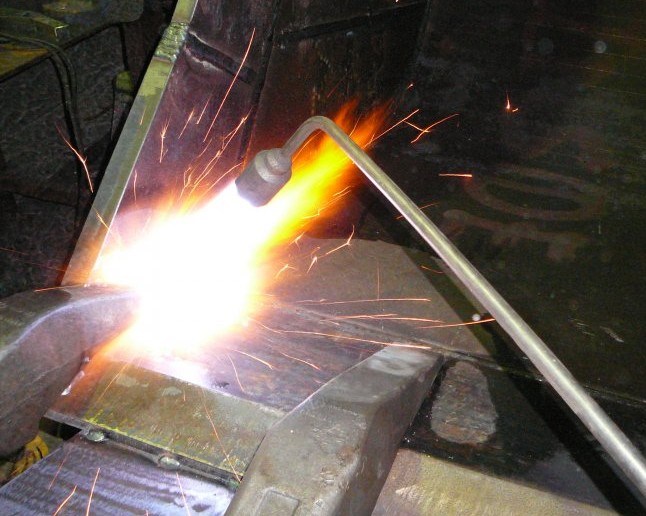

Hardox 400 40mm combined thickness will need 75°C preheat whilst Hardox 500 20mm combined thickness will need 100°C. Thicker sections will need higher preheat, and in both grades the interpass temp should be kept to 150 - 175°C.
If preheating is a problem it is possible to weld without preheat using a 309L type electrode or wire, but remember stainless cannot be burned with standard oxy-acetylene. Some of the digger bucket repairers once warned me of this problem which gives them headaches on subsequent repairs.
Torch used to preheat hardox prior to welding
Torch used to preheat hardox (Flynns Buckets)
