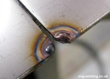

Tacking
If two sheets are very close together they can be tacked using a tight arc length without problems. If there is a gap between the two sheets then there is a tendency for two separate pools to form, melting away both sheets without joining to form a single weld puddle.
In the photo the tack has been attempted on the edge of the joint. While it would be easier to tack a little distance in from the edge, the edge will need to be welded at some point and it's easier when it's cold. Also we avoid the need to weld over the tack as the joint is welded.
SHeet burned back where tacked
To avoid burning back the sheets the filler rod needs to be added very shortly after starting the arc and before the weld pool has had a chance to burn the corners away.
The filler rod has two functions. It bridges the gap between the two sheets allowing a single weld pool to form, it removes heat from the weld pool preventing the sheets from burning away.
In the video the arc is started, filler rod very quickly positioned in the joint. Then the weld is continued for a short distance along the plate. We plan to start the weld on top of the tack, and if the tack is too short it will melt and break apart when the weld is started.
If the tack causes the gap to close up too much a tap with a hammer on the tack should spread the gap again.

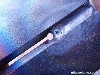

The photo shows the keyhole that forms ahead of the weld where the two sheets have burned back a little. The photo exaggerates the size of the keyhole - it's 3mm plate with V preparation that tapers to a point for the purpose of photographing a keyhole. Normally it would be a lot smaller. The keyhole is visible during welding and is a useful indicator that the weld pool has melted the sheets.
Once the hole has formed the molten filler is attracted to the back of the hole by surface tension to form the weld bead. This closes the keyhole and the hole is advanced forward by manipulation of the torch.
With stainless and critical mild steel joints, back purging would be essential when using this technique.
Keyhole in TIG butt joint
