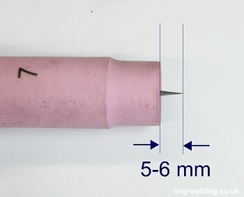

Tungsten
For welding steel the tungsten should be ground to a long point with the taper length about 2 or 3 times the diameter of the tungsten. See DC Electrode Preparation. The long taper and sharp tip improve arc stability.
For a butt weld or open corner weld the stick out would be about 5-6mm. Setting the tungsten stick out for fillet welds is covered on the fillet weld page.
Gas Shrouds
For general purpose work on steel a number 7 shroud is a good compromise. A smaller number 4 shroud would be more suitable for fillet welds, and larger shrouds might be used for aluminium. As a rule the larger the shroud the better the gas coverage.
Tundsten set to 5-6mm stick out
