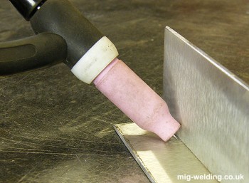

The torch is angled at 45 degrees to the corner of the fillet (tilt angle) and also angled back about 20 degrees towards the direction of travel (slope angle). The metal is 2mm stainless, and we set the machine to 75 amps (see the tig amp chart).
A smaller shroud than normal is used for fillet welds - we've used a number 4. This allows the torch to get closer to the corner of the joint. Gas shielding is poorer with the smaller shroud, but for fillet joints the gas is contained in the corner, making up for the smaller shroud.
The end of the tungsten is about 3mm from the corner of the joint when the torch is in welding position. It's difficult to judge the distance to the corner. A piece of 1.6mm welding rod in the corner can be used to set the tungsten stick out much more accurately.
Torch position for TIG fillet weld

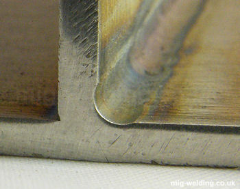

Autogenous welds are pretty, but not as strong as ordinary TIG welds. The metal in the weld pool comes from the sides of the corner so there is undercutting, and the reinforcement added by the weld is quite small - normally it would be about 0.8 of the thickness of the steel.
This is the same 2mm stainless sheet we started with - it looks much thicker in the photo!
Autogenous TIG fillet weld showing undercut

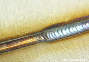

The main reason to try autogenous first is to get a feel for how the weld should behave. In the photo there is the autogenous weld from the first video to the left, and the fillet from the following video to the right.
The two welds are very similar in size. The filler just being added to replace the metal melted into the weld pool. Too much filler rod will build up the weld excessively and cause the heat to go to the sides of the fillet and not the corner.

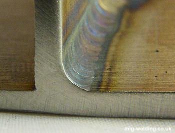

We've stayed at 75 amps and used 1.0mm filler rod for the fillet.
Comparison of autogenous fillet weld and weld using filler rod
In the video the rod is only touched to the front of the weld pool and not forced in to the pool. You don't need to add very much filler.
The filler rod replaces the metal used to form the weld pool, so there is no undercutting.
Cros section of TIG fillet weld

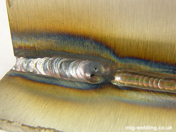

Every TIG welder who has not had formal tuition will likely suffer from this one. The weld on the right is normal - neat with a straw colour. The one on the left was deliberately done with a 4mm arc gap (much too long) which increased the heat in the weld and generally left a mess.
The arc would form against one sheet or the other, and the torch had to be manipulated between the sheets to make the weld pool form against both sheets. This reduced the speed of the weld and the increased heat input can be seen in the grey colour of the weld and the distance of the bluing on the material from the weld.
Fillet weld fault - arc  length too long
