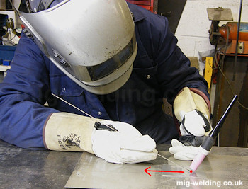

Find a Steady Position
When TIG welding you need to be able to control the distance between the tungsten and the work to within about 1mm. This is only possible with a good welding position. In the photos the welder has used a few tricks:
  • Just to confuse you we've photographed a left handed welder. If you are right handed hold the torch in your right hand.
  • The welder is sitting down and working on a bench. His upper body weight is not supported by the bench - the bench is only used for positioning.
  • In the photo a flexible torch head (very handy) is being used to maintain the angle of the torch with the hand resting lightly on the bench. The hand would need to rest on a piece of wood for the correct angle with a standard torch.
  • The torch lead is wrapped around his arm. This takes the weight of the lead away from the torch and reduces the chance of the lead snagging as the weld progresses.
  • The head is positioned to the side for a good view of the weld pool. It is very common for beginners to hide the weld behind the gas shroud.
  • The lighting is from the side as well as overhead - it allows the welder to see the tungsten position before starting the weld.
  • The torch would move in the direction of the red arrow in the photograph (that one isn't really a trick but is worth a mention while the photo is there).
Relaxed muscles will aid control of the torch - try not to TIG weld directly after hammering or other physical activity, and ensure the workshop is at a comfortable temperature.
The red dot in the photograph just below the torch shows the area the welder will be looking at while welding. It's a tiny area, so for a good view his eyes need to be close to the weld. It's very common for people to discover they need glasses when they first take up TIG welding.

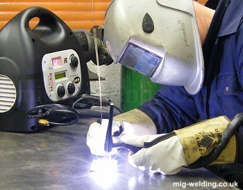

Torch Angle and Movement
The video demonstrates torch angle, position and movement. Above all it shows what a delicate process TIG is. The torch movement is steady in the video and briefly stops while the filler material is added.
The torch is held at about 20 degrees from vertical, tilted so the tungsten points in the direction of the weld. The tilt encourages the weld pool to form ahead of the torch making it easier to add filler rod.
The gap between the tungsten and the work should be maintained at between 1x and 1.5x the diameter of the tungsten. We're using a 1.6mm tungsten so the gap is about 2mm.
It is good practice to move the torch across the work as a dry run before welding to make sure the torch angle and distance to the work can be maintained naturally, and that there isn't anything that will impede movement.

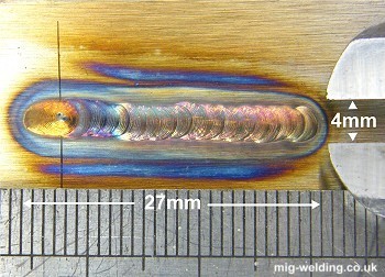

The videos and photos do not give a sense of scale. The weld in the video is only 4mm wide which is perhaps half the width of a MIG or Arc bead for the same material thickness.
The travel speed was about 1mm per second, again much slower than MIG or Arc, but faster than you might imagine while you are distracted by all the other things involved in learning to TIG weld.
The weld is quite flat - less than 0.5mm tall. An ideal for a joint would be to have the reinforcing thickness of weld above the work about 10% of the material thickness.
TIG Bead showing width and length
Our weld has not penetrated through the bottom of the 2mm sheet. We're not aiming for penetration here, just some practice in laying beads.

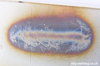

If your bead penetrates through the rear of the steel before you get the hang of laying a nice bead it is likely that your travel speed is too slow.
The travel speed can be judged by the width of the heat affected zone around the weld (the discoloured part). In the photograph it is quite narrow, maybe 15mm edge to edge.
If the weld had been done at lower amps and a slower travel speed to compensate the heat affected zone would have been much wider. A slow travel speed actually puts more heat into the weld as heat is conducted away from the weld pool before the weld pool is established.
Reverse of bead on  sheet

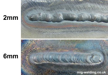

Struggling?
You did start off on 2 or 3mm steel didn't you? It really is a lot easier than the thin stuff.
The two welds in the photo on the right were made by a beginner TIG welder. In the first photo the welder was struggling to control the weld pool, and was having trouble adding the filler rod.
The second weld was made immediately afterwards with no further training. The only difference is the thickness of the steel (and the amps adjusted to suit). The increased thickness means the weld pool is larger and easier to control, which makes it much easier to add the filler rod.
The plate in the second photo hasn't been prepared properly - the steel needs to be completely shiny and free of rust or mill scale else the weld will spit steel back at the tungsten and contaminate it as soon as you start the weld.
The ease of welding thicker material makes it easier to understand and develop the technique. Also it provides a big confidence boost. Once you have the technique it is easily transferred to thinner material.
TIG welds on 2mm and 6mm sheet
