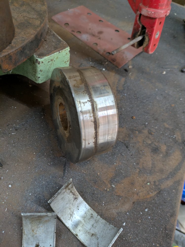

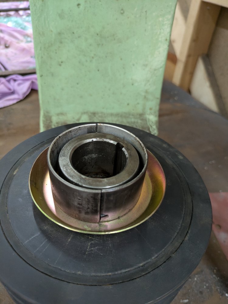

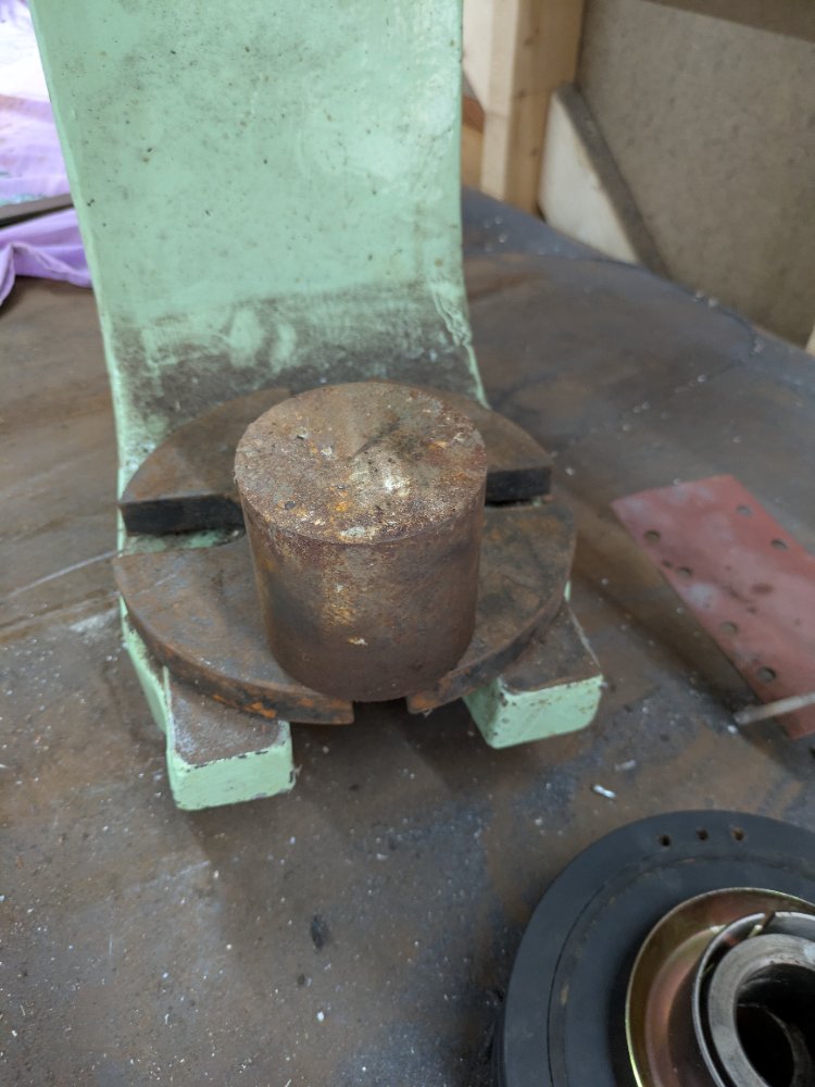

One new dust shield / oil slinger fitted to the 300Tdi damper.
One lump of steel to support the inside of the damper pulley.
Two JCB / Perkins big end bearings as my largest (52mm) socket wasn't big enough.
And then a Perkins cylinder liner puller to press down.
