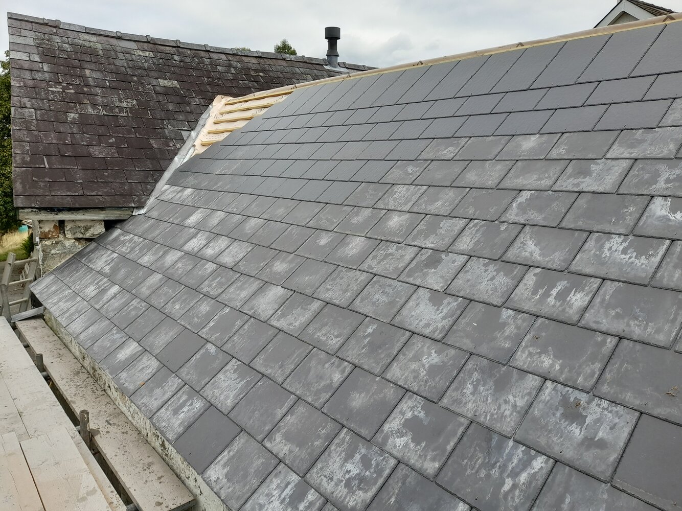

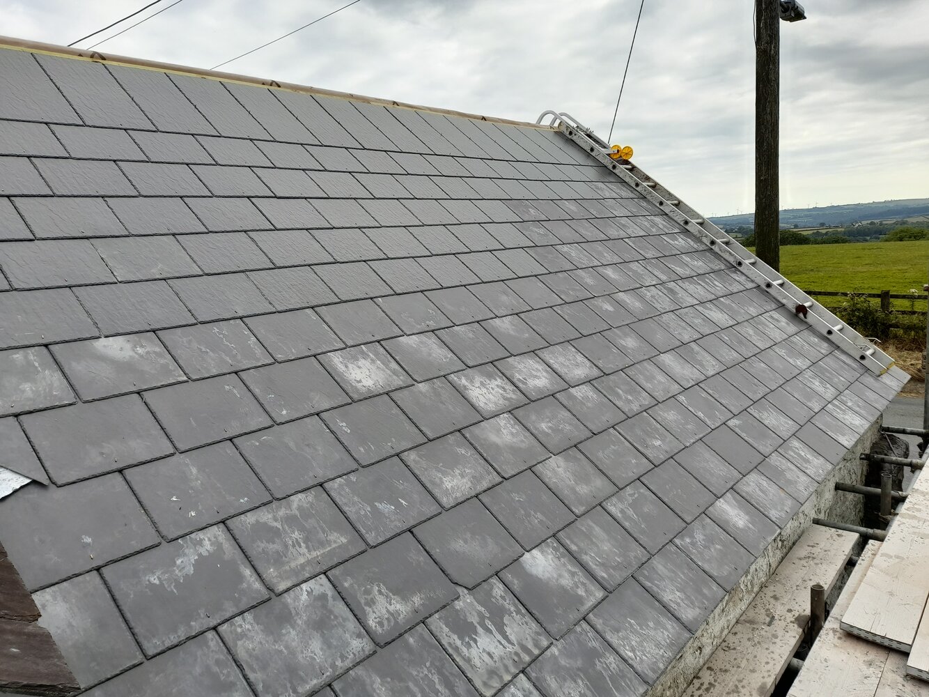

Yes, have some on my garage roof that aren't fixed, 5 years later they are still there, its yet another roundtoitHoping i can fit the ridges temporarily till i can work up the time & enthusiasm to tackle the other side... then remove then and refit when the other side gets done. Can I do that?

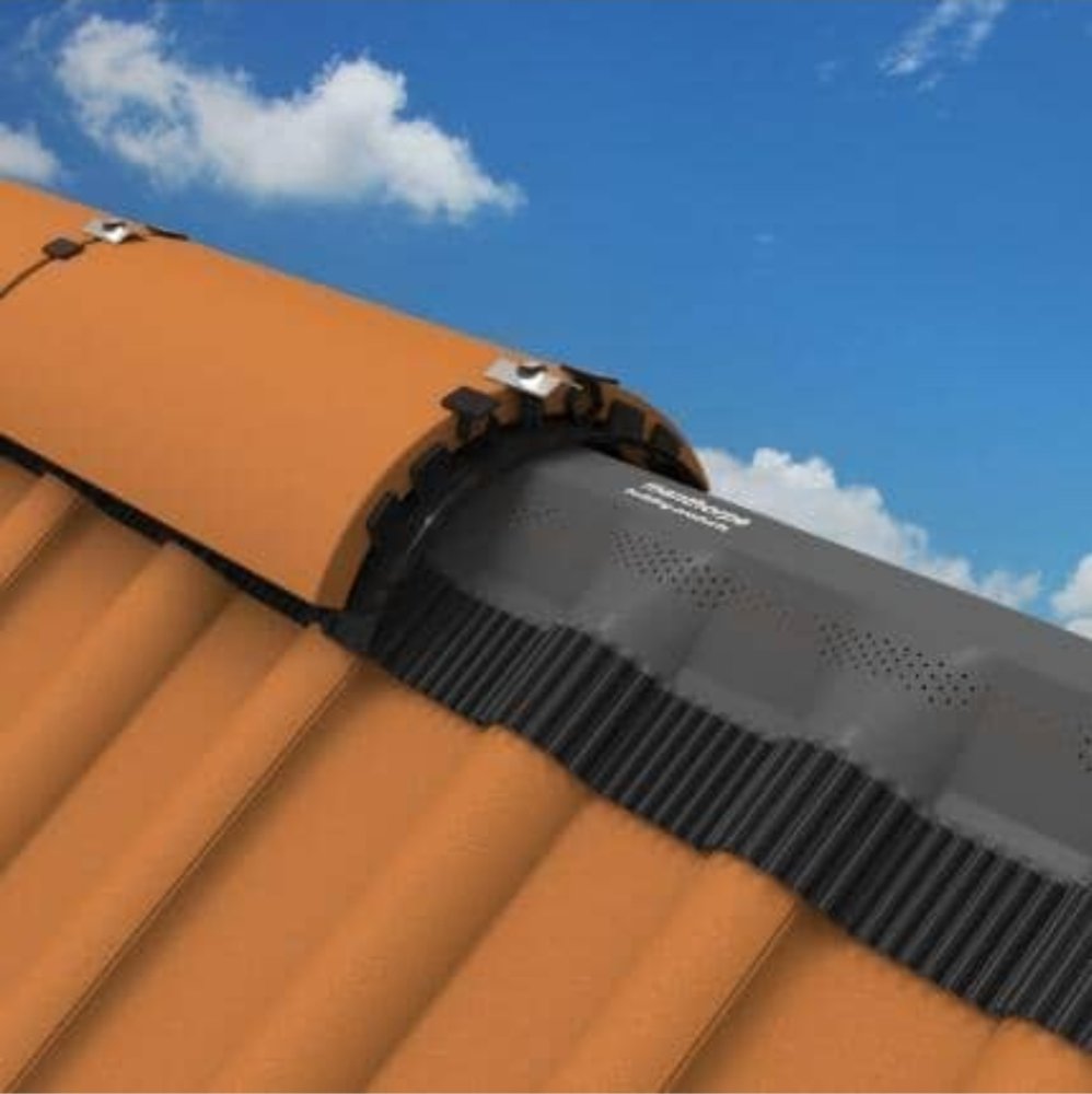

I've never fitted any Ridge Tiles, & only recently heard of these dry Ridges, which I understand you screw down?Yes, have some on my garage roof that aren't fixed, 5 years later they are still there, its yet another roundtoit
So... I'm guessing they can be unscrewed, removed & refitted again?
Good stuff, thanks for that.@GRW Gaztube video for you

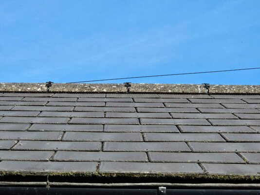

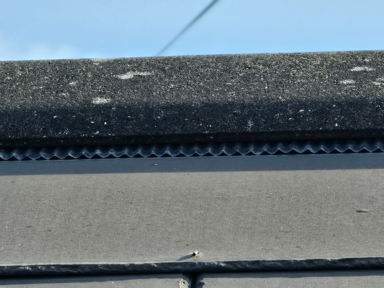

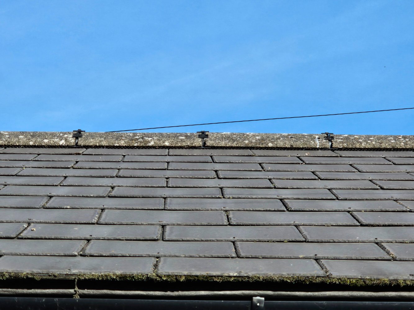

I didn't use the truss or rafter clips, screwed everything straight into the ridge board and made my own end plate for the ridge tiles from an offcut of roof slates and stuck on instead
The video in my previous post, he flattens the corrugated strip on the ridge roll. I didn't do this, i just gently pushed down so the corrugations stayed intact to get some airflow over the ridge
I am not a roofer, just your average DIYer but thats been up for 12yrs and its not had any problems
