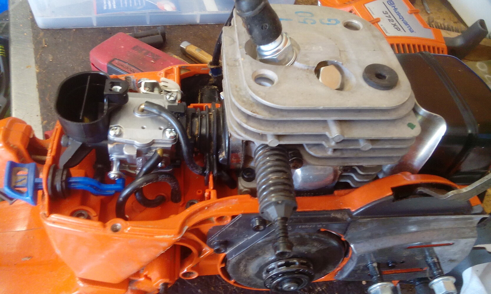

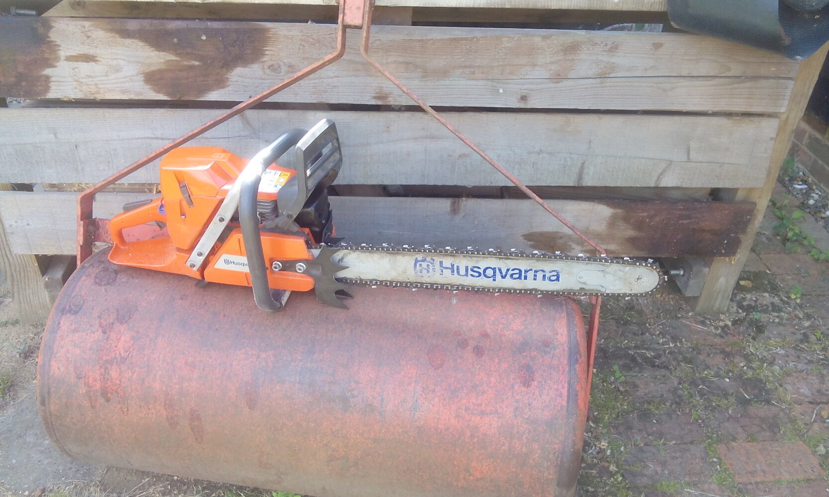

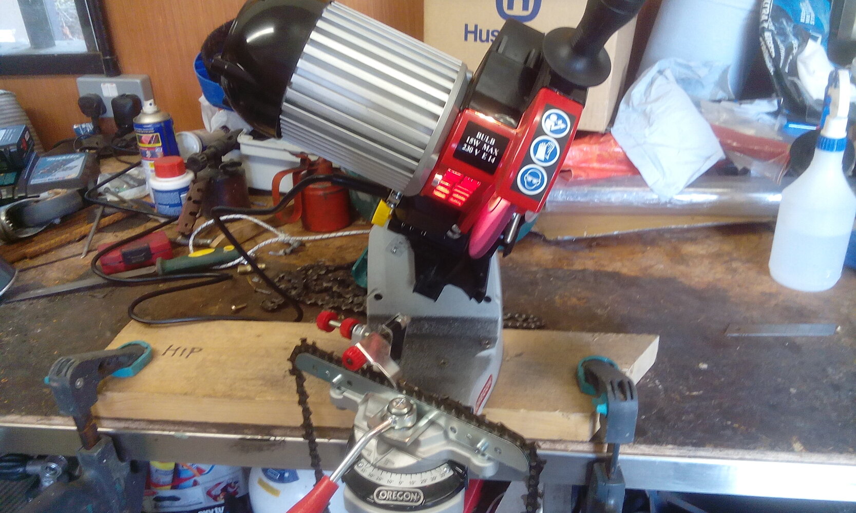

Chainsaw day,
First full strip & clean,
then rebuild carb with new gaskets, new drive sprocket, needle roller for brake, Decomp delete & New unrestricted exhaust,
new larger air filter and housing, and i spoilt myself and got wrap round handle for doing awkward cuts.
used genuine Husqvarna parts, as i have seen how much a new saw would be
Then finally got to use my chain sharpener, 4 x 24" chains in under an hour, but it did show up how uneven my hand sharpening has been.
