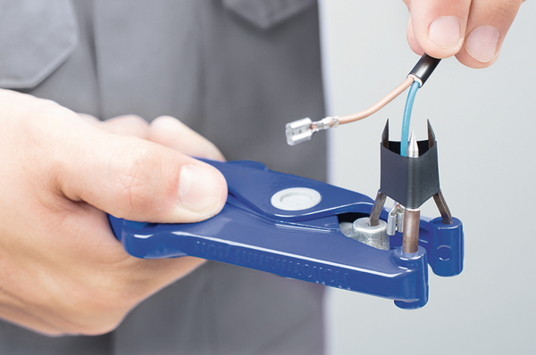

I wouldn’t like to use the Hellermann pliers for anything other than Hellermann sleeves. I was able to score some virtually new ones just like those illustrated above at an absolutely bargain price, and snapped off one of the prongs misusing them as described above!^ Hellermann Sleeve tools do the job nicely.
And can also be used for Hellermann Sleeves ...
Seriously ****** off didn’t come anywhere near it!
I dread to imagine what sort of thing you were expanding that broke off the prong !I wouldn’t like to use the Hellermann pliers for anything other than Hellermann sleeves. I was able to score some virtually new ones just like those illustrated above at an absolutely bargain price, and snapped off one of the prongs misusing them as described above!

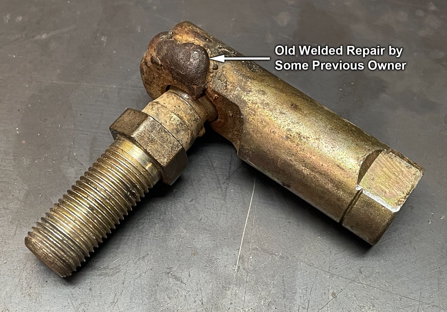

The old steering tie rod ends had a lot of play in them, and one of them even had a washer welded onto it to keep the joint from falling apart.

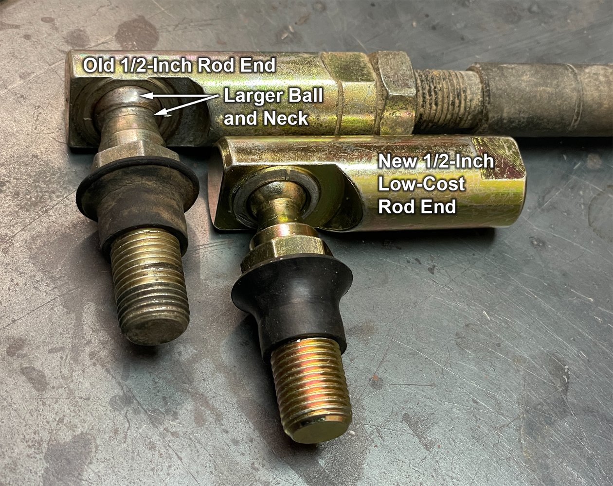

Replacement OEM joints were insanely expensive, so I searched a bit and found some general-purpose low-cost tie rod ends that had the same thread sizes and outside dimensions. However, when I slid back the dust boots on one of the old tie rod ends and compared the 'innards' with a new one, I found that the old one was heavier duty, with a larger ball and a larger neck where the stud meets the ball.
I don't like to replace original parts with lighter-duty parts, and not having any comparative load rating data, I decided against using those new tie-rod ends.

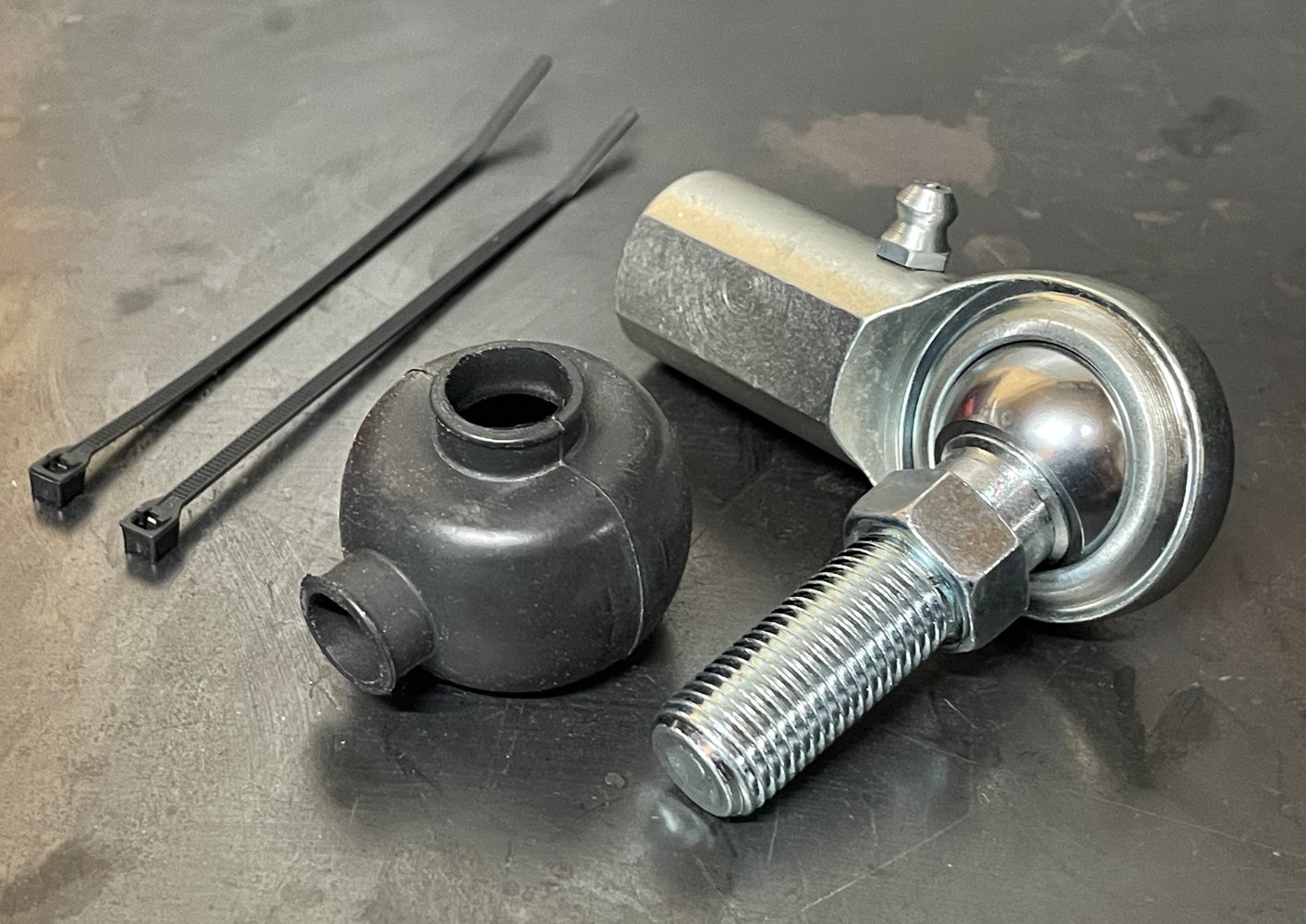

Instead, I found some studded spherical rod ends (commonly called Heim joints here) that should have a higher load rating and also looked like they would fit well (threads, dimensions, and ball swivel angle range). I wanted to install dust boots on the joints, and I finally found some that I thought 'might' fit, although one of the holes would have to be stretched quite a bit to fit over the large-diameter female-threaded body of the joint, preferably without tearing.

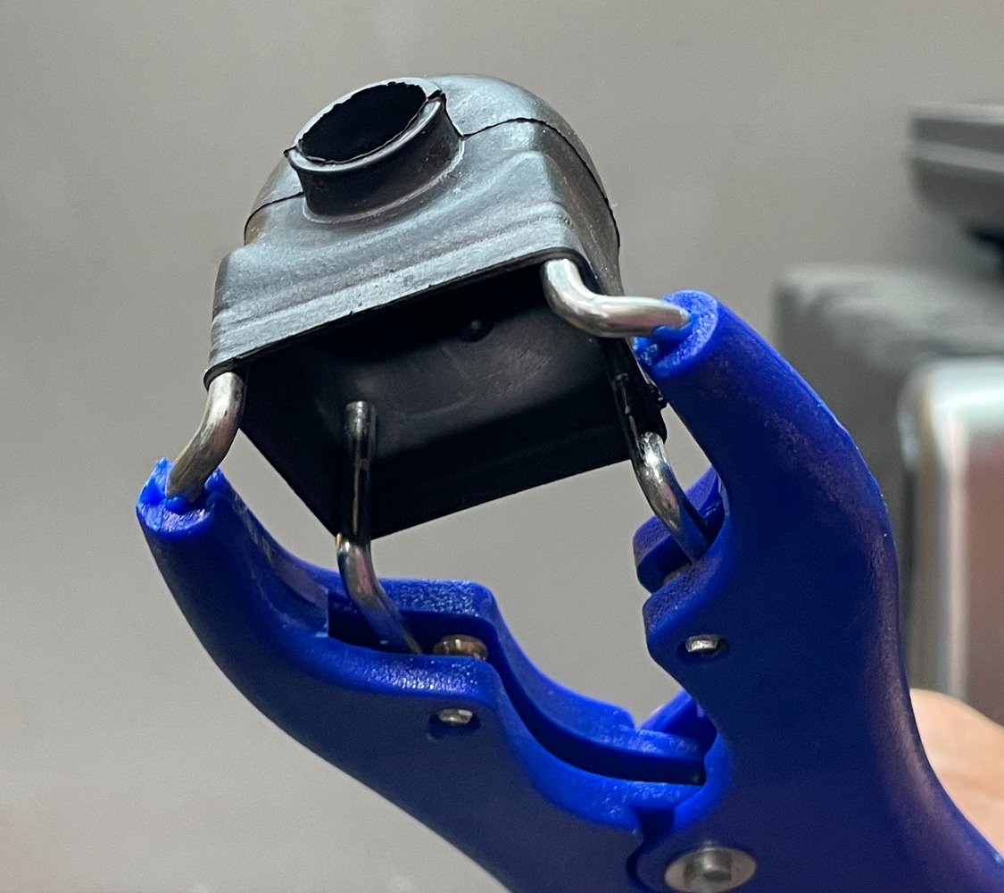

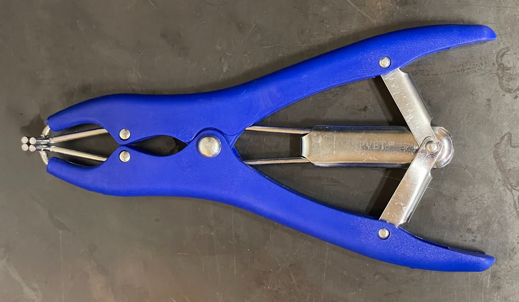

Some of the merchants who were selling dust boots were also hawking what they called a "boot installation tool" for stretching dust boots over a rod end joint. Some of you who have worked with livestock might recognize this tool as what is politely known as 'goat banding tool,' used for attaching strong rubber bands to facilitate the removal of certain, shall we say, 'unwanted anatomical appendages' from farm animals. Anyway, I found this tool in the veterinary supply section of a local farm store for about half the price of a so-called "boot installation tool."

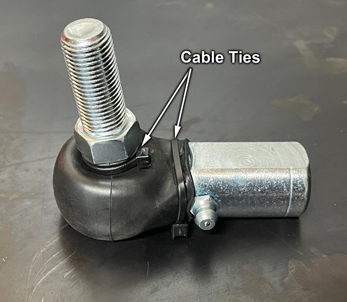

It did a good job stretching the neoprene rubber boots over the joints. I purposely stretched one of the boots even farther than shown in the photo below to make sure that it would not tear, and I managed to install all four boots without tearing any of them. As to how long the boots will actually last without tearing or splitting, only time will tell.

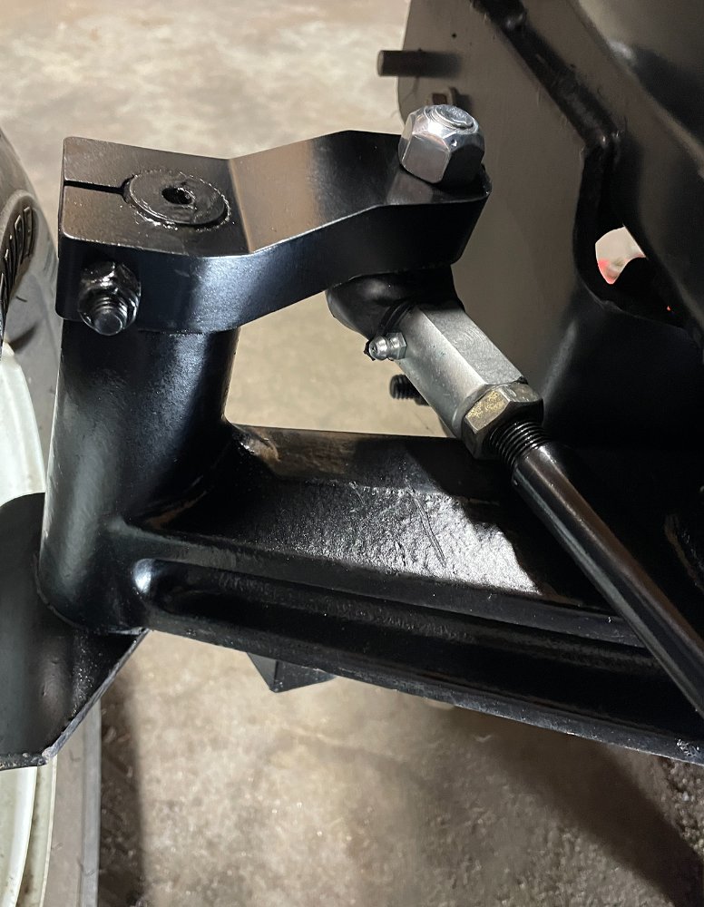

Here's one of the rod end joints after installing the boot, greasing it, and adding cable ties:

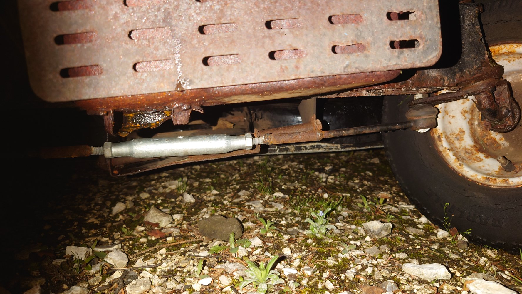

Here are the completed tie rods with their new spherical rod ends:
And one of the tie rods installed on the tractor:
The steering is nice and snug now, with virtually no play in it.

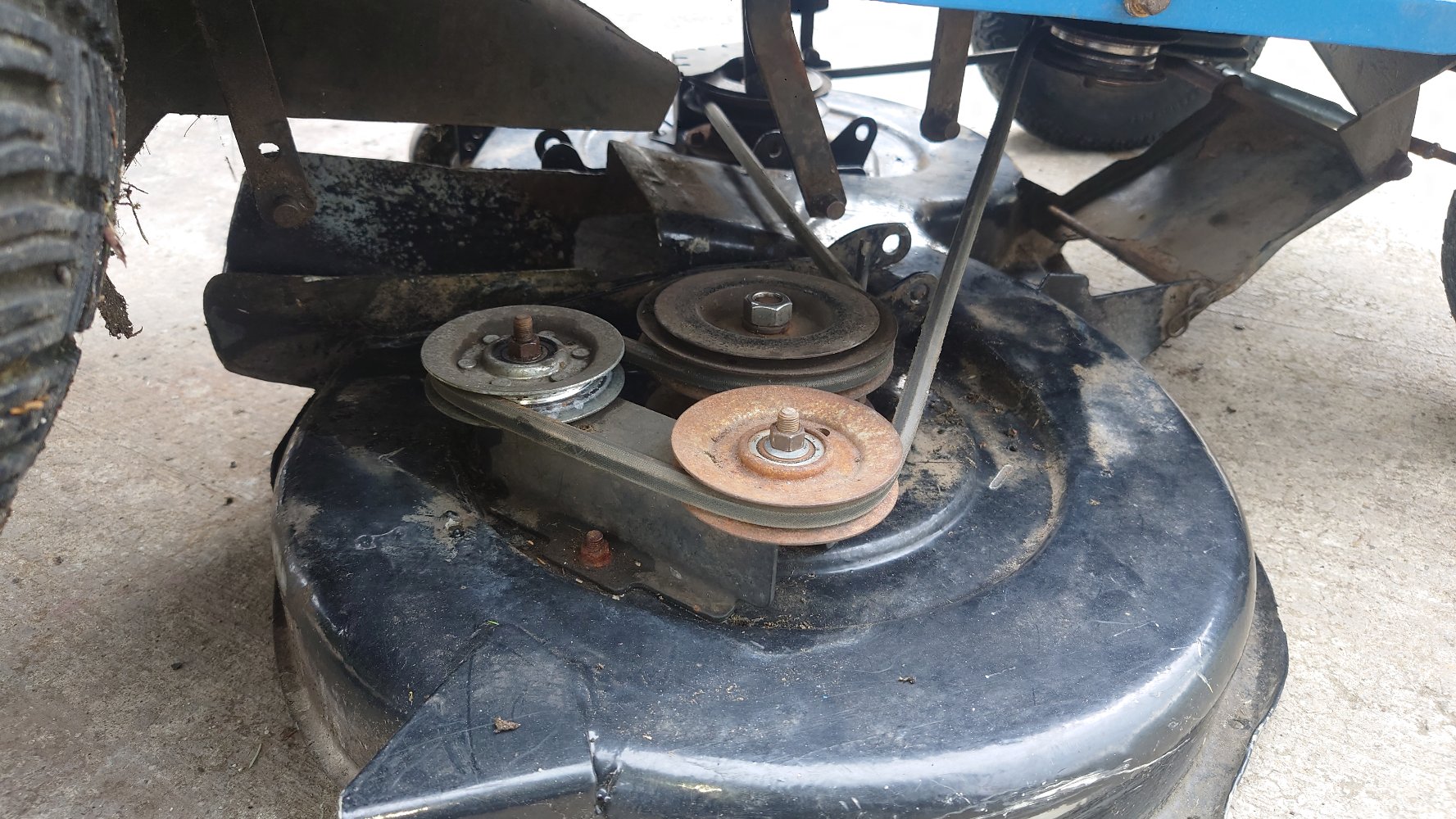

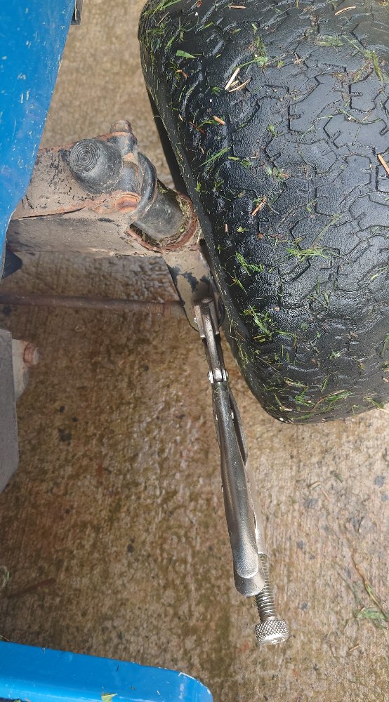

I'd a similar problem on my MTD 906 ride on mower a couple of months ago.
The tie rod fell off mid cut so I clamped it back on with vice grips to finish the cut.
