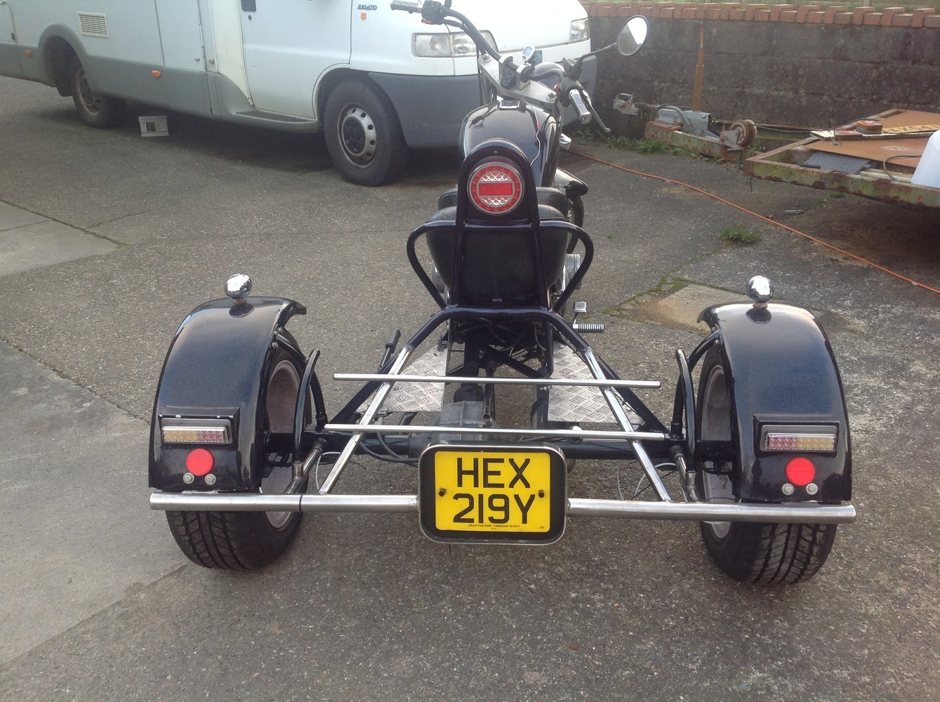

I made the back bumper and rack for my first trike out of stainless tube of various diameters. It pulled horribly. I had to reheat with a big propane torch and pull it back. Then repolish it. It turned out ok in the end.Some 15mm stainless plate i had to heat straighten. Bloody stainless. It doesn't even bend back how you would expect.

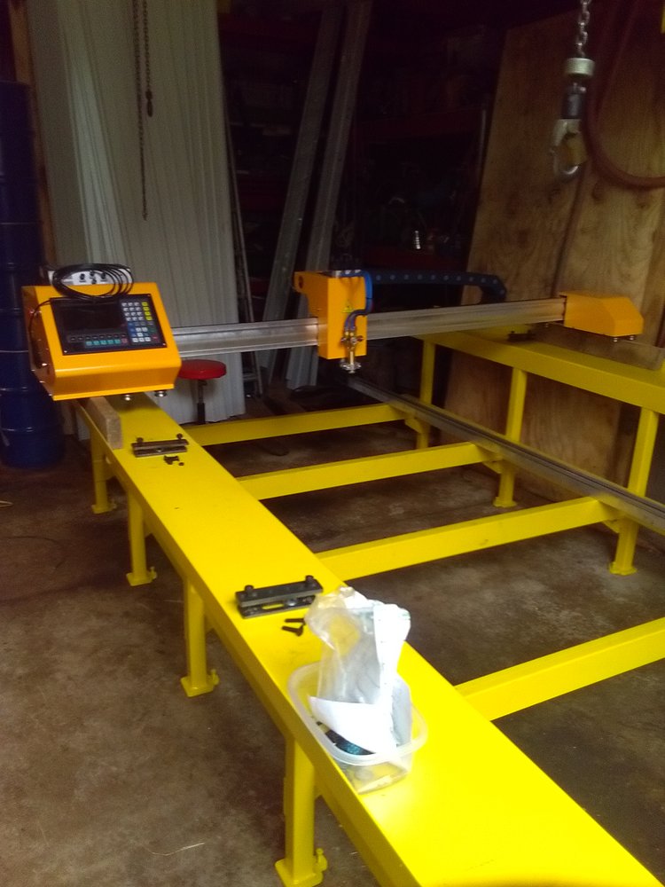

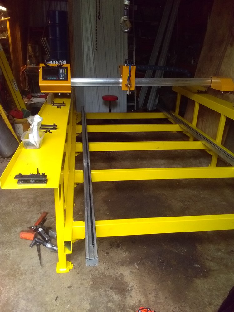

Another believer in wonders of yellow paint, the best colour.Moving the CNC plasma cutter sides into the final place.
View attachment 385398View attachment 385400View attachment 385401
It's Rust oleum "Safety Yellow", and gallons of the stuff can be purchased anywhere, so it's easy to get matching paint later on.Another believer in wonders of yellow paint, the best colour.
Or color, for you.

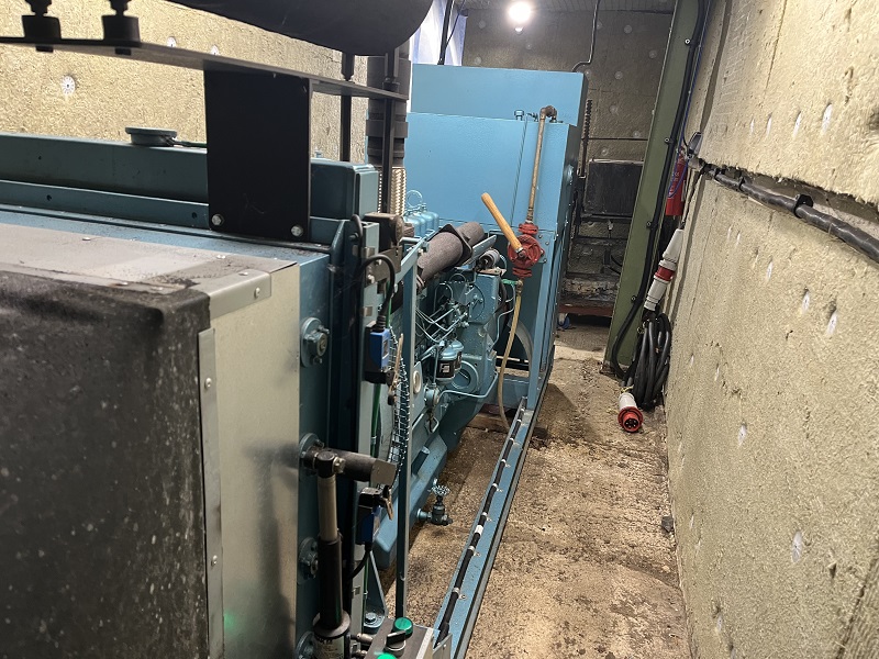

Nice generator!The big 110 KW 3 phase generator that I use for my Induction Furnace:

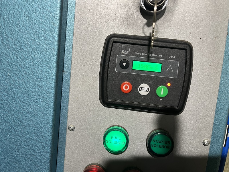

I do regular start up tests as it's not used that often and we've had heavy frosts recently which aren't good for batteries. Started up like a champ on the button but after about 10 seconds the Deep Sea 3110 controller shut it down on over voltage - tried several times and it was repeatable. Now this happened several week ago and the 'fault' just went away - well it was back!
Suspecting condensation, and suspecting the AVR (Automatic Voltage Regulator card) as it's about the only thing that can create an over voltage I un-clipped it's ventilation covers (The AVR lives inside the alternator fed from it's own little alternator with rotating diodes - quite sweet really). Sure enough the wiring and underside of the PCB were wet.
A quick warm up with the workshop heat shrink blower and we're back on track. I left the generator running for a while with the cover off to hopefully disperse the moisture, but it needs a fair run on a heavy load to really warm it up.
