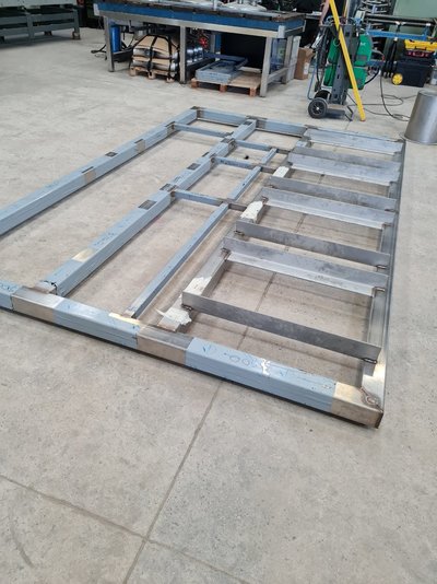

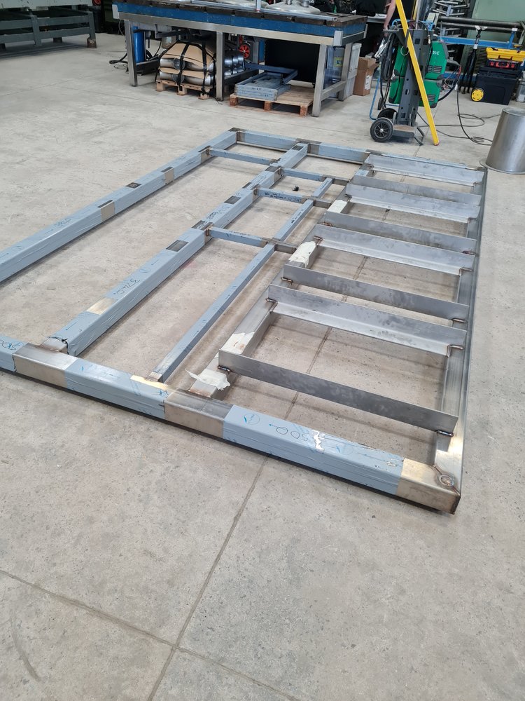

Fixed, sort of...more straightened.
The two guys making it managed to put best part of a 15mm bow in it, mainly from welding the angles on, then not knowing what to do to sort it, i got pulled on to it to sort it for them.
Bit of clamping, and strategic flame straightening here and there...
Sat on the floor after, all lasered in about +/- 1mm.
If you've ever done much with stainless you'll know it can be a pain to keep straight.
100*5 stainless box.
