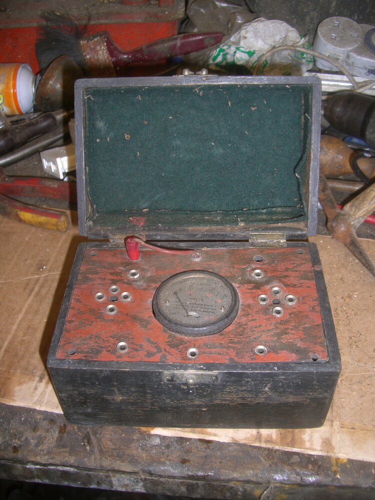

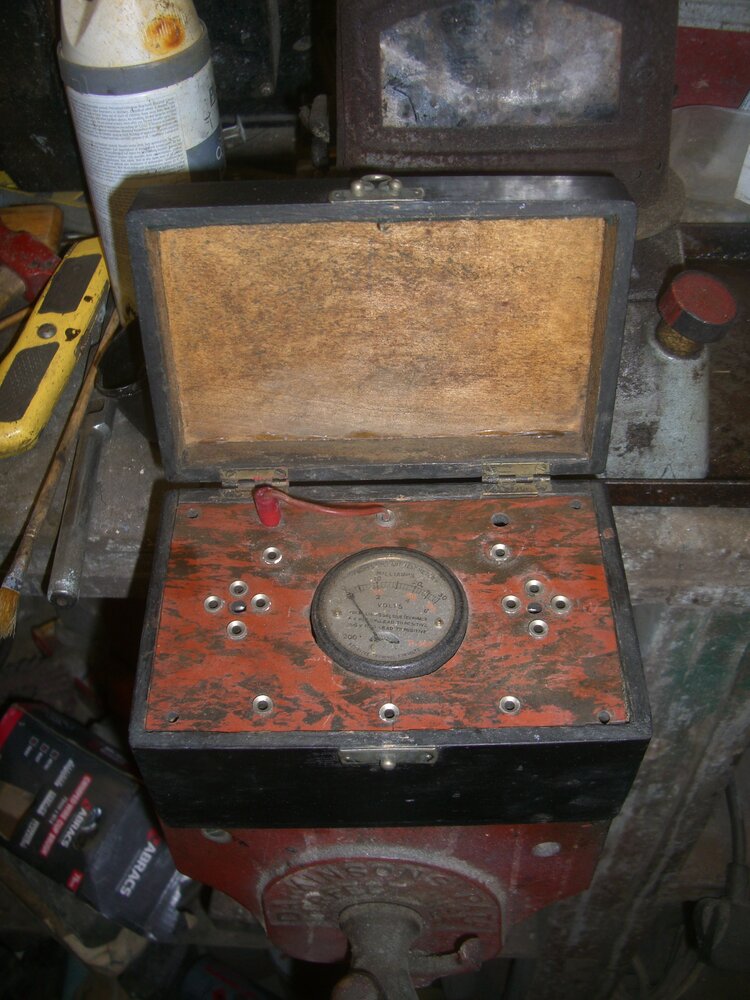

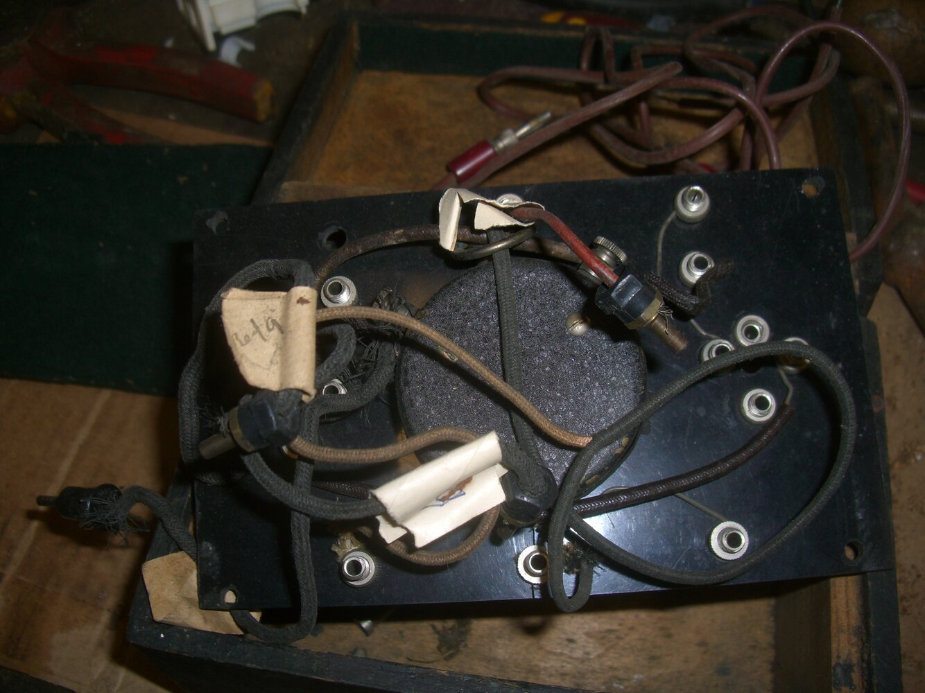

A lot of head work was needed to work out the connections.
This needed addressing as well.

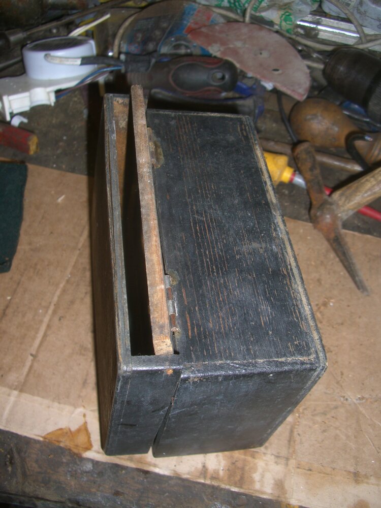

I guess that welding box must have been RAF or Navy kit for the Army ones I used May 1966 to Dec 1980 were usually painted in dark green glossView attachment 534643

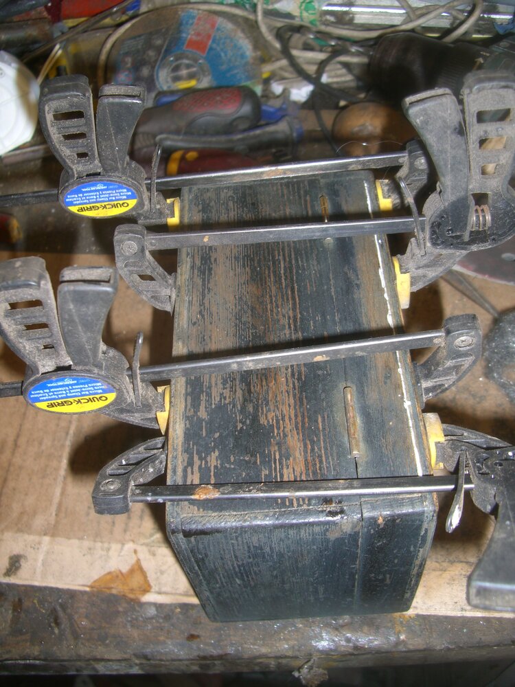

Re varnished after the repair.
The delamination of the ply wood was repaired by glueing the loos parts down and in one case patching it.
All age related dents, ding and scatches were left.

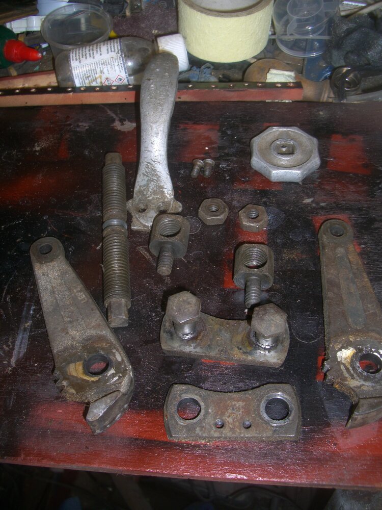

Waxing the parts.

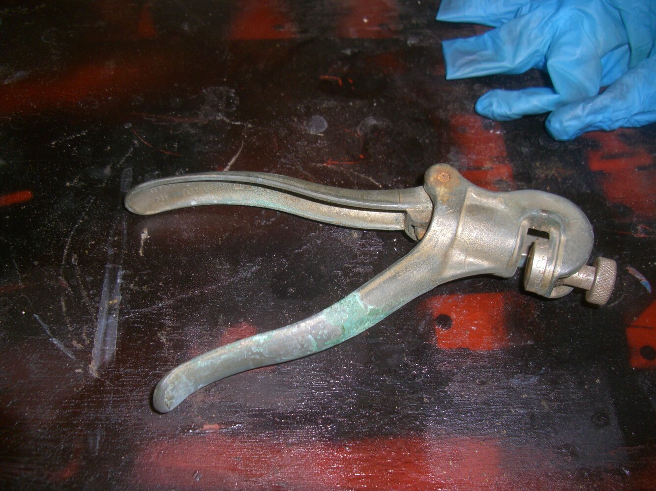

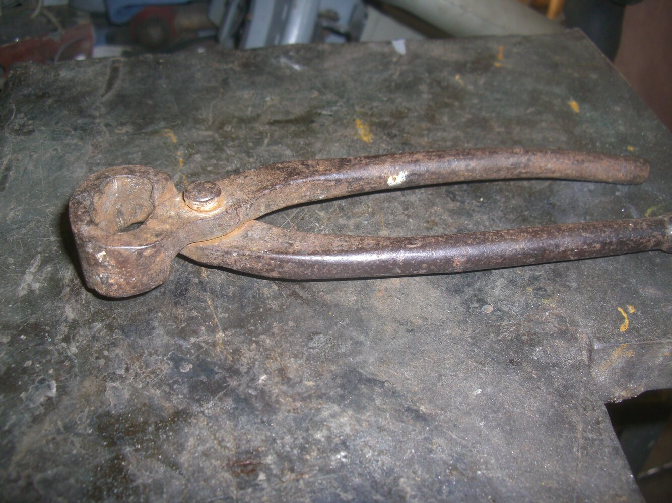

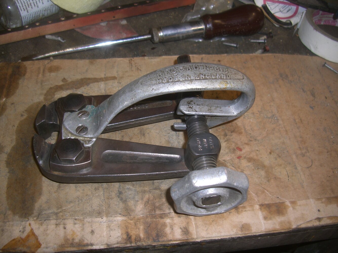

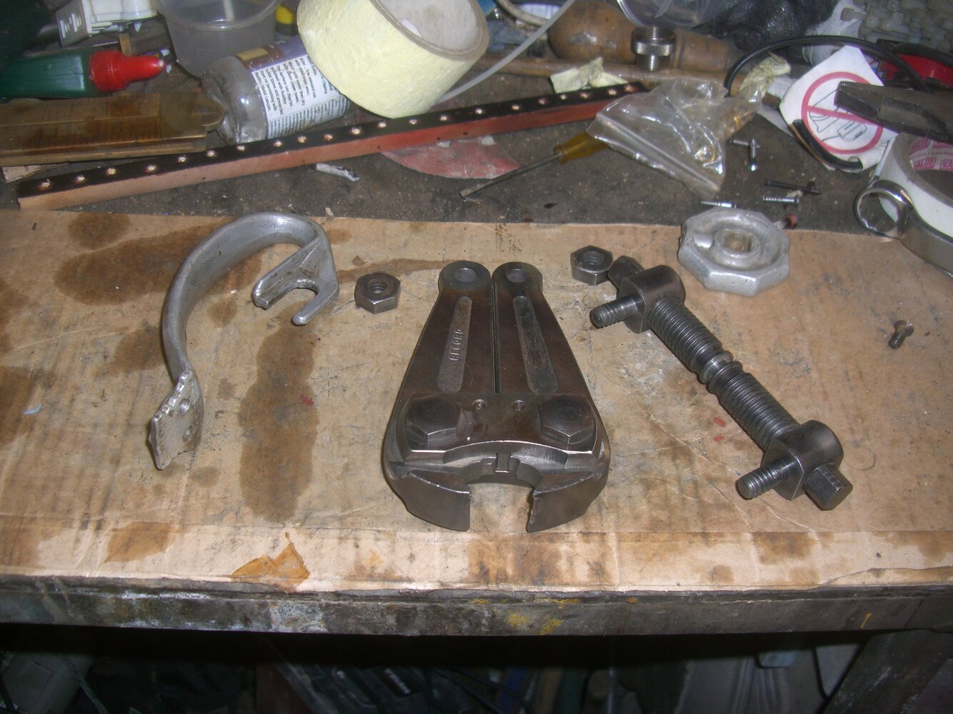

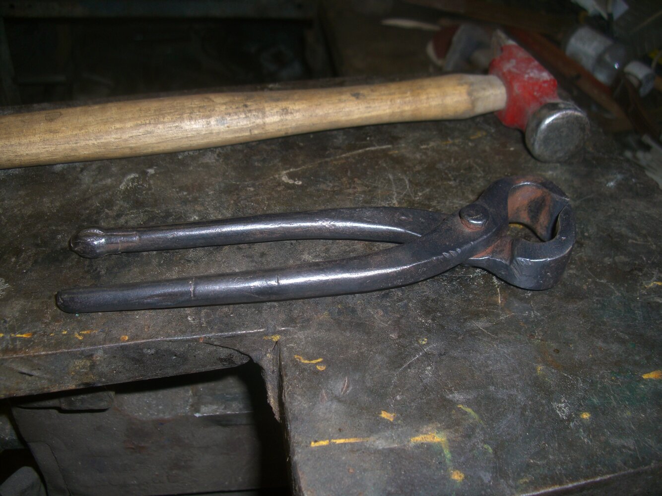

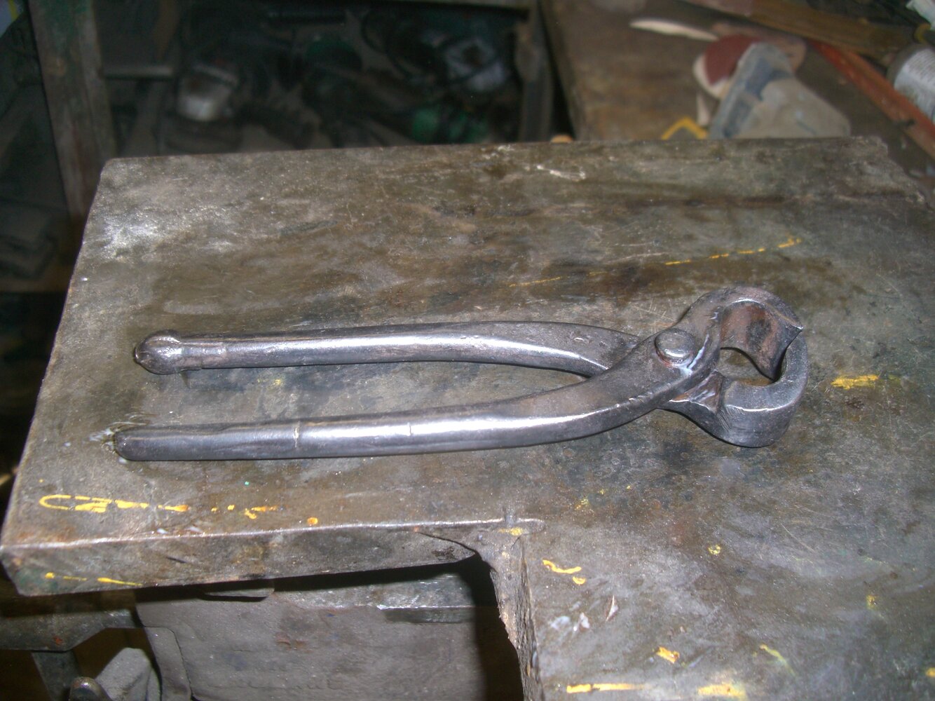

Using a gas flame, with reduced O2 the pliers were heated u. You can see the red oxid going black. Apart from the areas I missed.
In this case I used a wax and oil mix.Interesting. So you heat the metal, the rust goes black, then what?
Or I let it cool in a dry(as much as I can) air place to cool, then paint.
I have in the past, but a rub with a Meths soaked scotchbrite pad will give a good clean key for rattle can paint.You paint straight over the blackened rust?
