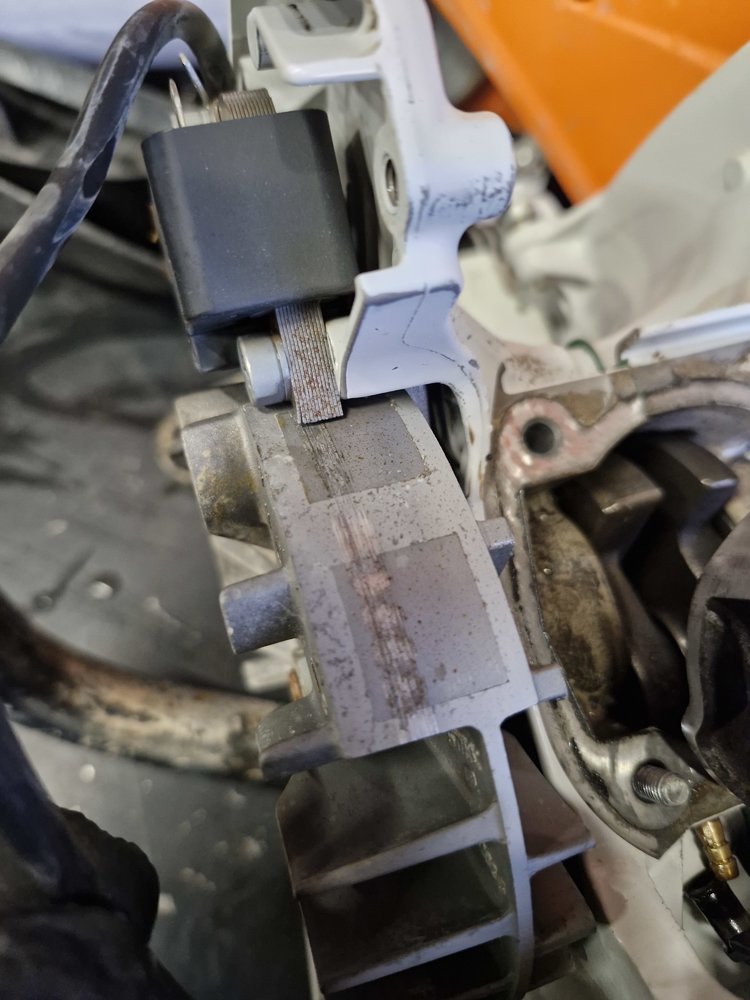

I'm told a fix for this is to enlarge the coil to flywheel gap. I measure it at ~0.35mm with feelers. I tried adjusting and at 0.45mm theres no difference.
Its not easy to do! Currently Im putting a feeler in the gap but the thicker feelers have a bit too much spring in them. I'll try 0.8mm tomorrow, perhaps I can find some suitable plastic.

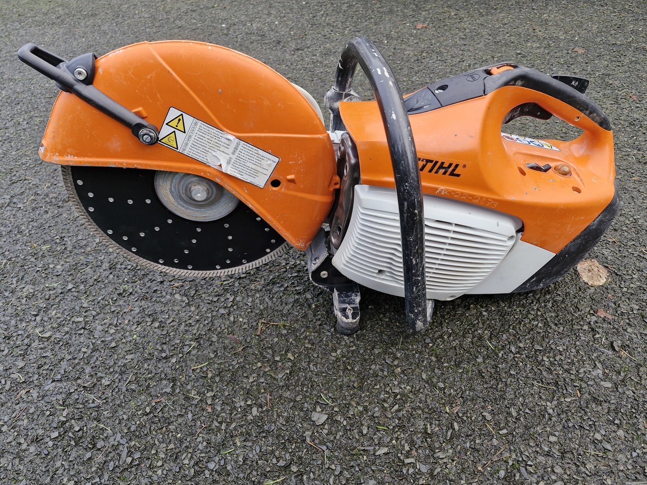

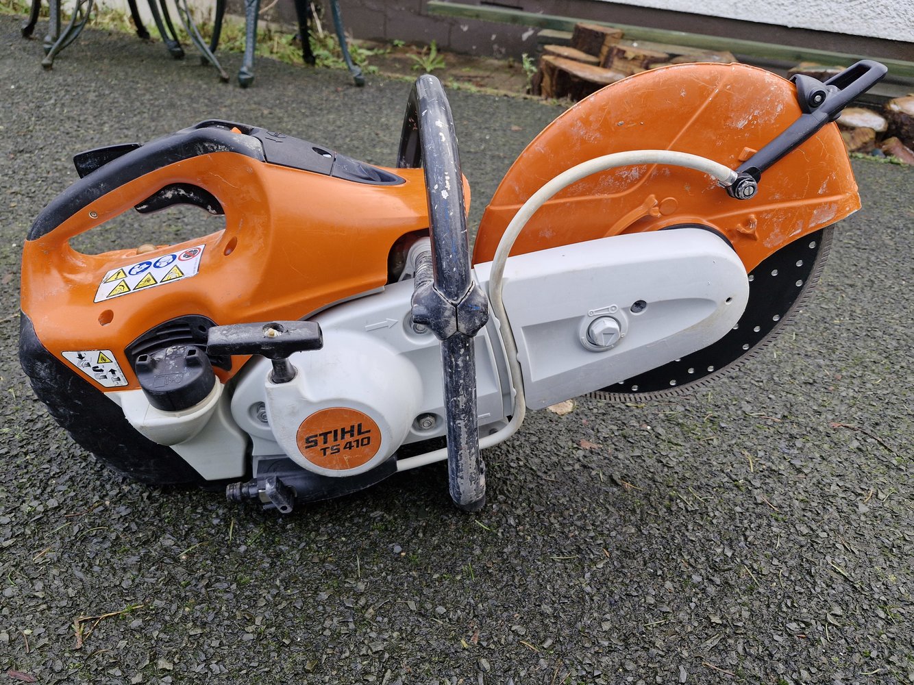

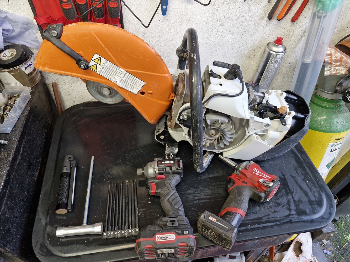

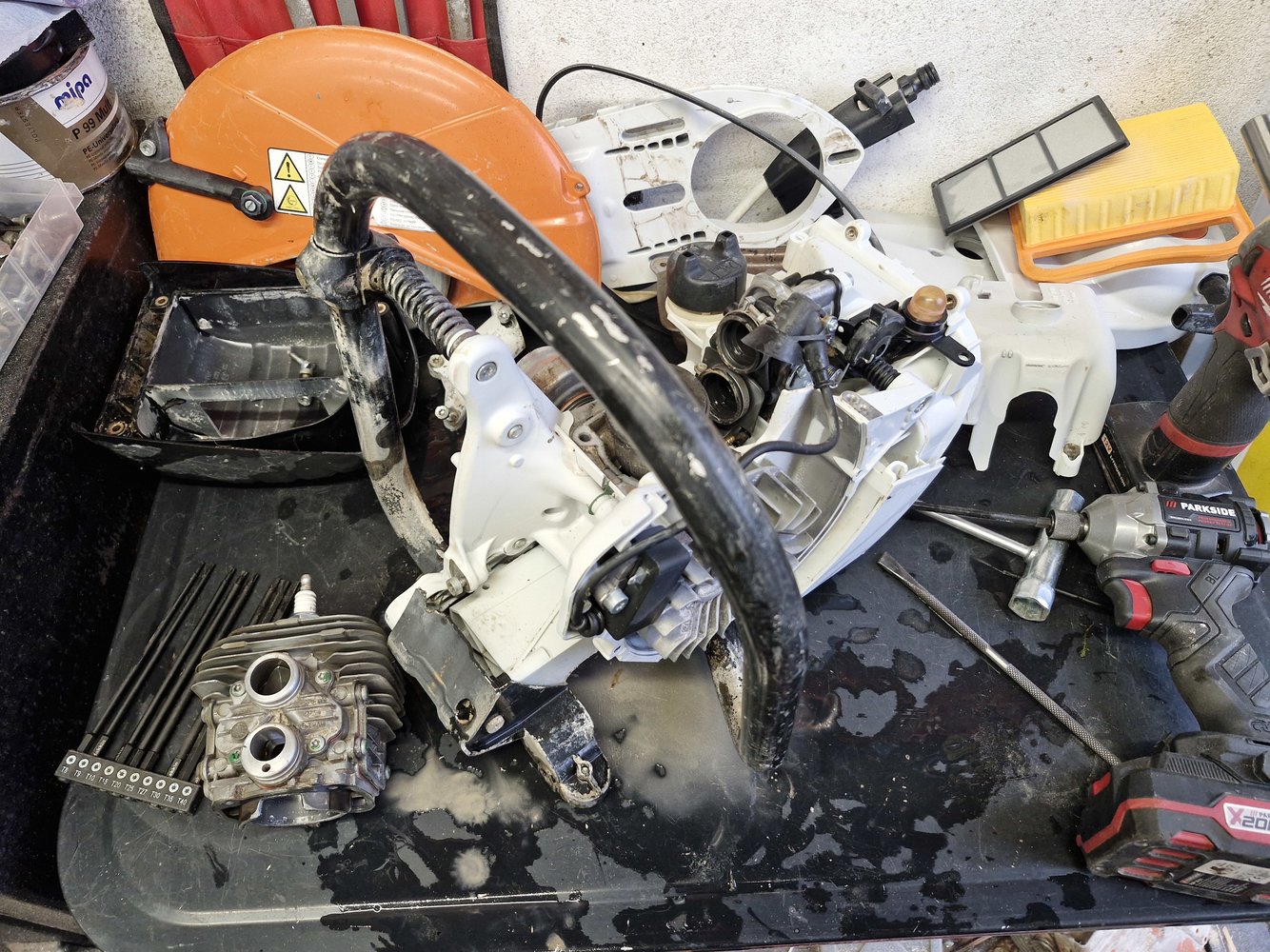

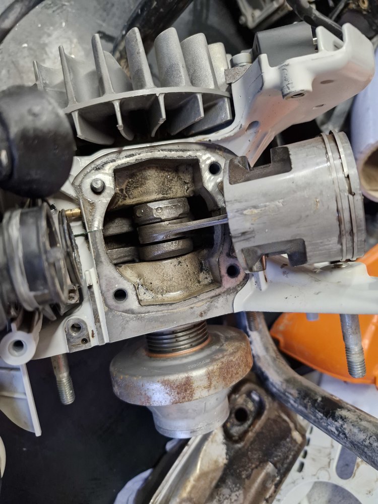

It got it tore down. It's the main bearings are badly worn and causing issues. So yet another mis diagnosis! The original Stihl cylinder is like new. The piston could be re used but has one weird scratch on it. I'm almost certain someone jammed a screwdriver in there as nothing else could have caused it. I could sand it out but I think it's best get a new aftermarket piston for it.
Some additional clues for the crank bearing issue:
Anyway in terms of parts cost, this one will be a relatively cheap fix. They also installed brand new air filters and likely charged the guy for that and their mis diagnosis.
This saw is so clean it may end up staying in my collection I'll see.

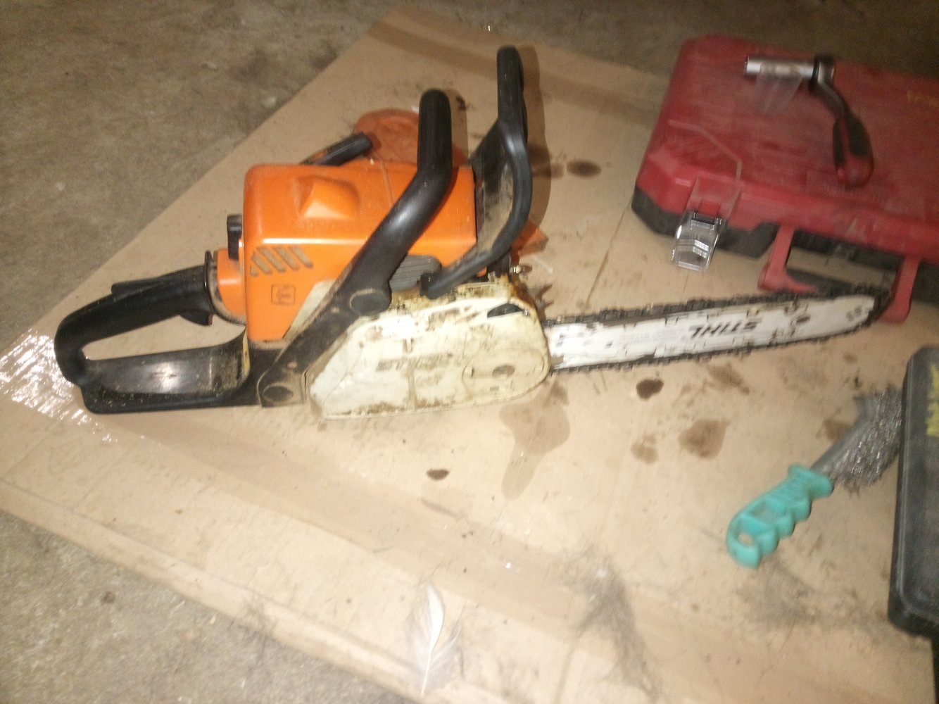

I can't remember what model it is, the labels fallen off recently, I'm getting oil below the exhaust muffler.What saw is it?
Get the bar and cover off, rinse the oil tank with a bit of petrol, drain and wipe the outside dry with a rag.
Add a little petrol or light oil and hold it bar side down and if hose before oil pump is split you will see it peeing out.
It doesn't seem to be blocked, just leaking.
Is there a rubber pipe or does the oil pass through passages in the plastic moulding ?
I'll get photos tomorrow, thanks.Not sure about that vintage saw, but it should be easy to open up and check.
Start by removing the bar and chain and poke wire through, make sure the bar's oil feed is clear. Then there should be removable covers to inspect the oil pump and any associated plastic lines.
