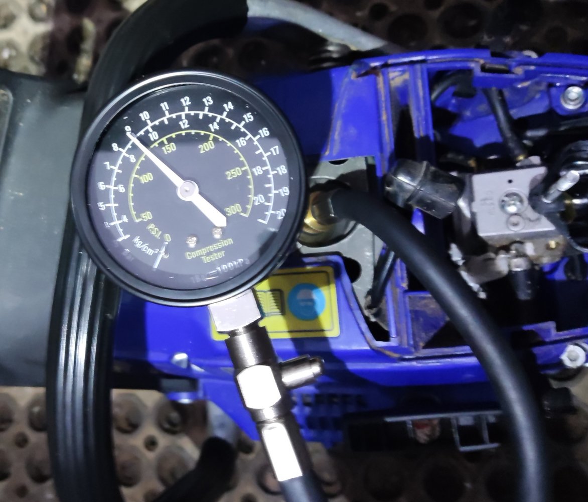

Ahh, yes, the muffler is a bit loose, what you're saying makes perfect sense. My fault.It's not uncommon for the muffler screws to come loose, gasket gets blown away and the exhaust gasses get thrown at the plastic crankcase/oil tank and melt it. Easy to check just pull the muffler.
So have I melted a pipe or killed my chainsaw ?
