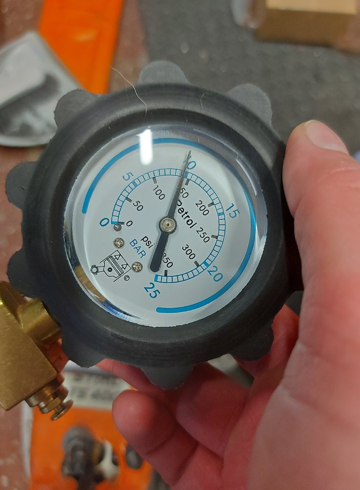

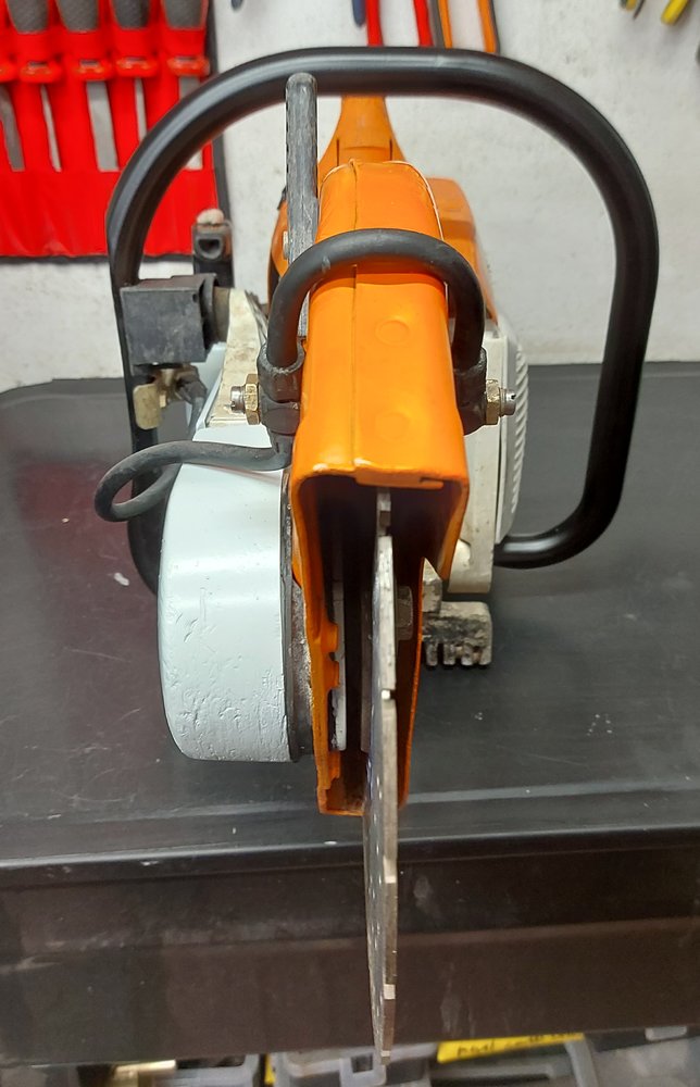

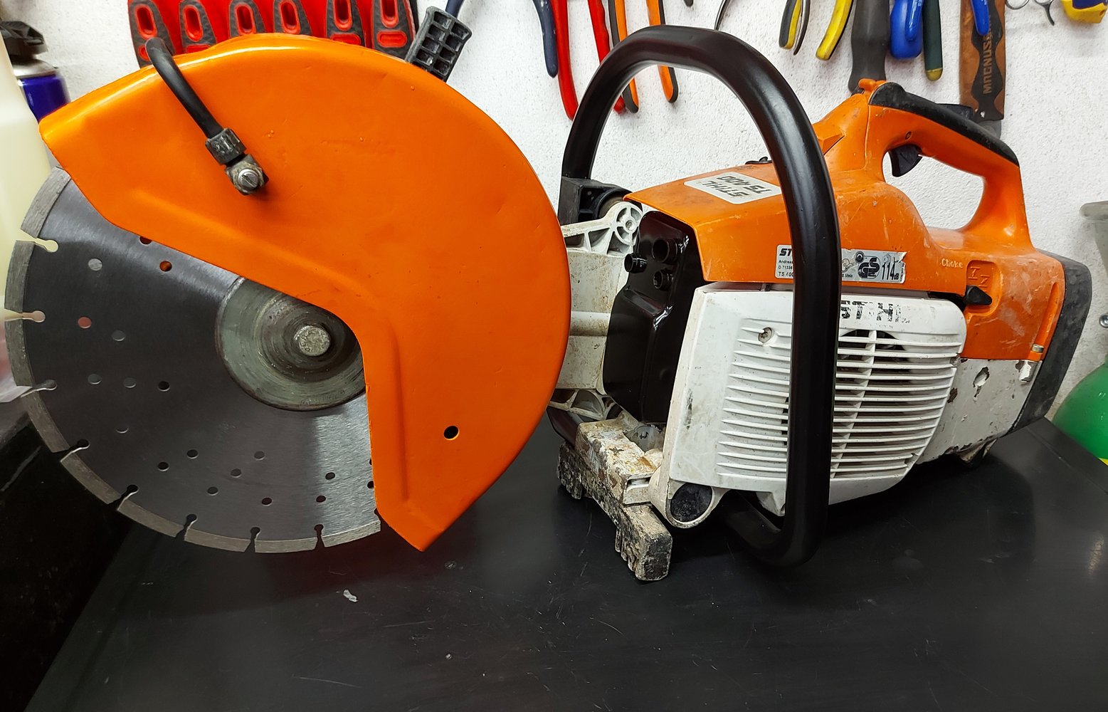

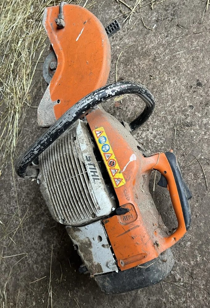

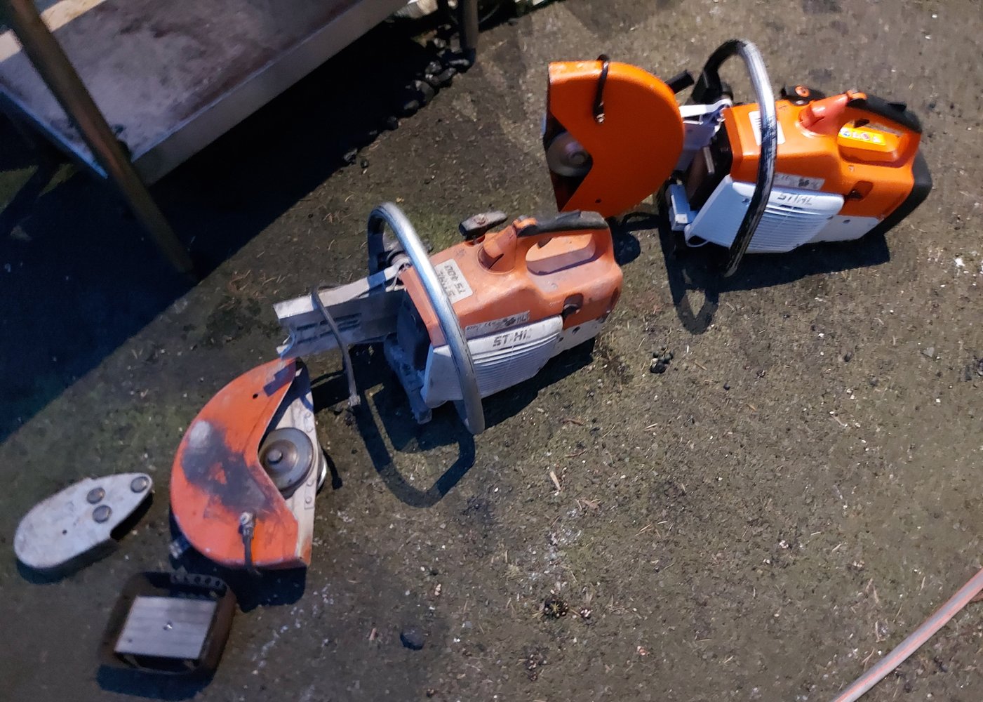

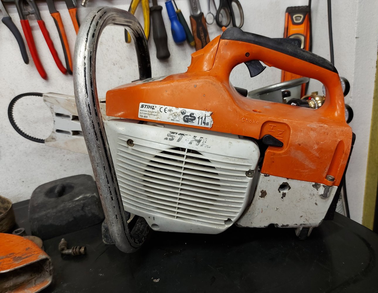

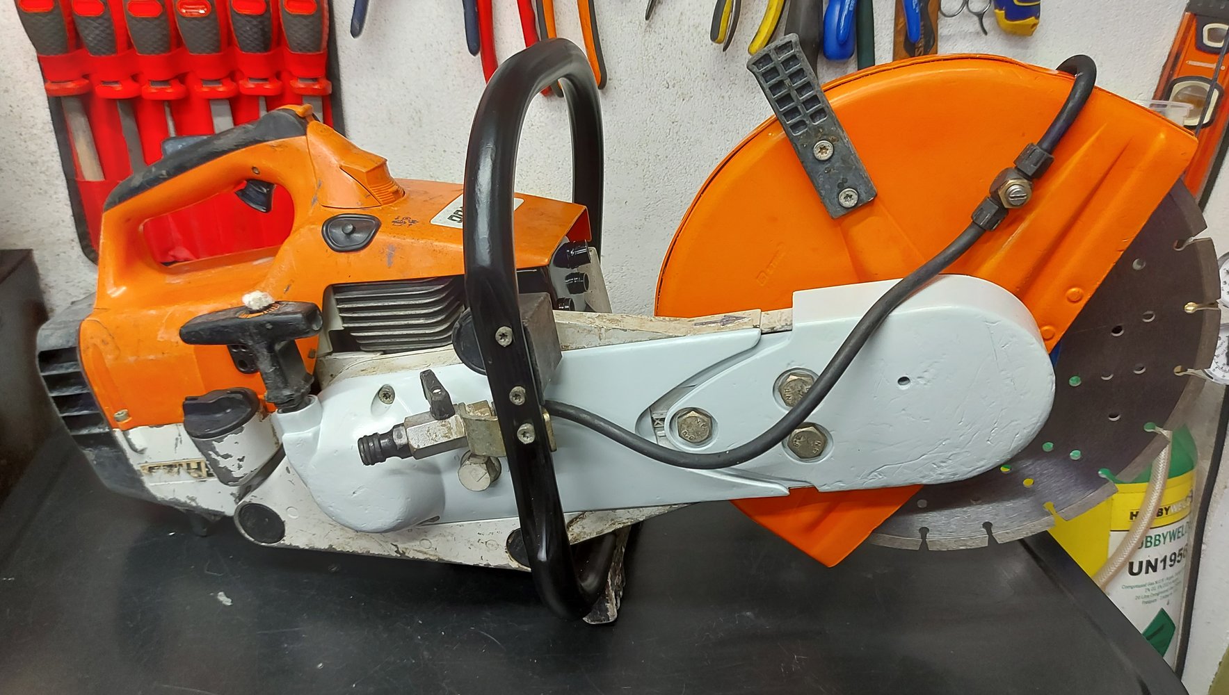

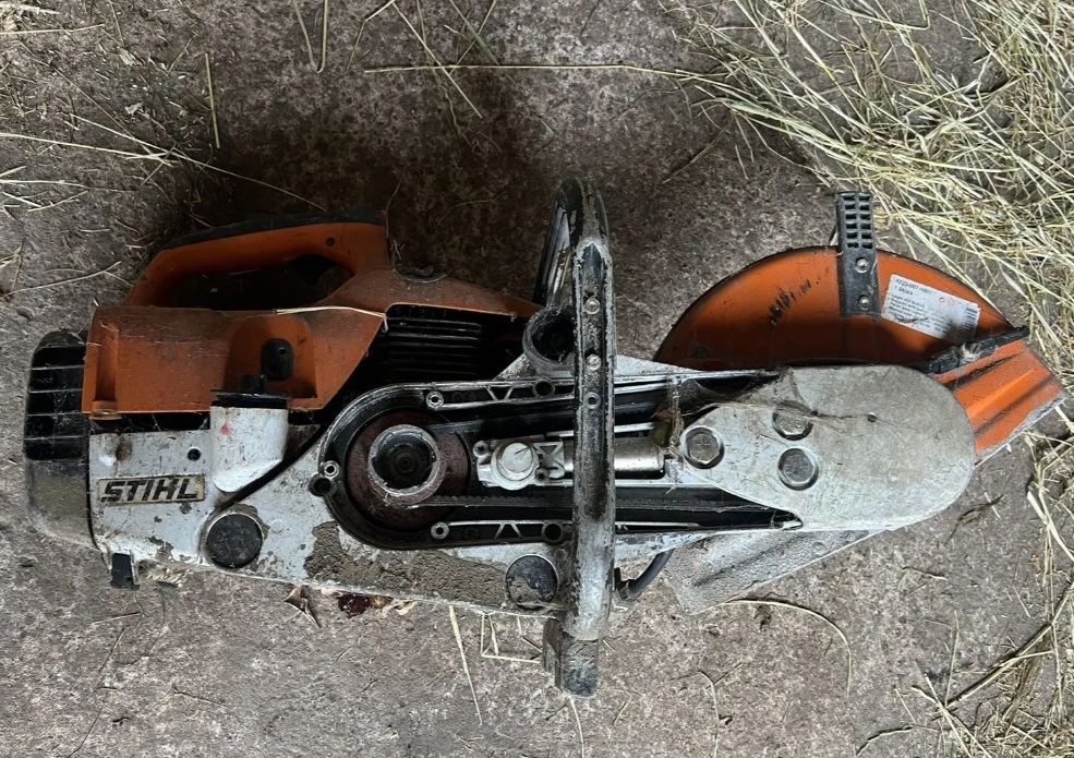

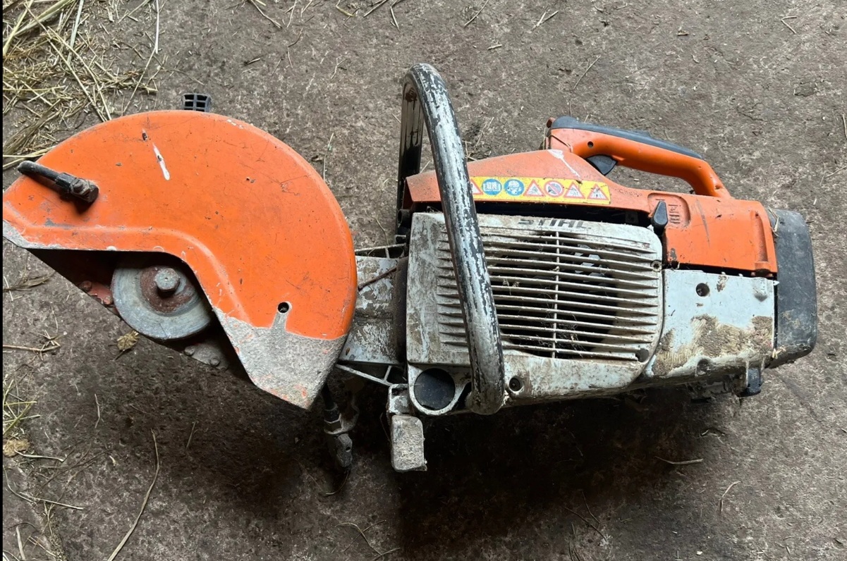

I won this for £89 on ebay by mistake as no one else bid! That is a spares / repairs Stihl TS400:
(The bottom one. The clean one that needs nothing also arrived today!)

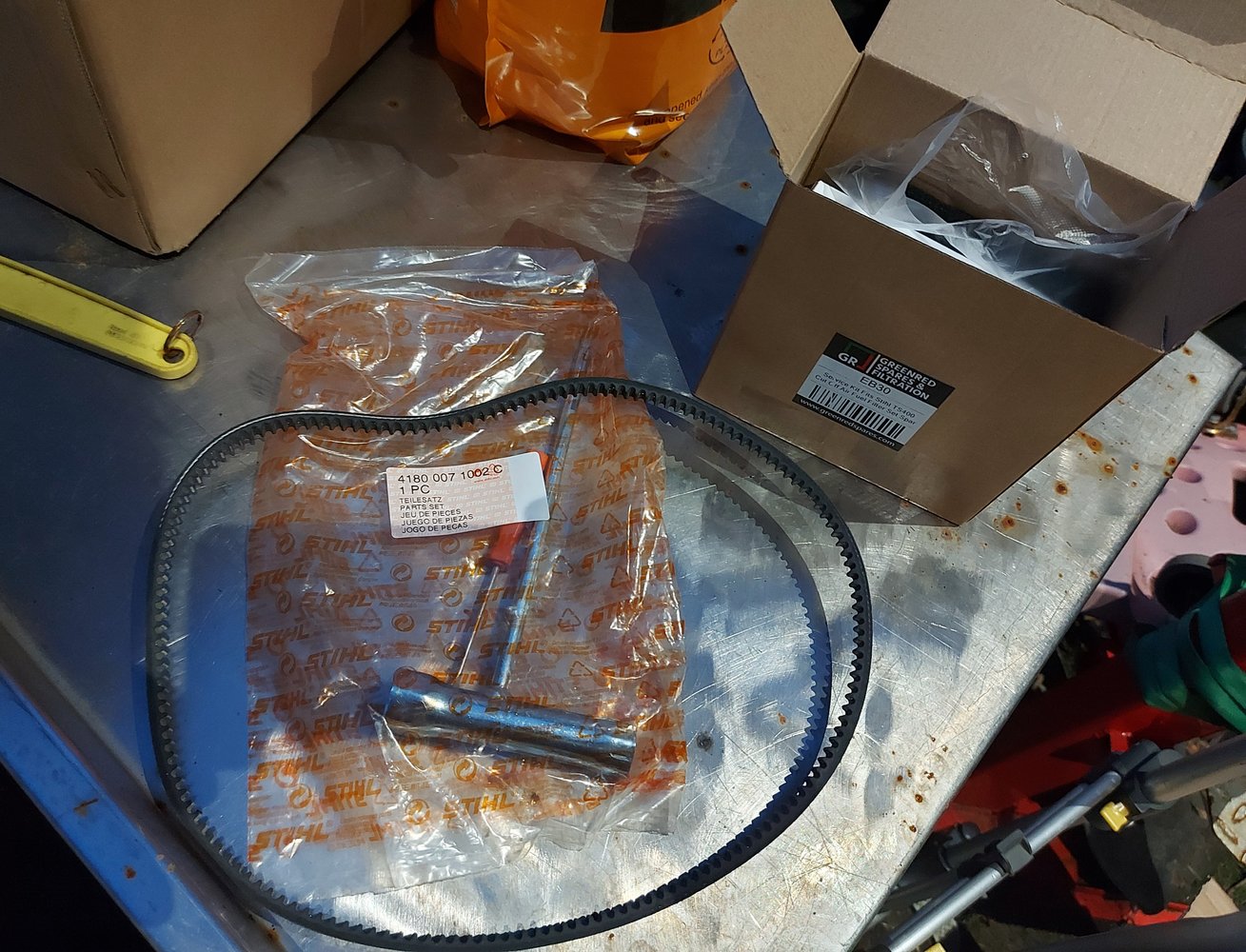

Along with a service kit and belt as I knew that was missing

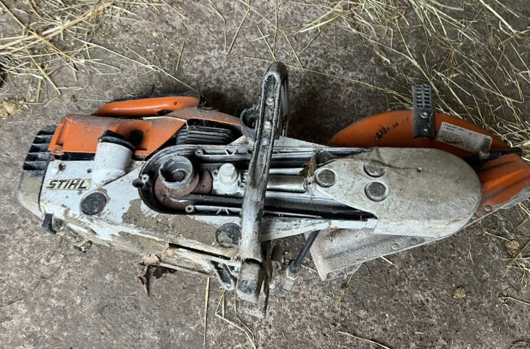

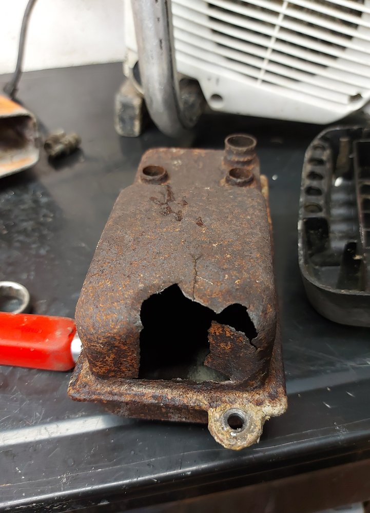

The seller had put nothing in the add text wise. He forgot to mention the exhaust was partly missing:

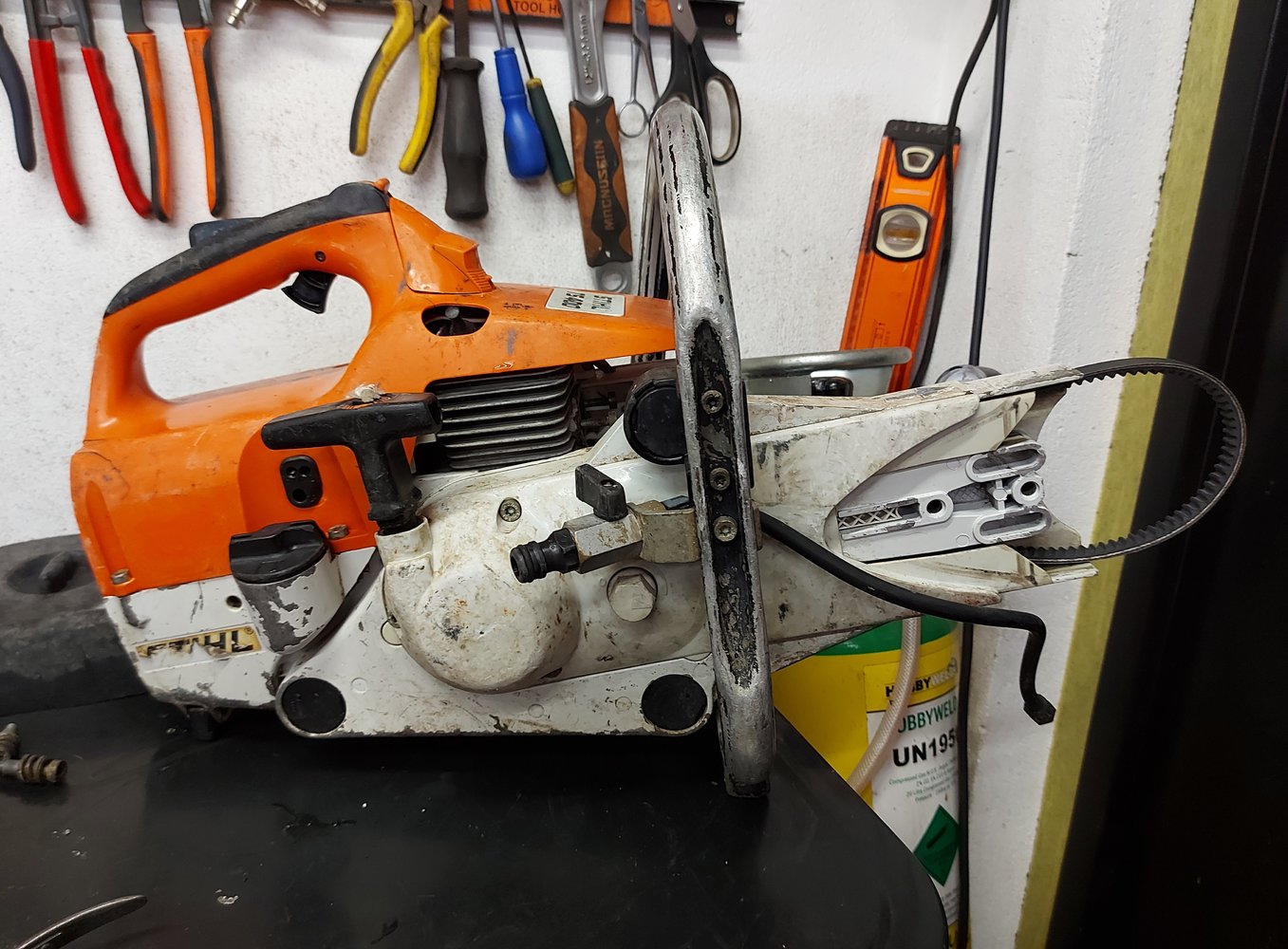

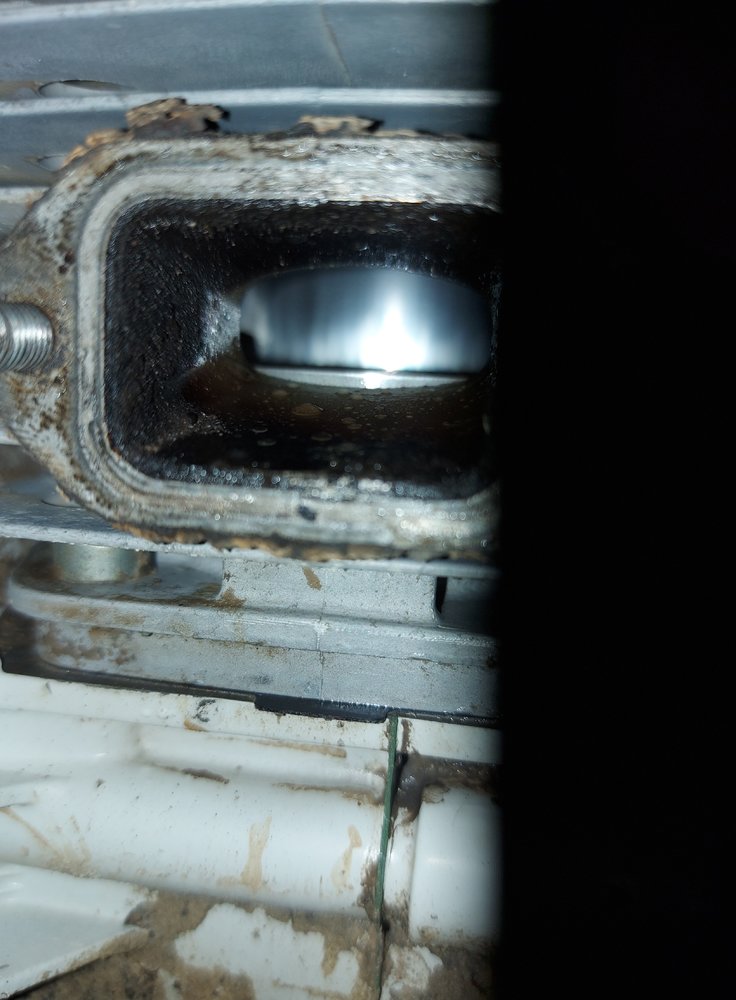

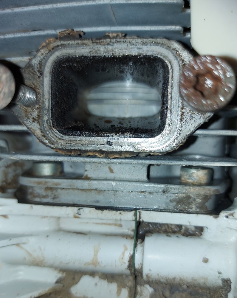

But what was a very pleasant surprise was that I added fresh fuel and it fired right up and ran very well. Starts at a whiff of a pull etc. So Carb and engine running order appears superb.

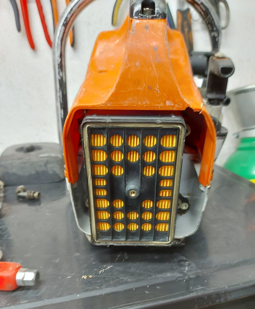

I did wash the air filter housing and fit new filters
Photos are terrible but the piston looks pristine yet original barrell. The cylinder also looks mint inside.

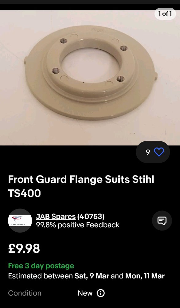

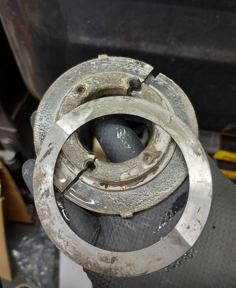

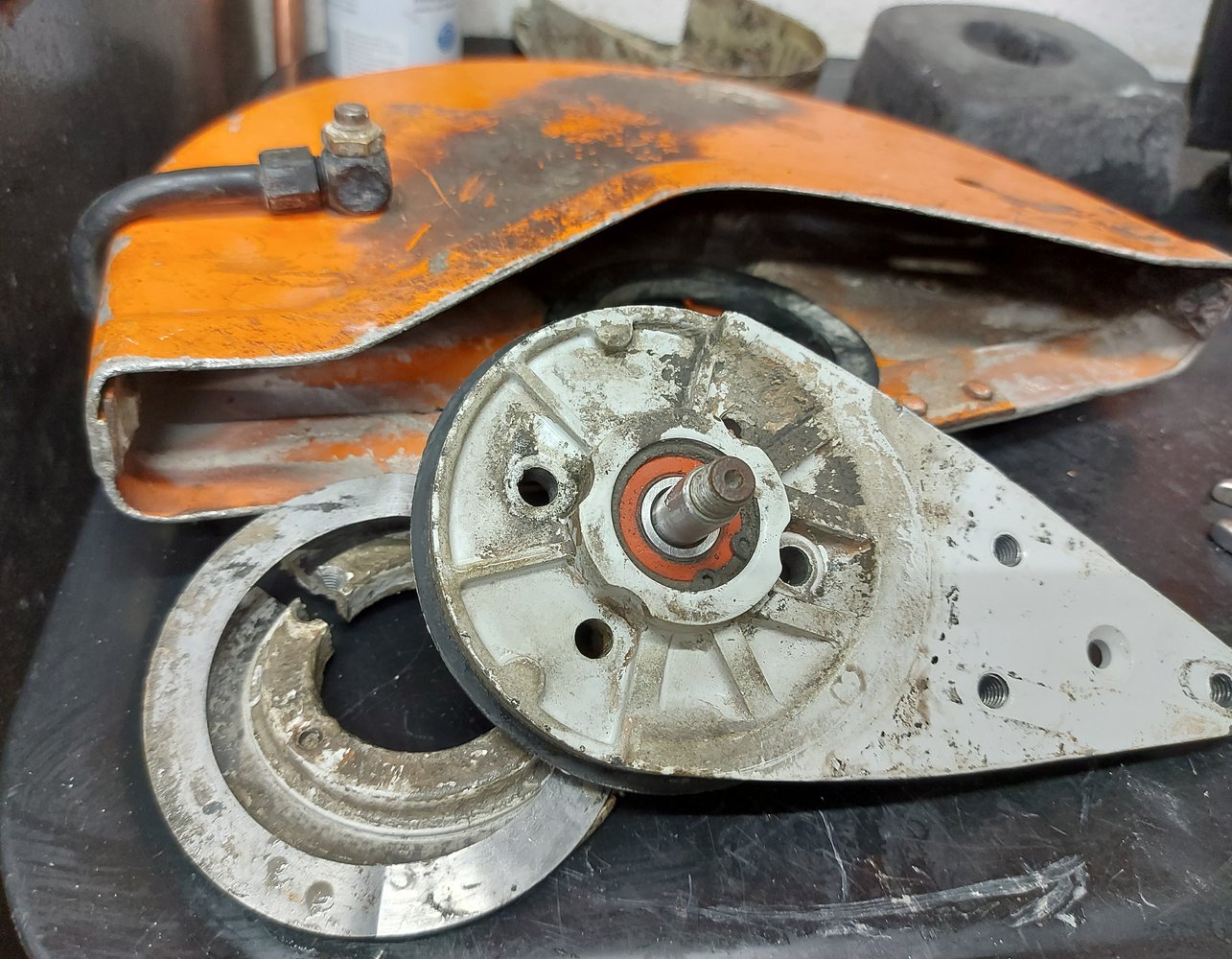

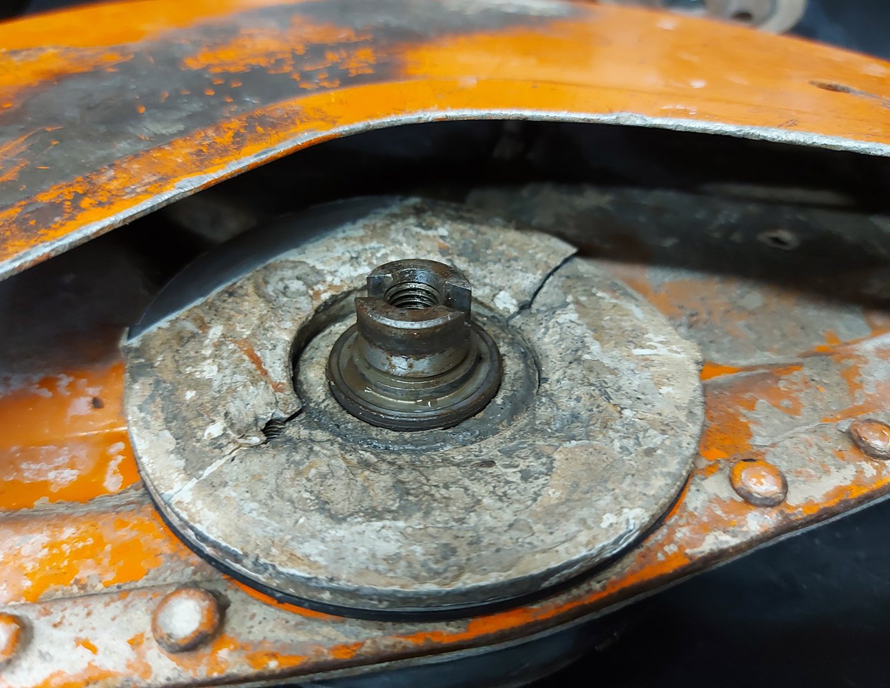

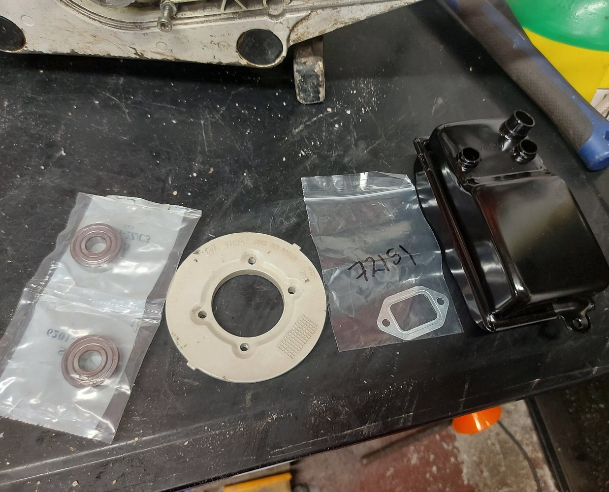

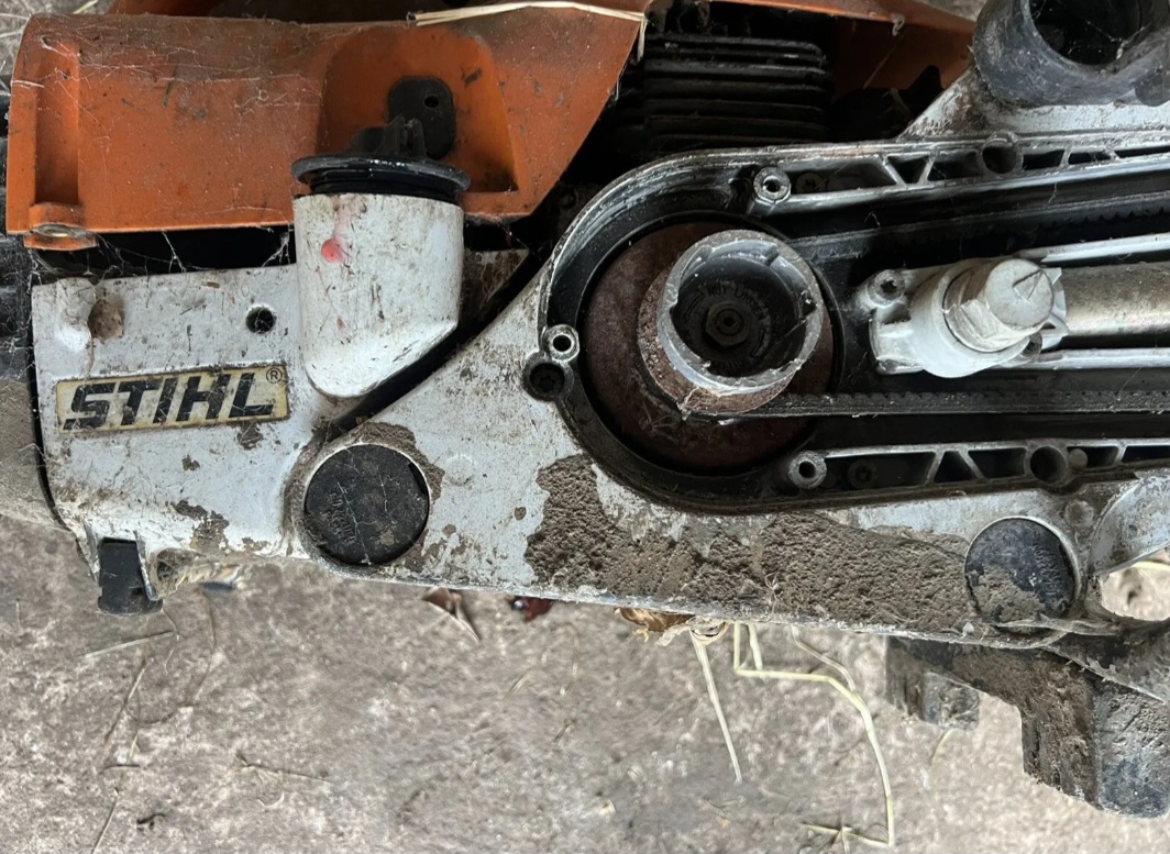

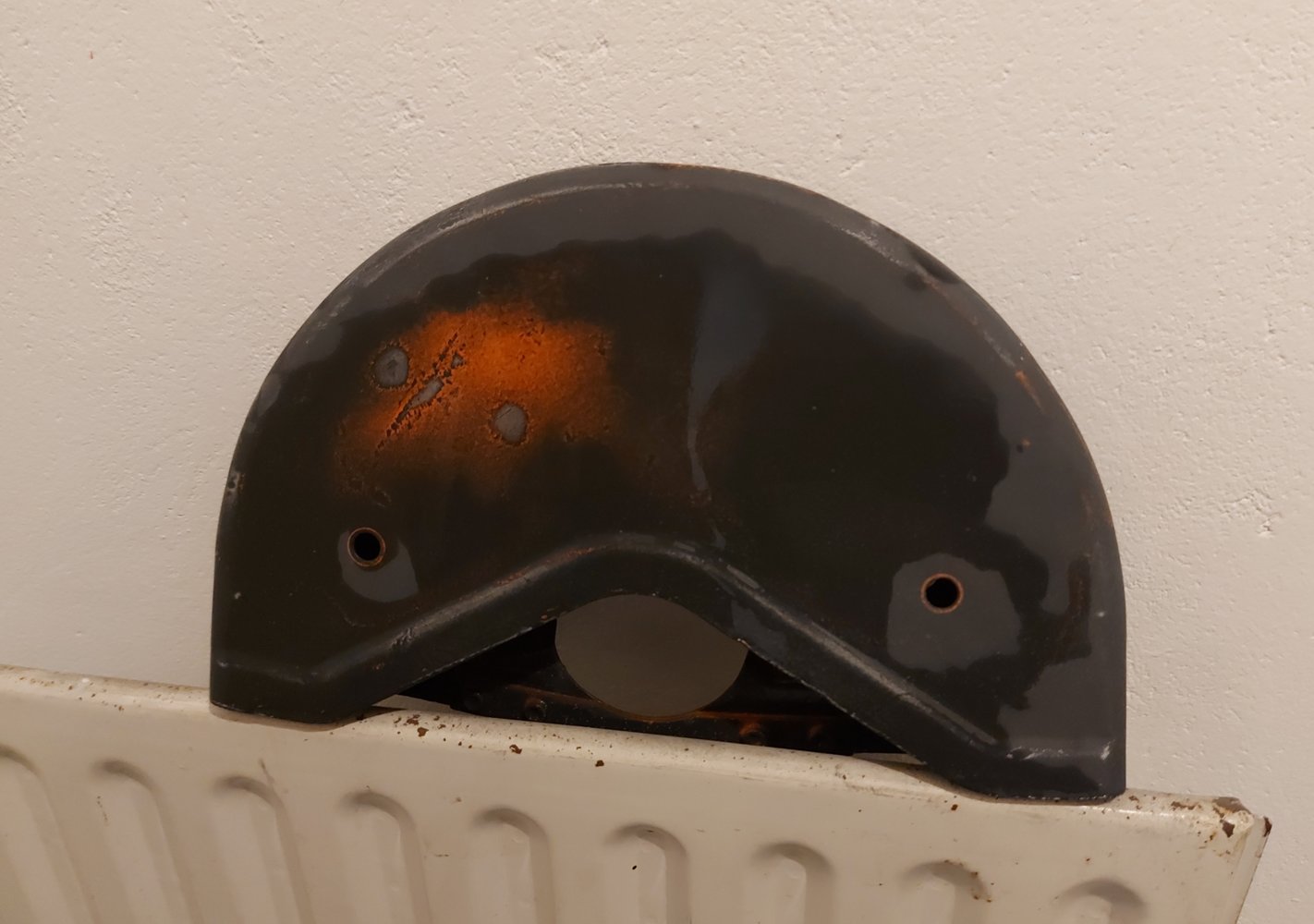

There are some more parts I need but not half as bad as I expected. The blade shaft bearing is bad and there is a cast bracket cracked half in two there with no chance of welding it so I'll find one on ebay or if a member has one spare please let me know

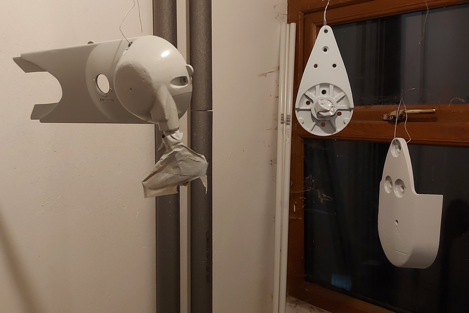

I may spray the blade guard now it's off too because I am weird like that!
