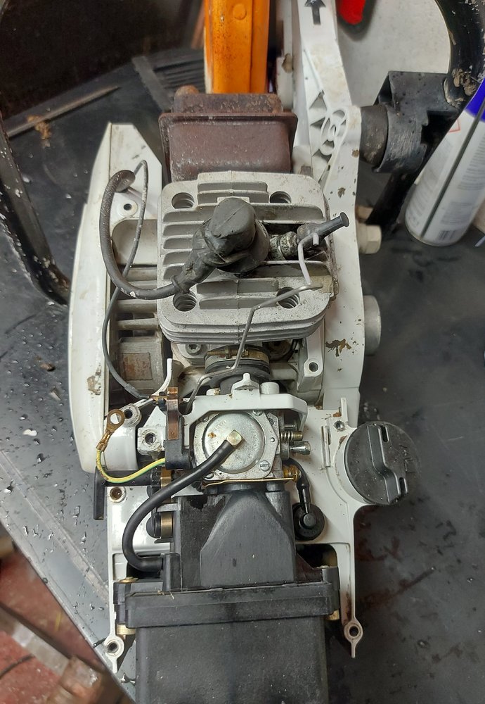

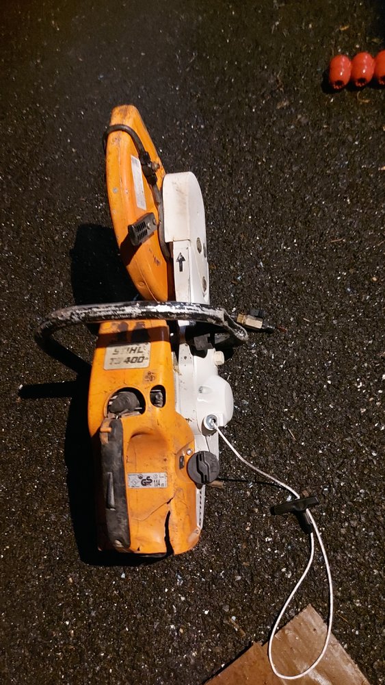

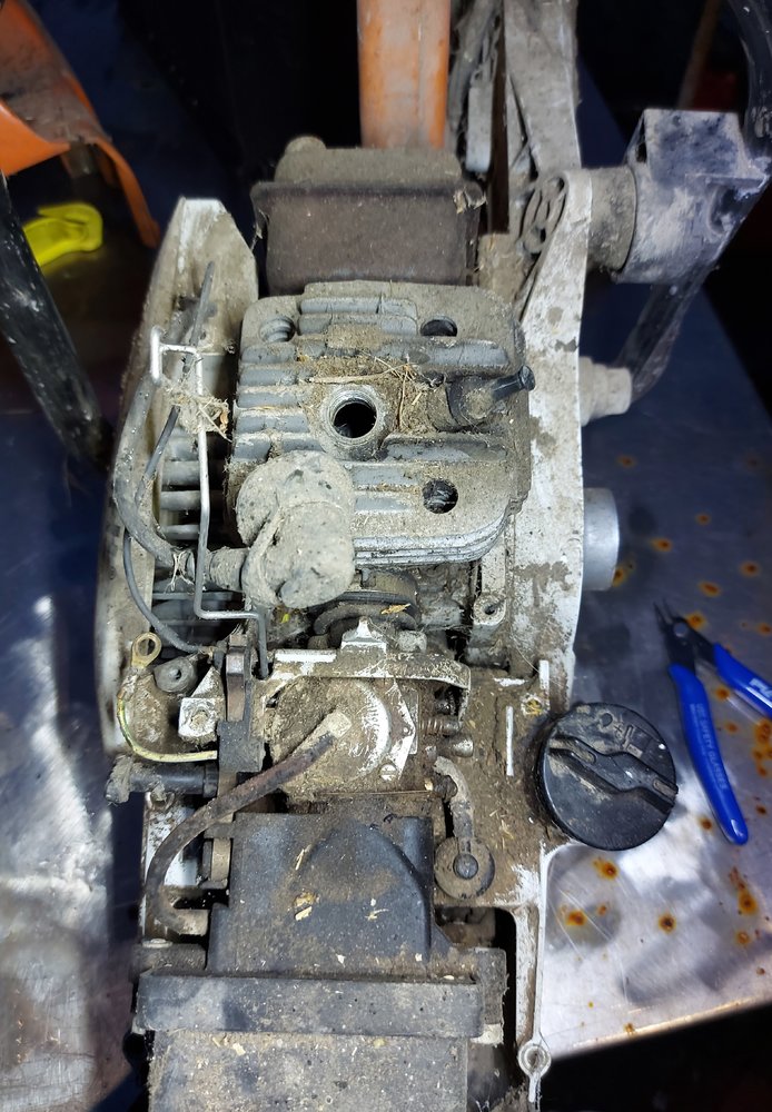

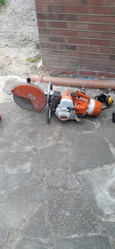

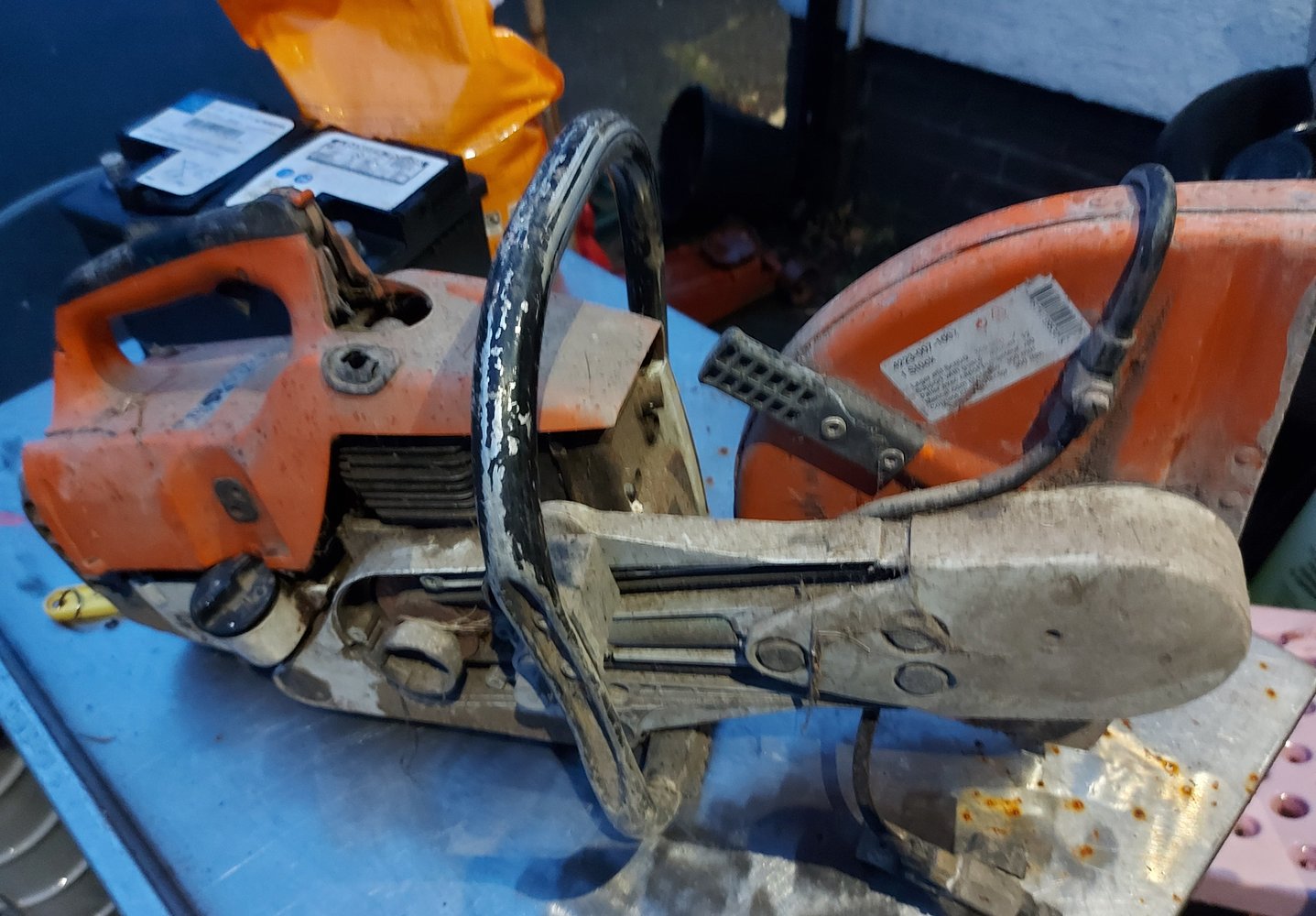

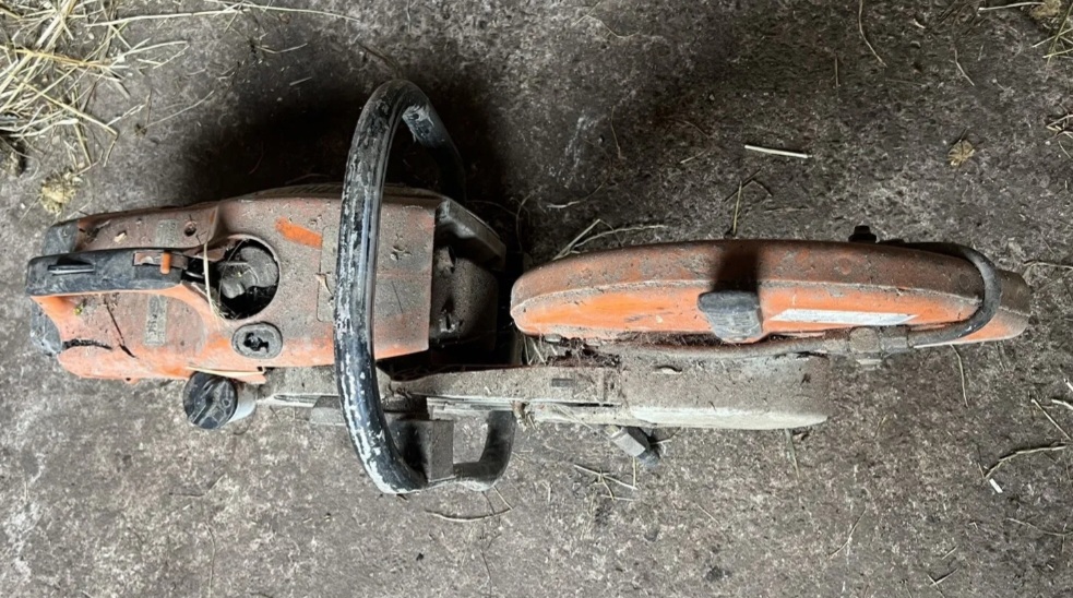

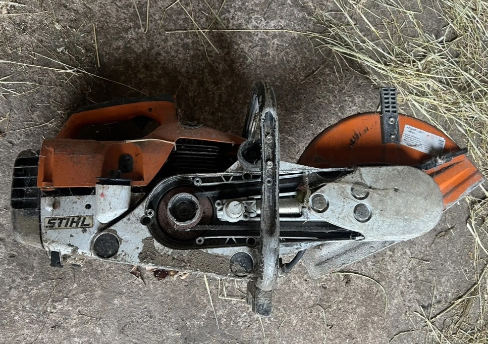

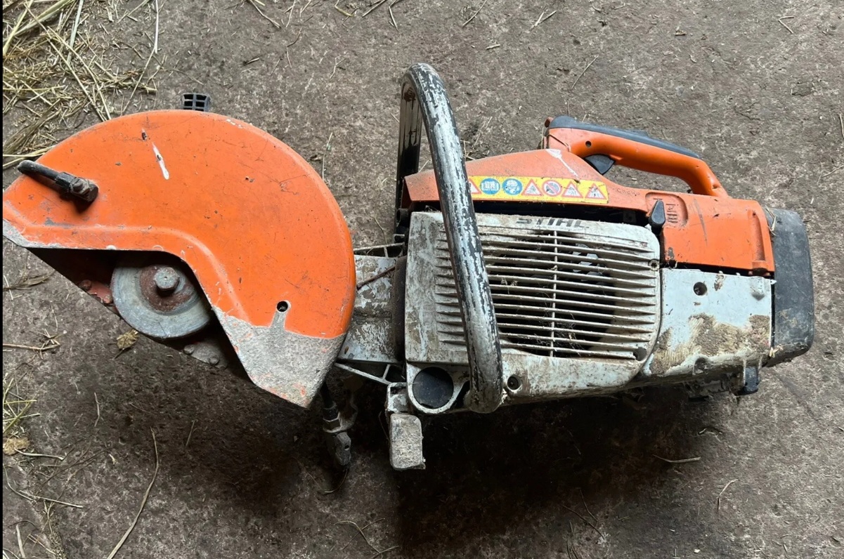

This is the 3rd one still in the post should have it this week. Under the dust and aparant concrete dip event it appears quite a little used / abused saw.
View attachment 442375View attachment 442376View attachment 442377View attachment 442378View attachment 442379View attachment 442380
I already have ordered and received new bolts and a starter pull cord assembly. That is what I can see is missing from the pics, hopefully nothing more than that will be missing as it looks like someone had had the top cover off and not put it back on correctly.
I bought it from ebay as untested/ spares repair sale at £85. First mission will be to steam clean the whole saw then fit a new service kit and fresh fuel and see if it starts. Who knows could turn up seized for all I know.
If you ever buy one in person let the saw hang from the cord, if it walks down the cord it needs a piston kit, if it holds its own weight without dropping its a good unmake sure the decompresser plug is closed though.

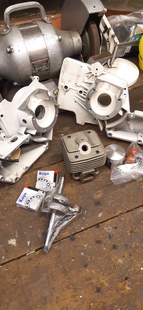

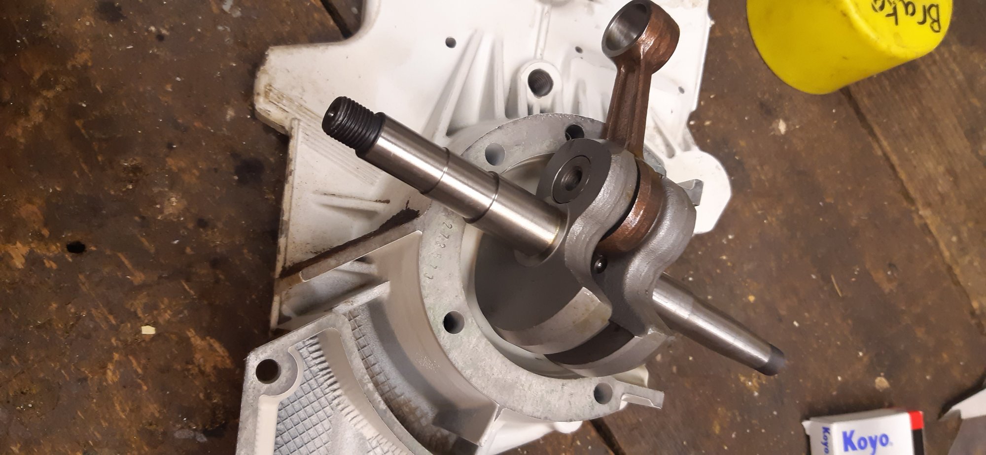

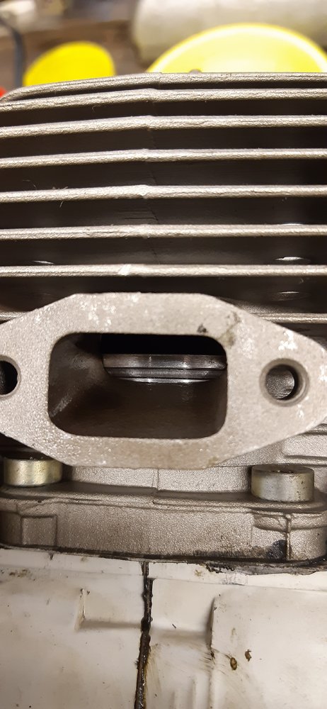

Have some naked Stihl saw shots.What are your experiences with aftermarket piston kits on these though?
My Husky has recently had 2x different piston kits and both only give 100psi which should really be 150psi with a new cylinder!
And I really doubt their lifespan. Hence personally if I had to do it again it would be genuine parts only.
Have you replaced piston kits in a saw like this and had years of good use out of it afterwards? If so would be good to know just.

Mine get worked to death mate and come out the other end unscathed on aftermarket kits.What are your experiences with aftermarket piston kits on these though?
