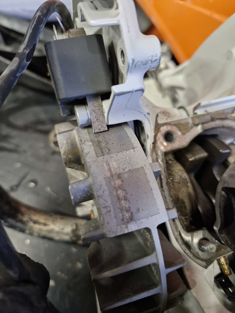

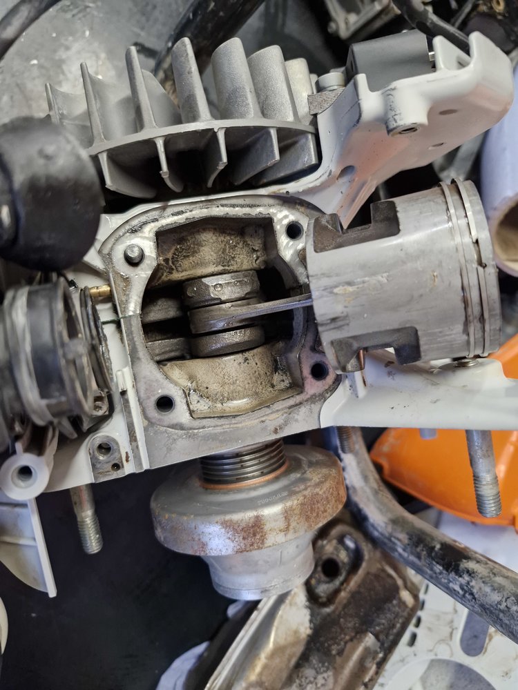

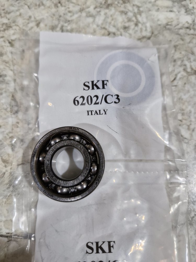

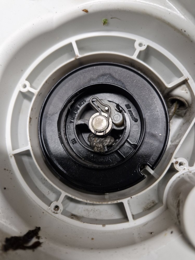

It got it tore down. It's the main bearings are badly worn and causing issues. So yet another mis diagnosis! The original Stihl cylinder is like new. The piston could be re used but has one weird scratch on it. I'm almost certain someone jammed a screwdriver in there as nothing else could have caused it. I could sand it out but I think it's best get a new aftermarket piston for it.
Some additional clues for the crank bearing issue:
Anyway in terms of parts cost, this one will be a relatively cheap fix. They also installed brand new air filters and likely charged the guy for that and their mis diagnosis.
This saw is so clean it may end up staying in my collection I'll see.
