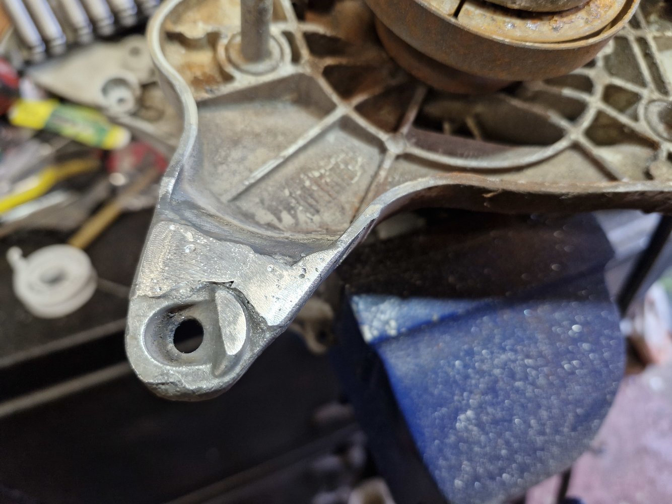

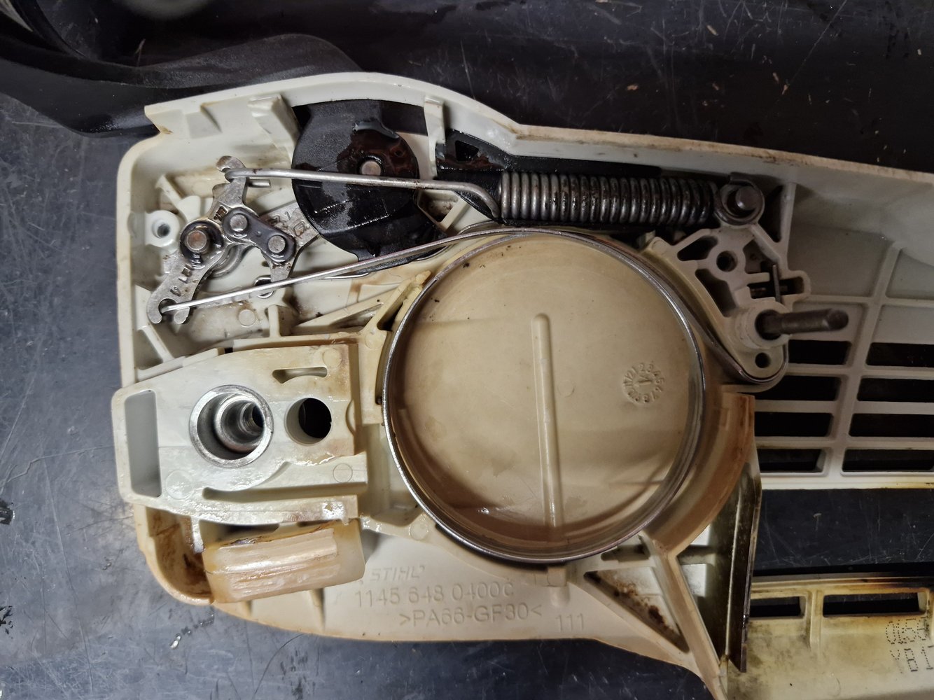

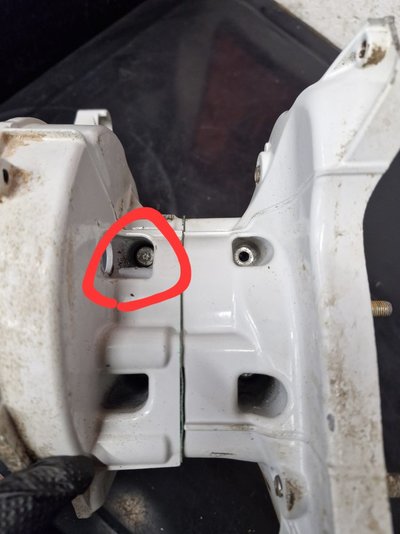

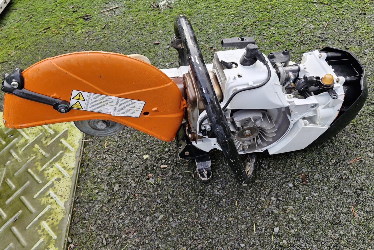

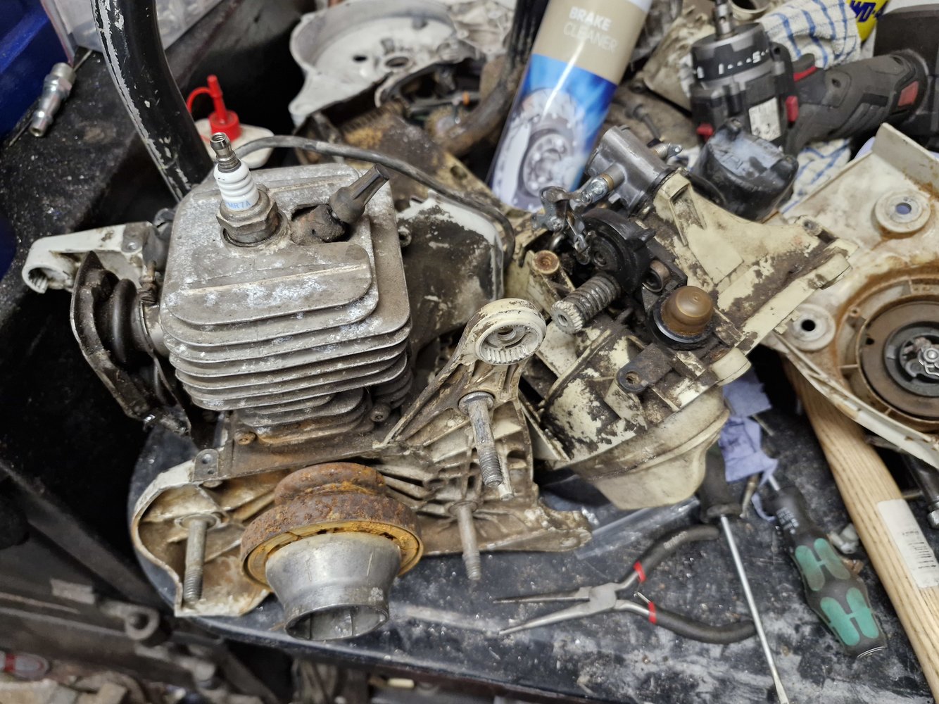

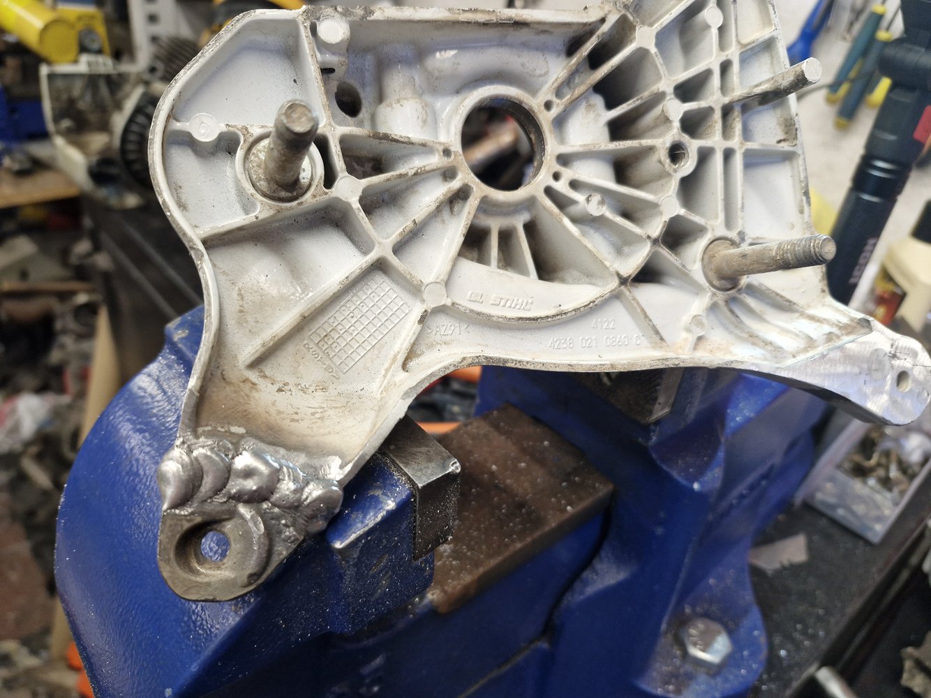

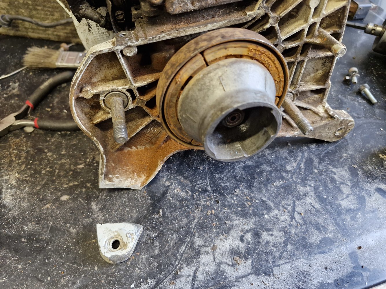

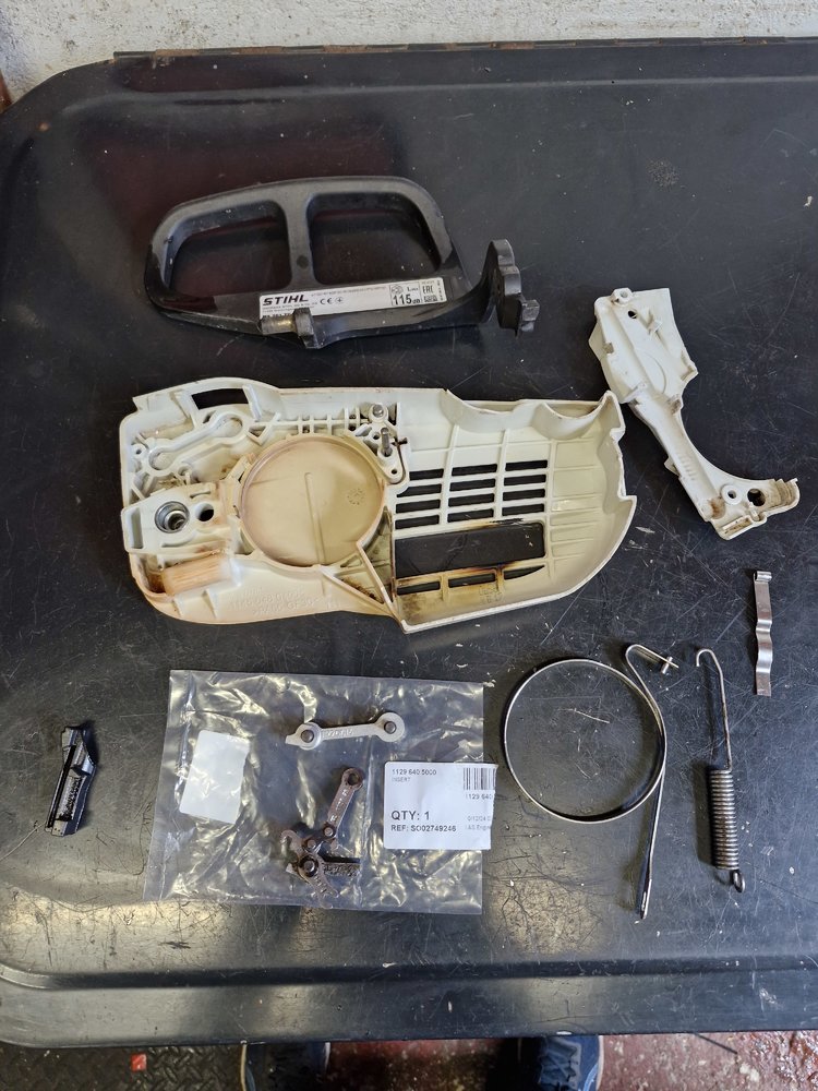

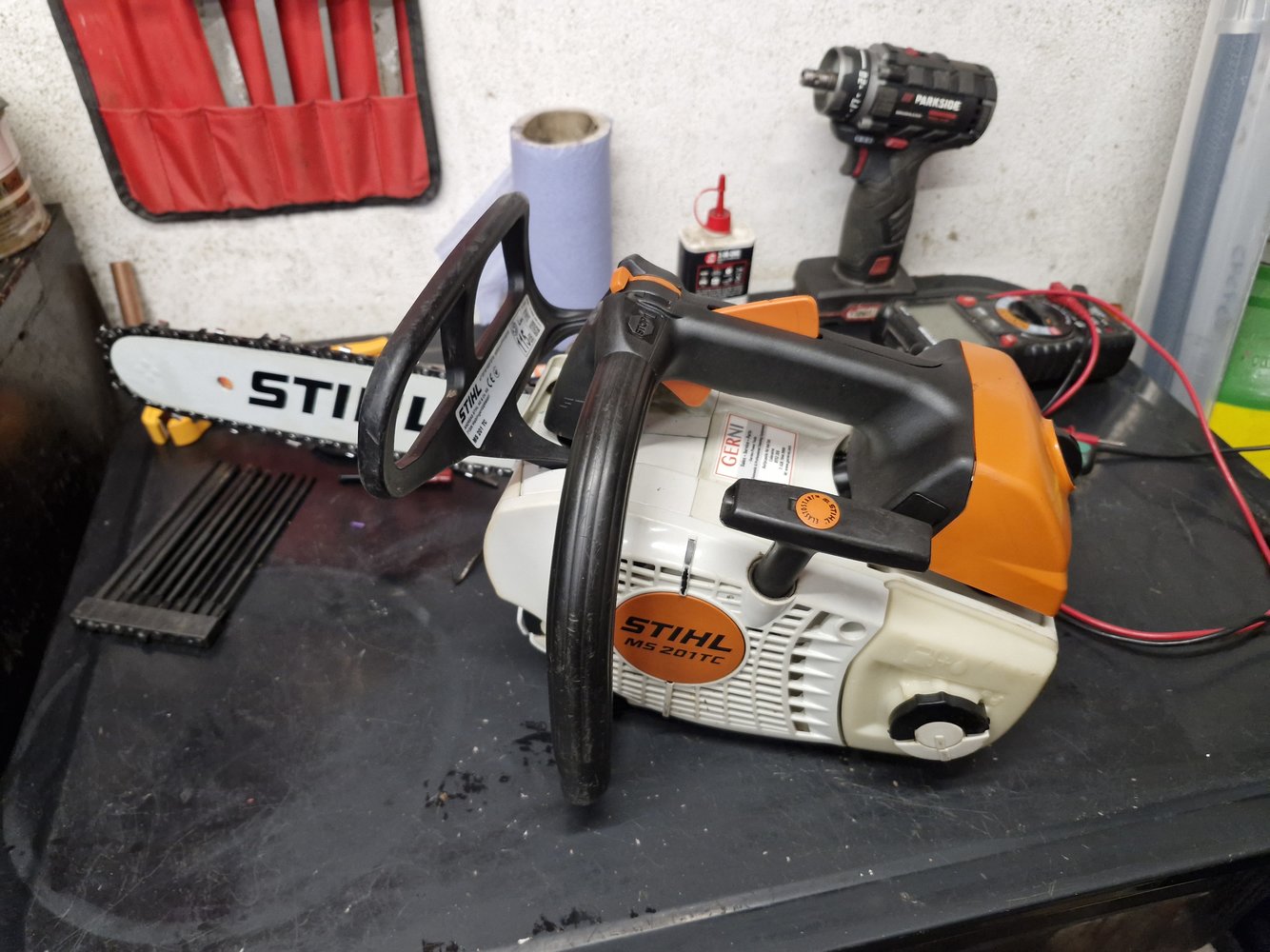

Another installment here. I sold my other MS201 and kept the newer mtronic one.

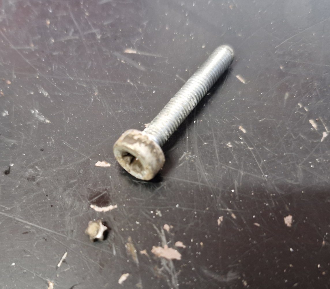

But it had started a squealing noise from the brake. I traced this to a broken part I'll call the "dogbone"!
Cleaned and reassembled
Then i remembered the saw Also doesn't turn off with the switch any more.
So on testing it, there was a break in a wire so I took the handle etc apart (bit of a puzzle on these) and installed a new wire.
Tested and working great again. Sharpened the chain so it's sitting ready for work next time I need it.
