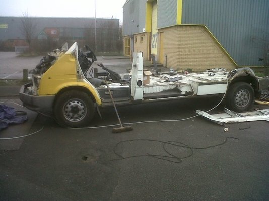

  7. Both sills finally done, not great but should pass MOT?
    Working on the chassis & rear x-member
    [​IMG]
    [​IMG]

  11. opps, silly me did not take any pictures of the welds, not to worry, plenty more welding to do will ensure I take pictures of the next welds before bodging, opps I mean tidying up.

  13. Hi Norn, thanks for the fingers crossed, gave the van the complete once over today & a little set back, I know should of done that a month ago, o well u live u learn, the hard way in my case,
    is that I need to buy heavy duty axle stands asap to complete the job, as need to remove both rear wheels, o/s needs chassis replacing like the n/s :o (hoping with the wheel off I may be able to plate it x 3) & n/s needs plate inserting inside wheel arch :o all extra work on top off rear corners & rear x-member & some minor plates inside.
    I also need 1000mm x 500mm 1.2mm sheet 2 finish the rear floor that I cannot get yet! :whistle: Anyone?
    The 2 cross-member templates were made today on my drive with the help of my blue pallet left over from an old delivery:laughing:, as well as the o/s inside rear corner, a different chassis plate & 2 plates to weld on the rear arch inside.
    I am 100% on track :laughing:
    Ron

  15. Just a few of the welds done over the weekend, it is so bloody hard to weld under a van, I did not know how flexible you had to be :o
    Going to tidy them all up Monday & then tackle the x-member & dreaded lower n/s corner :laughing:
    [​IMG]
    This corner one was not that bad
    [​IMG]
    This one was a nightmare
    [​IMG]

  17. Plated the x-member & n/s lower rear corner inside, :clapping:
    Lots of tidying to do :whistle:
    [​IMG]
    [​IMG]
    [​IMG]

    Decent enough fabrication, good pace of working but those welds look ummm... a bit iffy? Not sure I'd feel safe in a van that's had so much metal replaced where the welds were done to that standard.

    i cut a transit minibus up last year that was in better condition then yours as i couldnt be bothered to weld the bits up we did decorate it first with yellow line marking paint :laughing:

    I've got to say it: Even my old boss wouldn't have passed some of that welding, and he liked to hike the beggars through...
