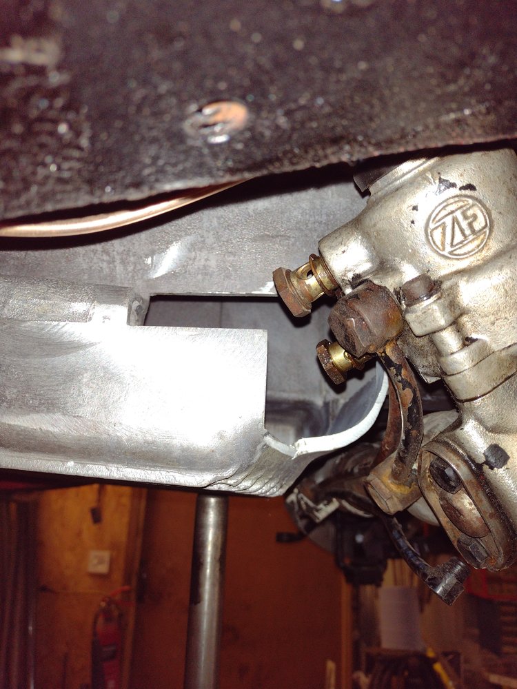

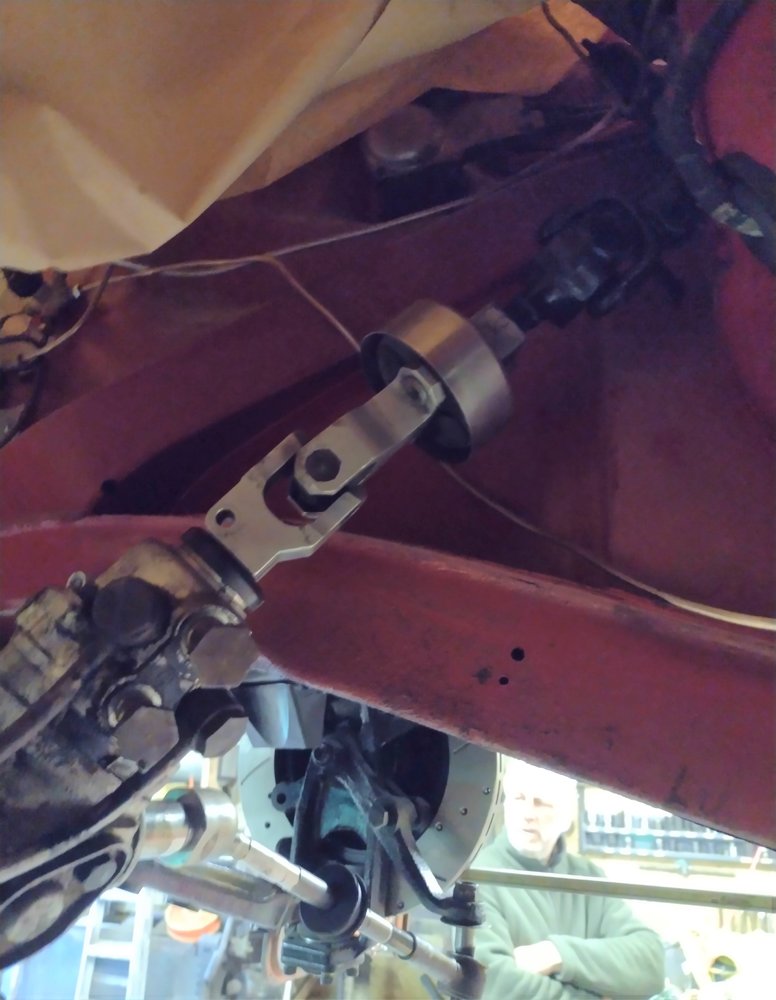

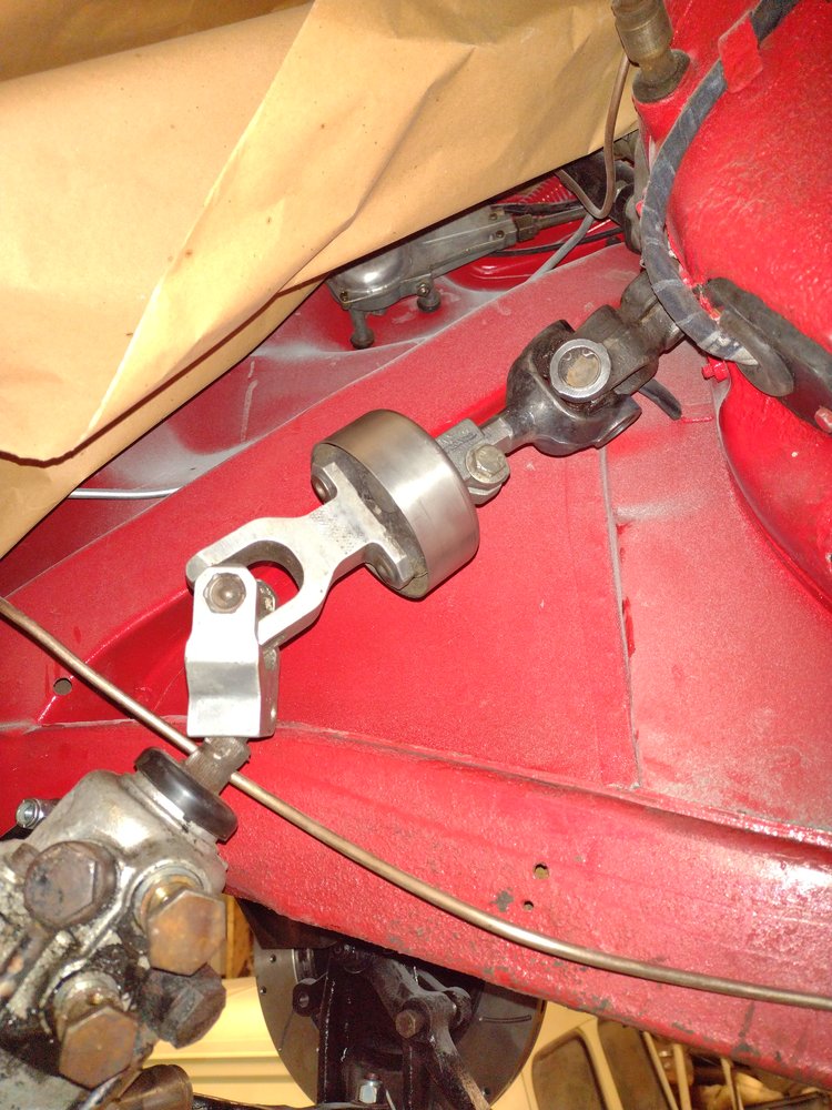

But I want a PAS rack, The BMW E21 pas rack could be shortened as it has a steel tube centre and alloy end castings but if I shorten it to Mk2 dimensions I would have the lock of a super tanker.............. I could have a short manual rack with an electric column but that would be modification upon modification, and I could use the original steering with an electric column but would be back to 5 turns lock to lock, or I could leave it std. but with wider tyres and castor alterations it would be even harder to park, my shoulders are knackered and my wife would not be happy to drive it.............. ho hum
Is the compromise to use the power steering box for the higher ratio and the electric column for the power assistance? Eliminates the pump and its attendant issues and gives the ability to adjust the level of assistance to your preference - or to that of the Ultimate Authority? Or even to make it switchable between 'mine' and 'hers'.
I'm unsure how complicated it would be to include the speed-related assistance feature for easy parking and comfortable weight on the move.
Or am I missing the whole point being to eliminate any steering box in favour of a rack and pinion?
Edit: I went from an unassisted S-type to a power-assisted 420. I found the 4.5 turns from lock to lock of the unassisted form mildly hilarious but can't say I noticed any problem with that 'on the move'. The wheel twirling in Tesco's carpark will occur so infrequently will it matter? The electric column with maximum assist makes it a one handed palm on the rim twirl anyway. Just imagine you are in California in 1965!
