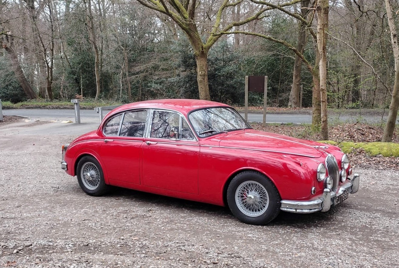

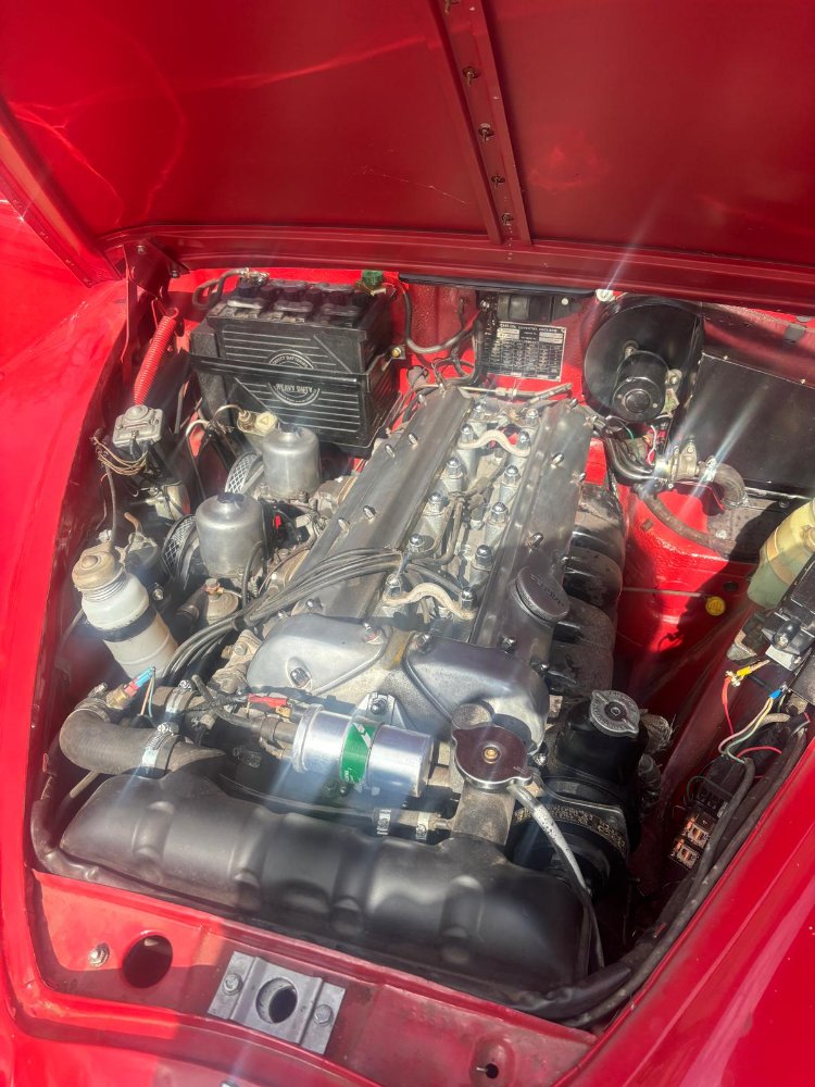

After spending a day getting the alternator off, it is trapped under the PAS pump, removed the engine mount bracket from the engine, and from the chassis, then got it tested, all OK, then spent a day refitting it, and then 10 mins sorting out the wiring muck up from when I converted it from positive earth dynamo to negative earth alternator we have charging...... and now a fresh MOT, lots of jobs still to do, and still waiting for a screen but I have been driving it around! with a full tank of petrol and two people inside it sits a little too low so I will be adding some spacers to the front springs and removing some spacers from the front of the rear springs.
