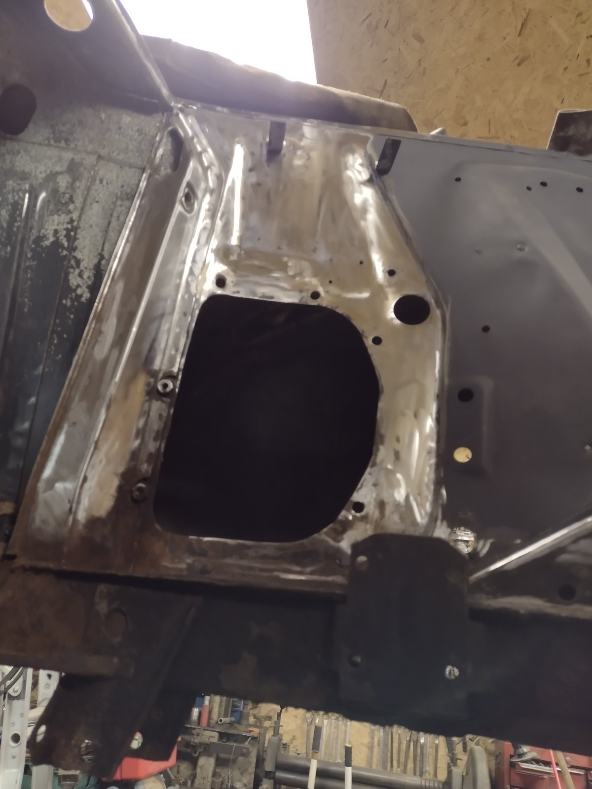

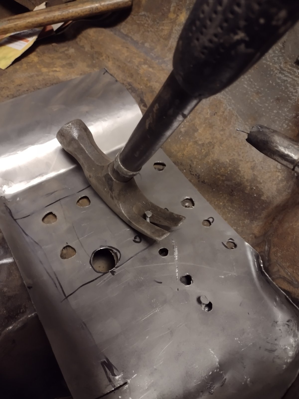

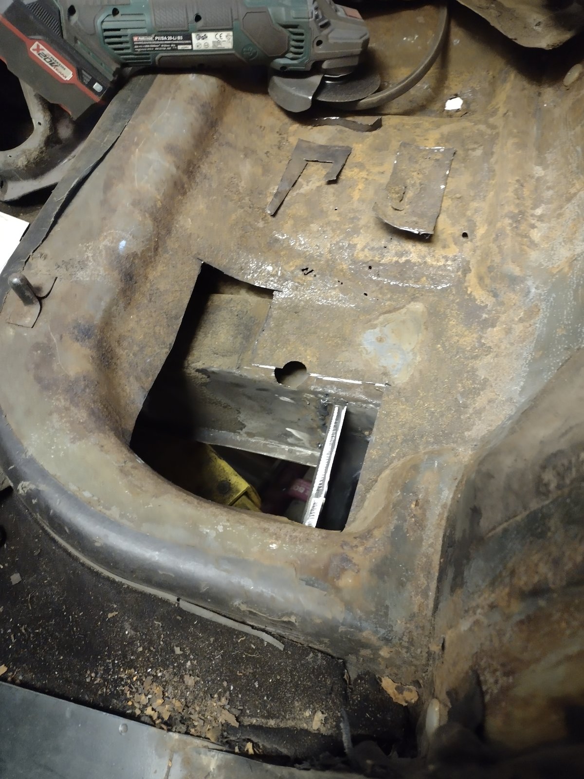

Last day of welding, just a patch on the rear valance where the tow bar went through, and finish the o/s/r seat pan but I cannot open that door far enough at the moment,

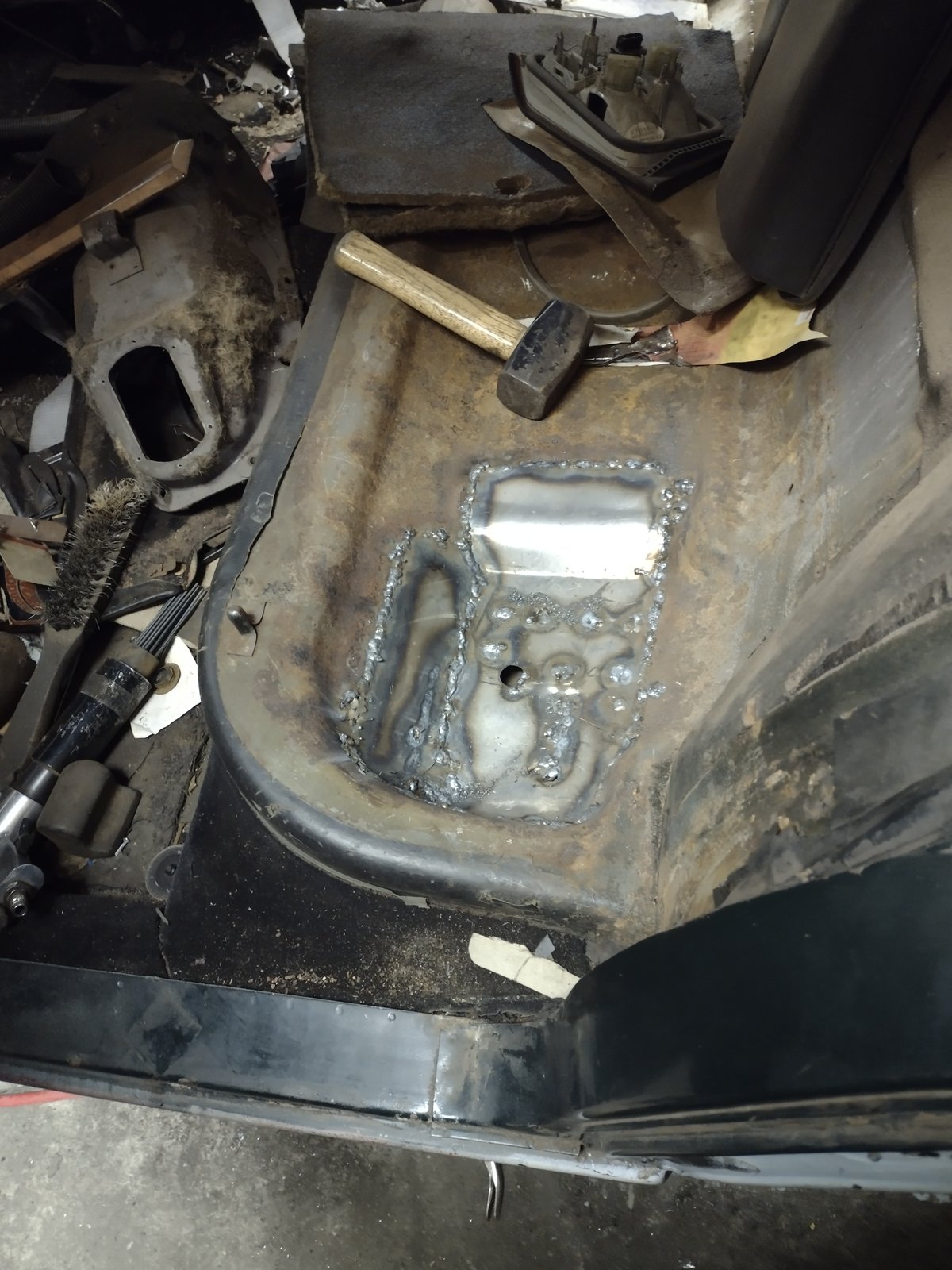

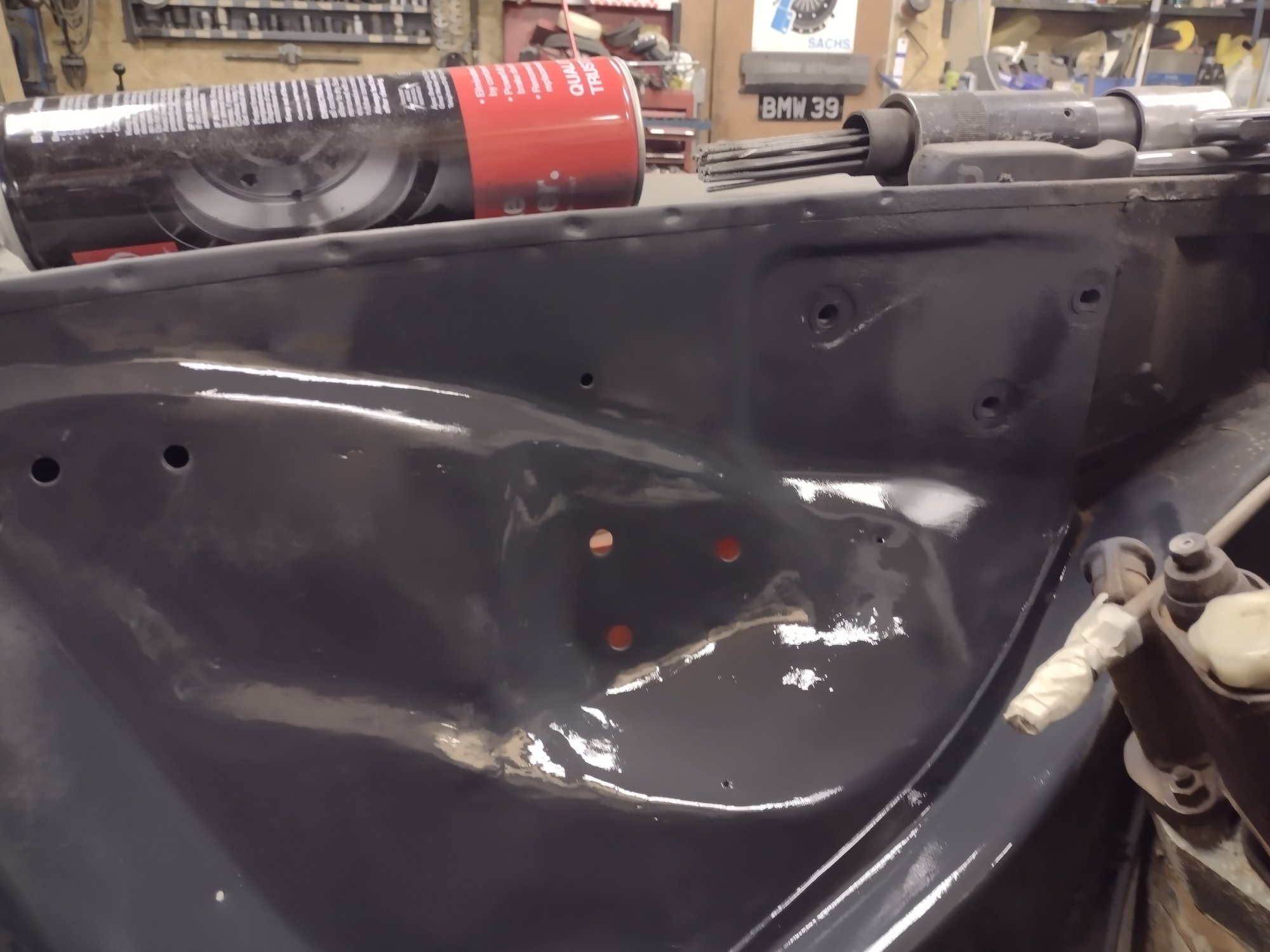

area under n/s of rear seat, foam seat base holds water! cut back to semi solid metal, at least 0.4mm thick! now pots of grinding to do!

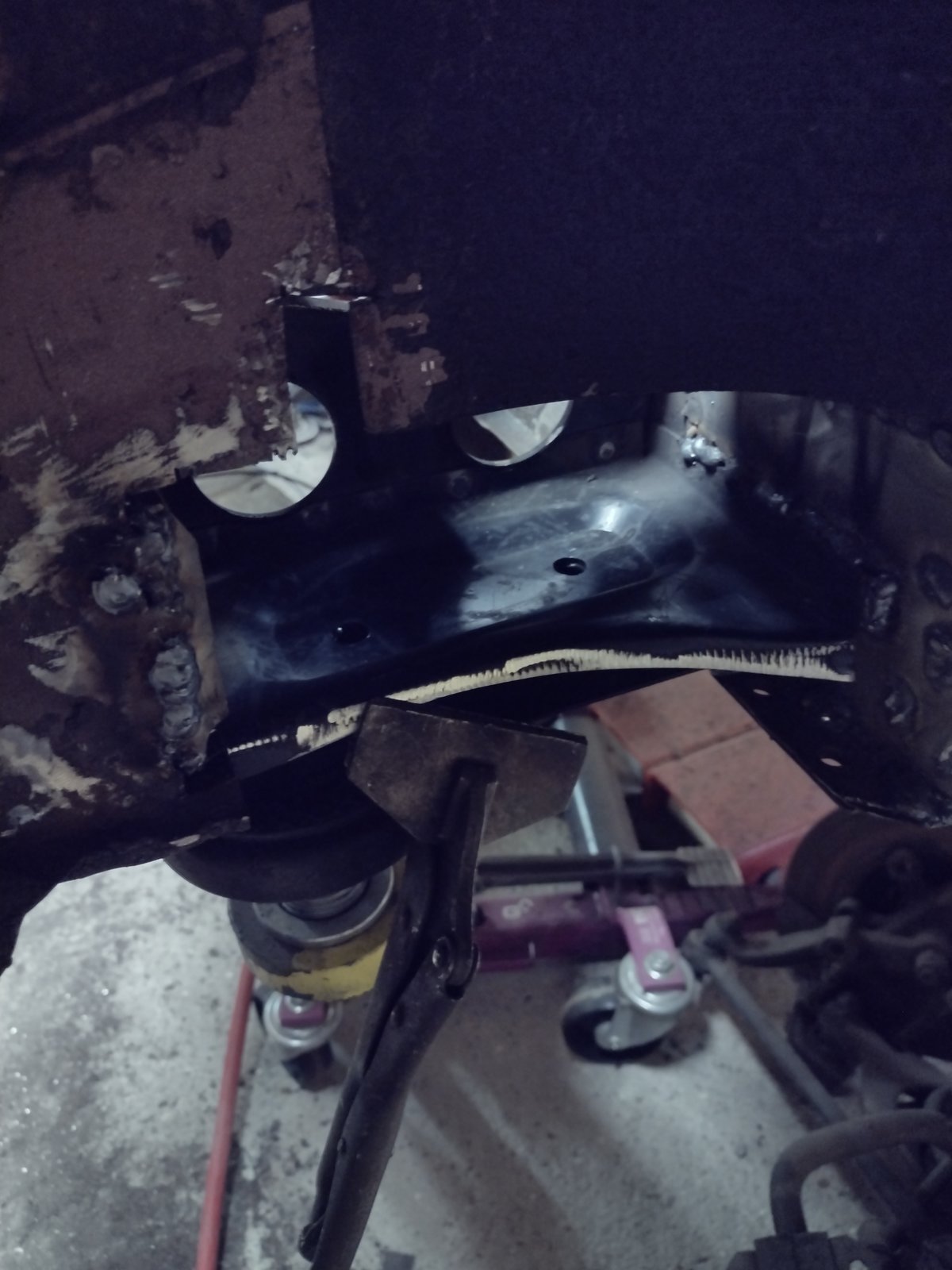

Note the nails, I welded them to the rear chassis rail before dropping the patch over, then use the claw hammer to pull the patch down, top tip?

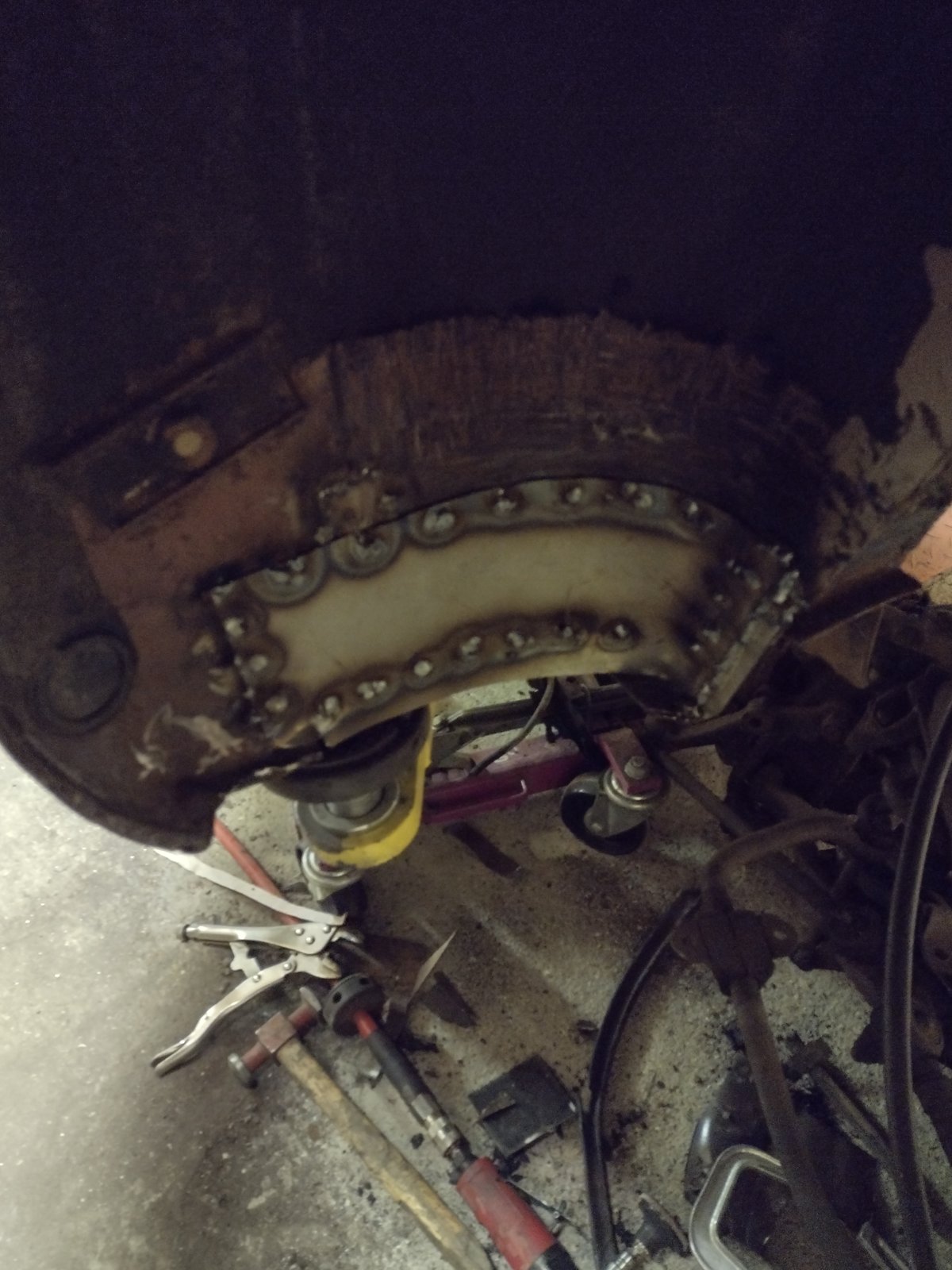

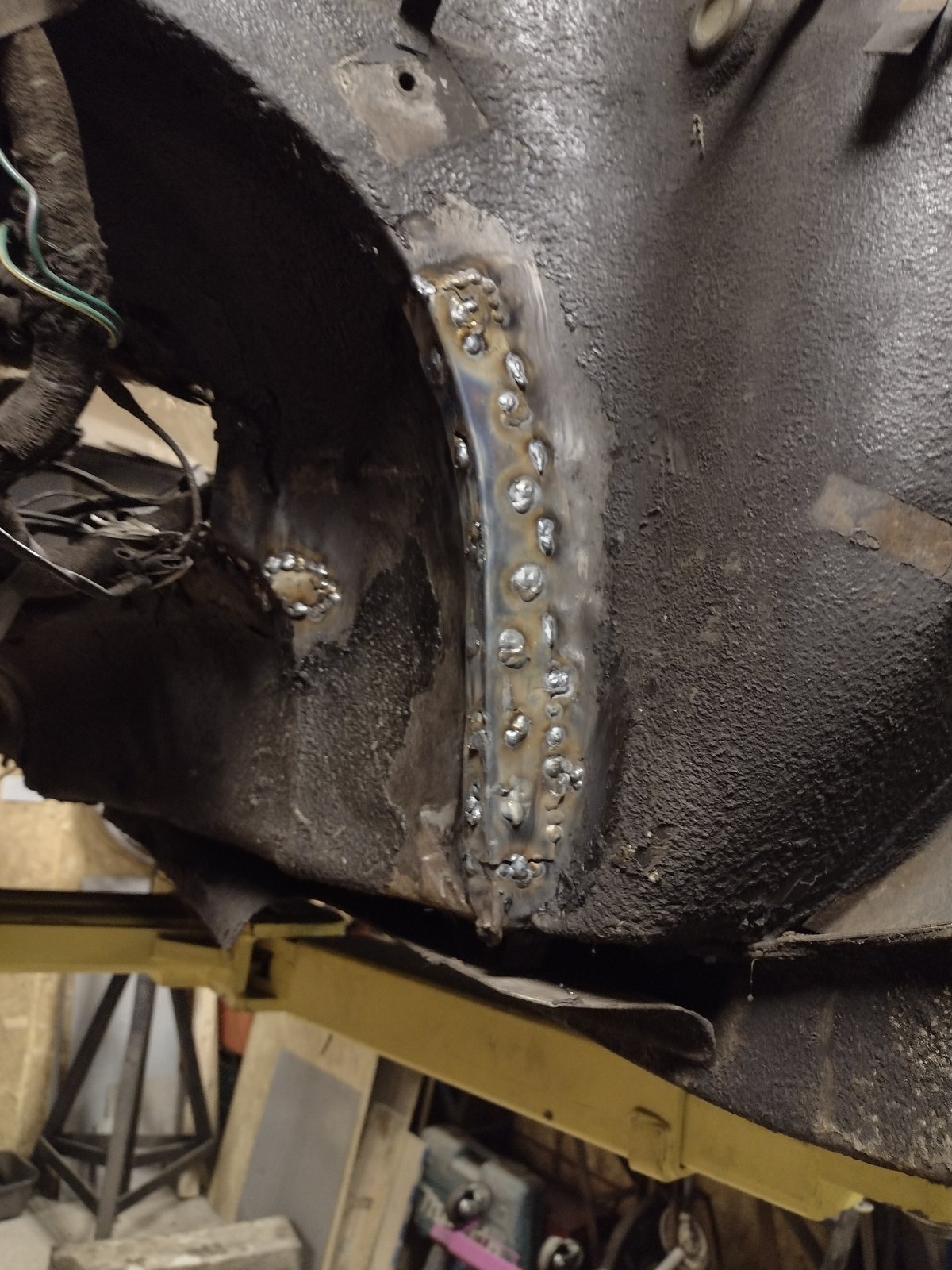

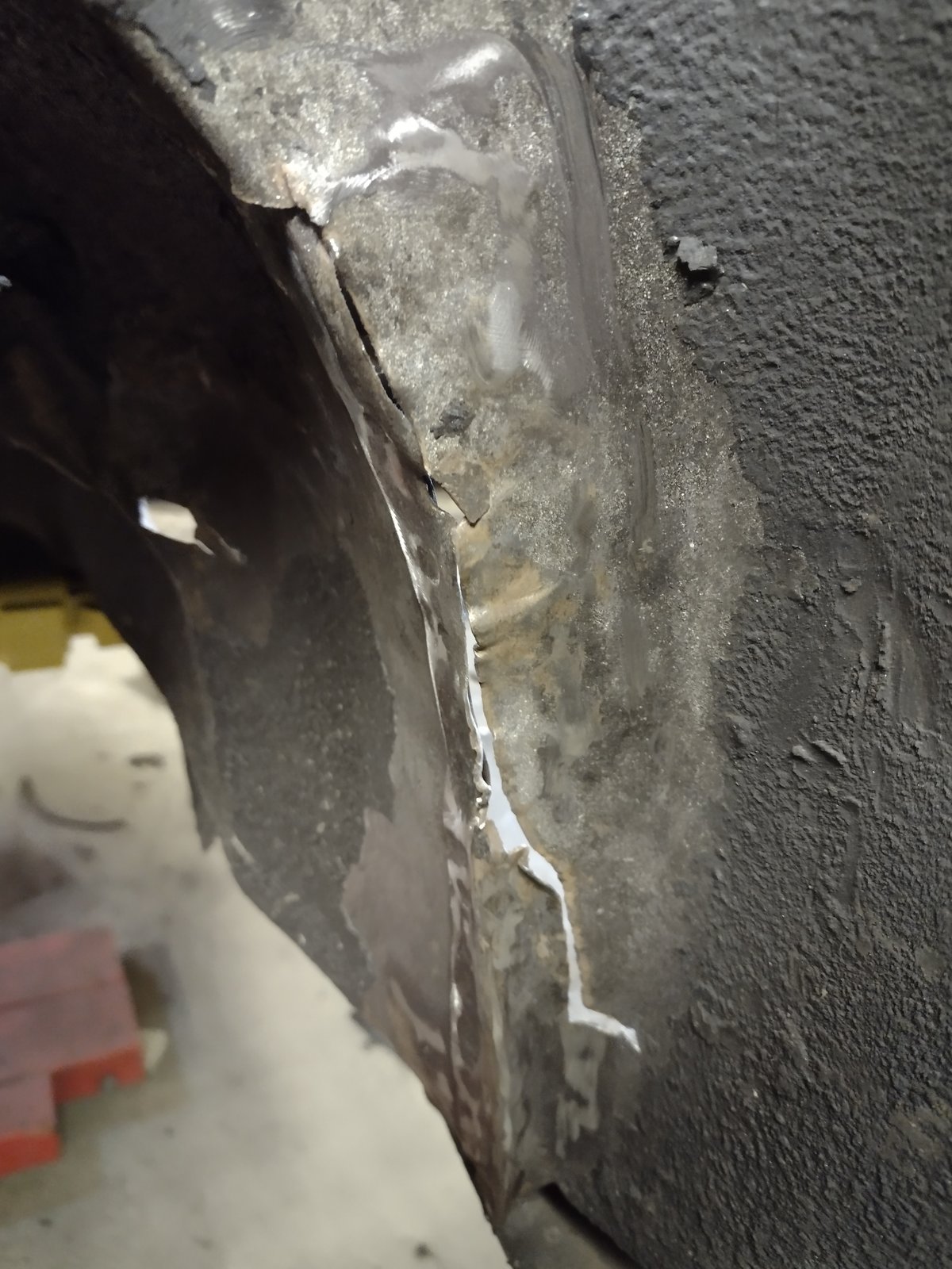

area in front of the n/s/r wheel, you can see the new jacking point.
Patched up, going to be on grinder all day tomorrow!
Seat base half done,
